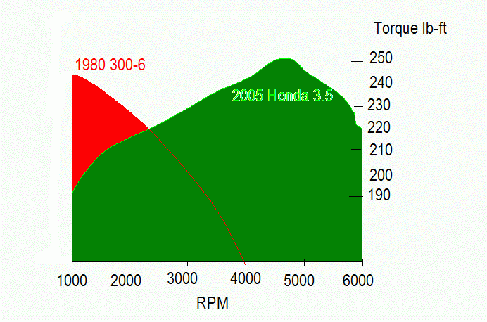

I spent way too much time on this but it does a decent job of showing the difference between these vehicles. The first graph shows the torque curves of the best low-rpm specs I could find for the 300-6 superimposed over the Honda 3.5 in the 2005 Pilot. I think it's what you'd expect from a modern 4-valve motor with variable valve timing, variable intake geomety and 90 less cubic inches--it gives up a chunk of low rpm torque and lays waste above 2500rpm.

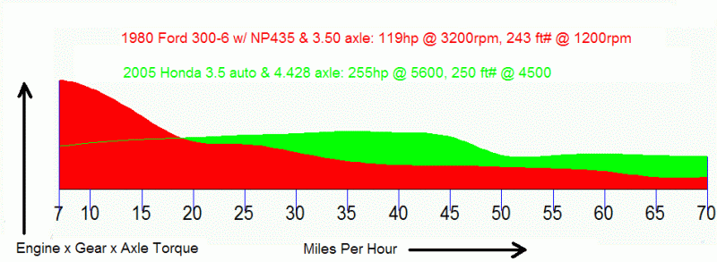

Now, you add the vehicle to the motor. The granny gear of the 300 would be somewhat offset by the torque converter of the auto, but I left it off because I don't know what the curve would look like. Nevermind, it doesn't matter in the end. What does matter is that a race above 20mph, doesn't matter the weight, the Honda will easily win. The Honda will get any load moving--with the converter it will have 4,400ft# of torque at a dead stop with the pedal to the floor compared to 5,700ft# for the Ford as most converters give a 2:1 torque multiplication at stall. Then the Ford will pull away until it reaches about 20mph, and the Honda will be coming for it after that. I can't put a time function on a 2D graph like this, but it wouldn't be long before the Honda went by. And with a 2.73 ratio in the axle or in a truck without the granny gear it would be even less of a race.
In this graph, whoever has the most torque at a given mph has a greater acceleration at that mph. The Ford is the clear winner below 20mph, above 20mph, the Honda will pass it up. the baseline is ZERO foot lbs, so the Ford truck has twice the torque at the wheels for a bit (not accounting for the TC of course) and the Honda has twice for a lot. And what is also interesting to note--the Honda doesn't shift into second until 48mph--which says a lot for its powerband.

I attached a doc from my spreadsheet.
No Honda did not design this to tow heavy stuff anyore than an Explorer is meant to. But with a HD tranny behind it it would do fine in a grain truck. If you look at where you shift, the little chip of rpm doesn't mean much. At 2500rpm where you might cruise down the road, the 3.5 makes more torque than the 300-6. And accelerating hard, it has such a long powerband it will never fall down below 3800 anyway--which is why I attached that doc so you could see the shift revovery points.
