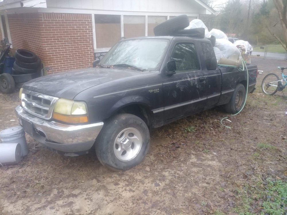

Okay guys, as the title says I'm working on a 1999 2wd 4.0l ohv Ranger (W/Bad Transmission) I stole at $300. I originally got it for the clean 4.0l ohv engine that had low miles on it to swap into my 1996 Explorer xlt 4x4 when my serpentine belt broke and overheated the 4.0l OHV engine with 240,000 miles on it, a previously blown head gasket as well as a shitty pitted intake. I don't have any clue about how much damage was done but the engine has done it's duty and will be scrapped after it's stripped of accessories and sensors.
I have searched all around for info on what I could swap (Transmission, transfer case, front suspension 4x4 wise) from my Explorer to the Ranger(Basically trying to make the Ranger 4x4 or atleast salvage whatever 4x4 elements that will swap). I was looking at the front end and suspension and they look like they are the same dimensions except the Explorer's is bulkier and looks way stronger. I have already made the decision to swap the 31 spline 8.8 rear end regardless of the 4x4 interchangeability and pretty much believe I can handle moving the shock mount on it to make it work. I have looked all over the internet to see if my recently rebuilt "96 4-speed auto transmission & transfer case would work if I swapped the ECU, GEM, harness, or whatever else would be required. I've pretty much almost abandoned hope. I want either my 4-speed auto or a 5-speed manual mazda M5OD? The 5-speed 5r55e Ranger transmission is trash in my opinion and I'd scrap both vehicles before I'd consider wasting my time and money on the purchase and installation. I'm swapping my buckets into the Ranger as well as alot of the dash pieces(specifically the dash bezel because of the 4x4 selector switch) stripping the engine of accessories, sensors (called autozone and cross referenced part numbers ✔) If anyone has any valuable information on how to make the 4-speed transmission swap happen or required modifications to swap the front end out I'd really appreciate it.

Btw this is my first attempt at a swap or project like this. I'm not a professional mechanic. I know what I have learned through hands on experience, auto repair manuals, google and YouTube. I just love the feeling when you made something awesome out of something broken or otherwise without purpose.
The 5R55E never gave us any problems, I don't recall us having to do anything more major than a valve body gasket. There's a servo bore repair out there but we never had to do one. By the way, the difference between the 5R55 and the prior 4 speed auto is all in the programming of the PCM and not in mechanical parts. They evolved from the not-too-durable A4LD which had it's roots in the Pinto C3.
Your love affair with the 4R transmission and apparent utter hatred of the 5R trans is confusing to me, since at Walt said, they are the exact same transmission.
The frame on that Ranger is wrong for 4x4 and it won't accept a front axle. The suspension bracketry is different, the mounts for the front axle and the torsion bars used in a 4x4 are not there, and the axle shafts would go through the coil springs that are there. You almost need to take the entire front portion of the Explorer frame, or so a solid axle under the front of the Ranger to make 4x4 happen.
If that Ranger is already an auto you should be able to throw the Explorer trans in and go, I think they are the same unit.
