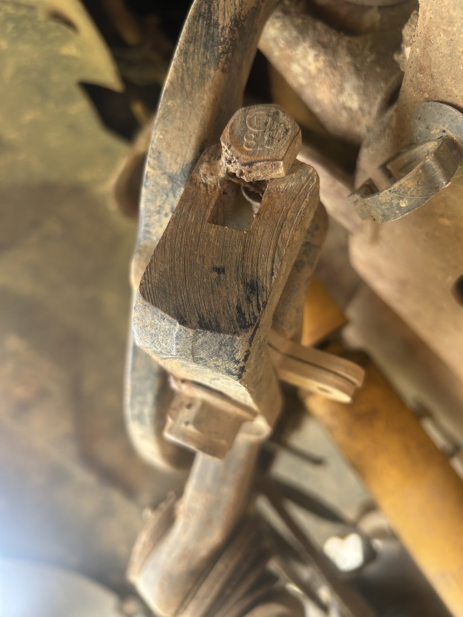

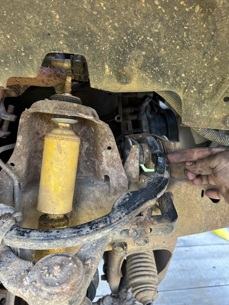

I recently bought a 1999 ford ranger 4x4 no coil springs. The passenger side has the 2 piece upper control arm. My tire is severely leaned in at the top so I took the wheel off to look around and found that someone had inserted close to a half of and inch worth of shims between the 2 pieces that make up the upper control arm. I guess they were trying to correct the wheel lean. As best I can tell the frame is straight and the 2 mounts for the upper control arm are in good shape so the only thing I can think of is the control arm must be bent. I’m inserting a picture that will show what it looks like and where I think it’s bent. If anyone can help me out I’d appreciate it.

I really cant tell anything in the pictures myself. Might give it a good cleaning and look for and flaked off paint. Most alighment shops will look at it and tell you what is needing fixed from my experience. Fix it and then have them alighn it.
I concur. It is also possible that someone installed the incorrect part. Some Rangers had the two piece upper control arm and some didn't. Try to find out if the correct part was installed and, if it is, what is wrong that someone tried to improperly fix it. If it isn't, get the correct part installed. Either way, it's going to need an alignment.
The 2 piece upper a-arm was to allow caster adjustment. The Ford decided that the frame mounts were close enough and they could save some money with a 1 piece. So, that isn't the issue.
The pictures don't give us the whole story, we need a couple more (and ideally a couple measurements).

from the pic it appears the camber adjustment is turned all the way out. add that to the washers and you have a serious mis-match or bent part somewhere.
those 2 piece upper arms are long obsolete, everybody replaces them with a 1 piece upper arm.
FYI, the upper arms are different between coil & torsion bar suspensions. they both bolt to the frame but the geometry & top hole are different.
From everything I could tell by prying around with my pry bar I don’t believe I have any bad ball joints. I do know the truck has been wrecked but past that I don’t know anything else. The frame doesn’t have any obvious ripples but I’m not saying it’s not bent either. The wheel bearing also seems to be in good shape. I’m thinking my best option at this point is to just order a new one piece upper control arm and hope for the best. I’m at work now I can try to get some more pictures this evening if that will help.
