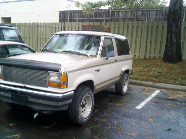

ok i have a 92 xplo and a 89 b2. my plans for these are to be dd's and have fun on the weekends so here is my plan so far;
B2
5in james duff(or 8 in skyjacker) 3 in body
4.0 swap with 5 speed all from a expo
headers with dual flowmasters with no cats
tbb35 swap with 44 knuckles with 4.56's
8.8 rear with 4.56's
painted black with 15" mickey thompson classic locks and 37" x 12.50 cooper discovery stt's
Explo
8in skyjaker and 3 in body but was thinking the 5 james duff would be allot better
rebuilt and performance a4ld with better converter
tbb35 with 44 knuckle with 4.56's
SOA swap in rear with 8.8 and 4.56's
36x14.50 mickey thompson baja claws radials
not sure on rims yet
