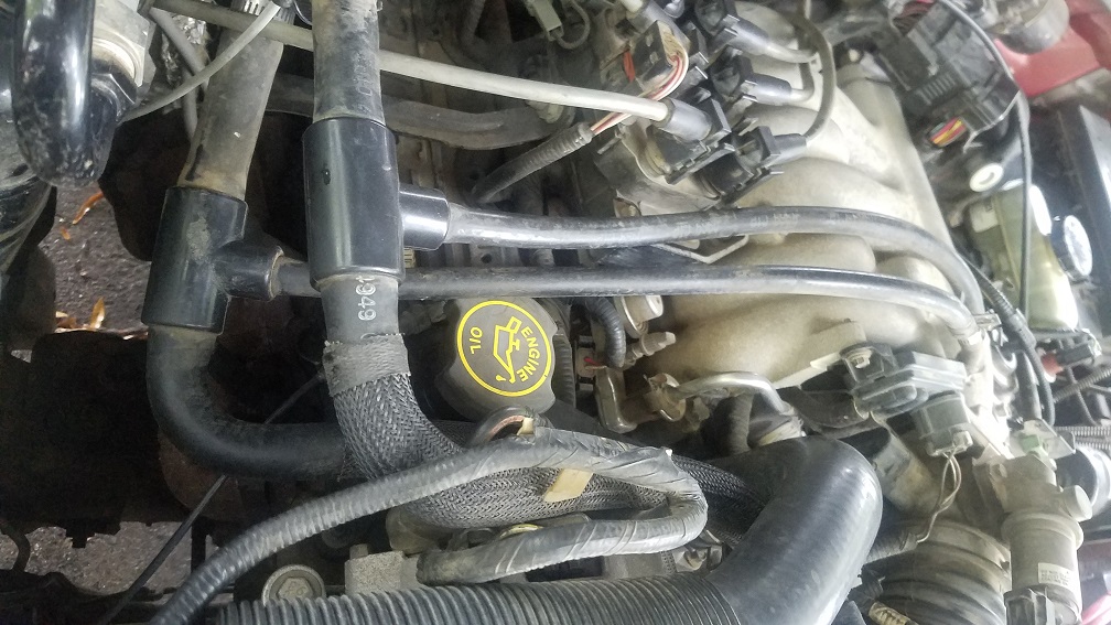

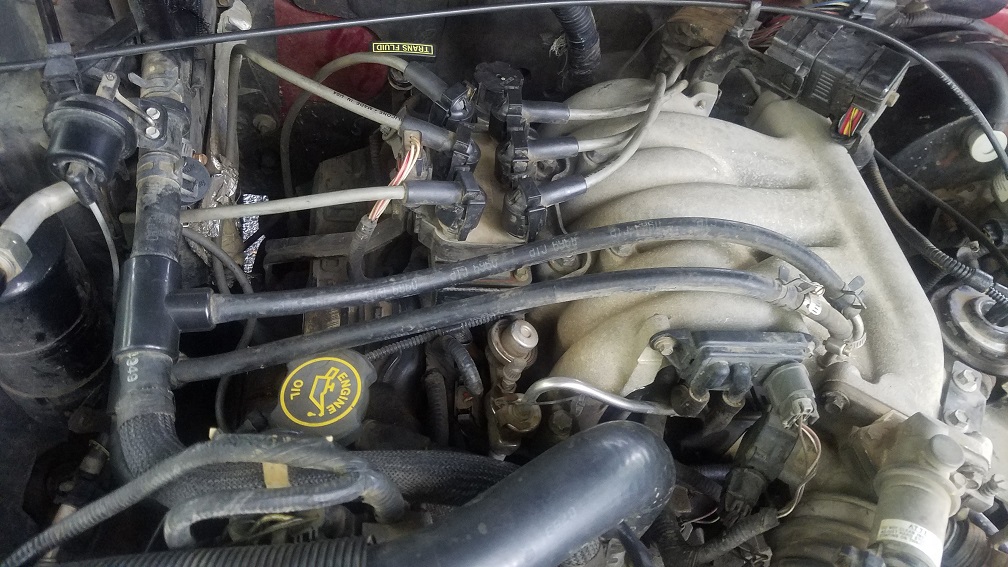

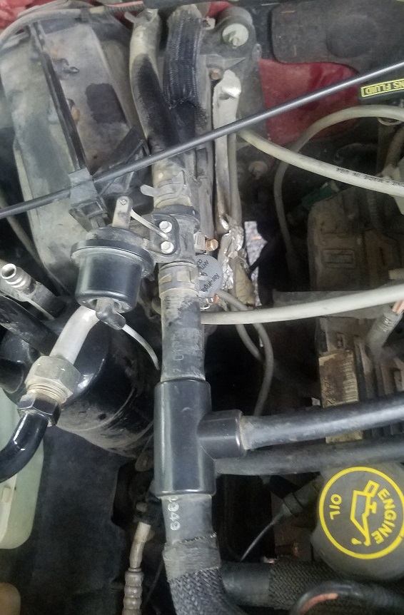

Sure, I'll try to get one this evening. I'm honestly not sure what's on mine off the top of my head.
Updated my signature to clarify that.
Hope this helps. Glad to take more as needed.
