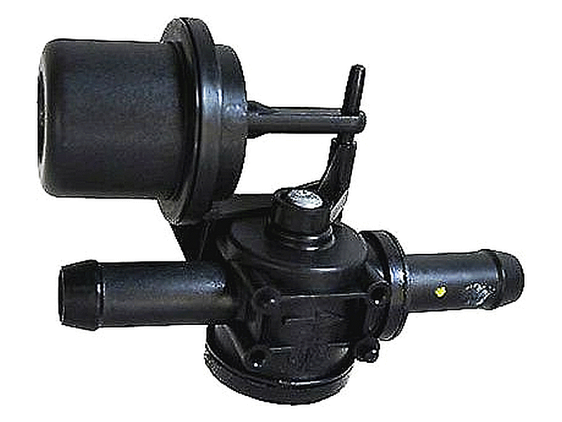

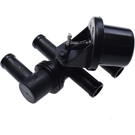

Which HeaterValve is on this 2001 4.0L: 4wayHeaterValve or 2wayHeaterValve?
2way is usually factory mounted under Alternator in HeaterCore return line to Pump.
