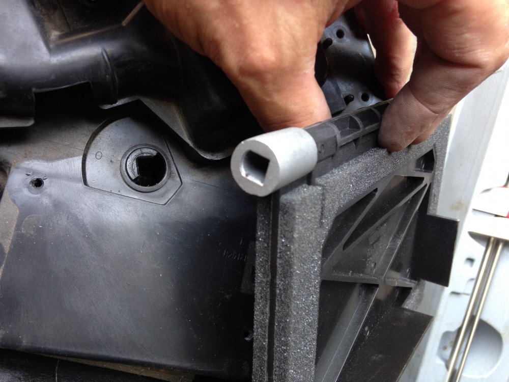

Here is a photo of how the blend door breaks. The old one is on the left, replacement one on the right (replacements are made of metal where it connects with the actuator to keep from breaking). The actuator operates the blend door by turning a post that fits into that 'D'-shaped opening. This photo was taken with the heater box removed from the truck (a multi-hour project as it requires removal of the entire dash, steering column, etc.,) and the actuator removed from the top of the heater box. Apparently, blend door failures like this are common. The symptom is that you lose the ability to switch from cold to warm air (and vice-versa) in your climate control system. In my case, the blend door got stuck in the cold air position.
