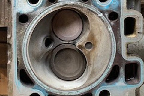

Again. . . Fel-Pro! This is what happened when my SOHC overheated:
All six cylinders!
