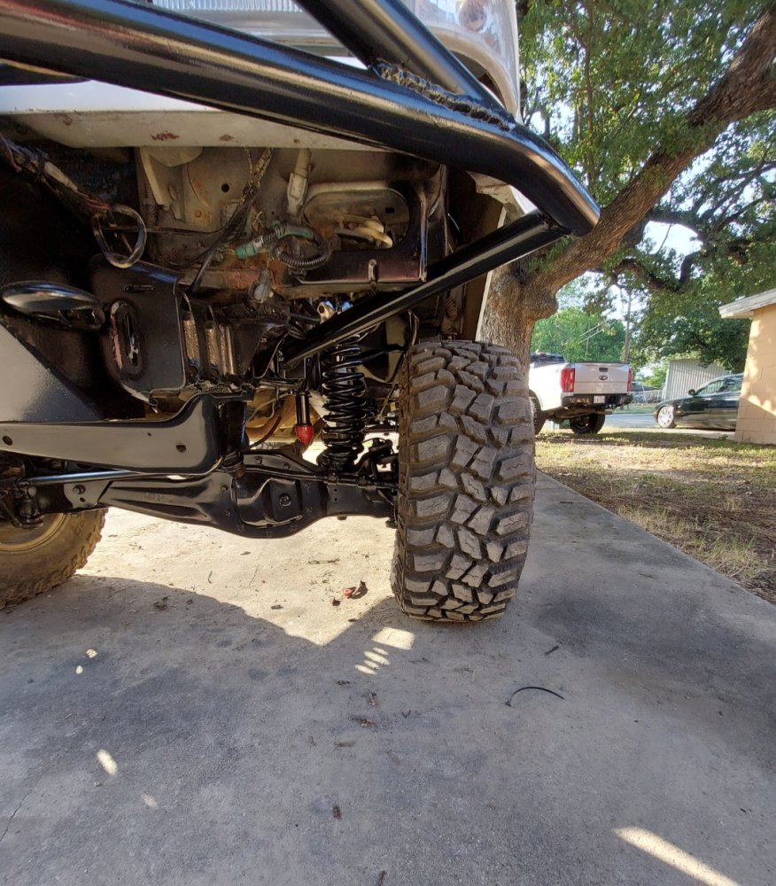

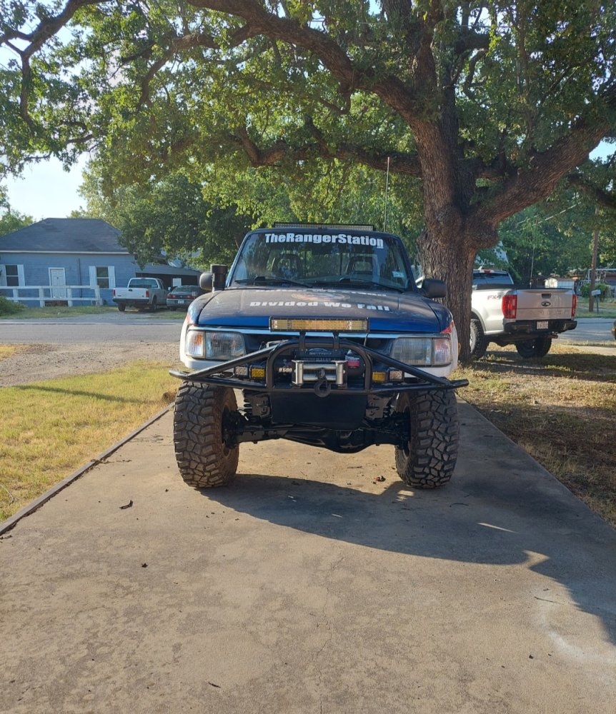

I'm having an alignment issue. When I pull forward the top of the tires pull in.
And when I back up the top of the tires push out and they straighten up.
I haven't dealt with this in a long time, but I think it's a toe issue.

Wow, that messed up. It’s not an adjustment, something is shifting around. I don’t know anything about your rig or how it’s modified but I would look see if the beams are moving back and forth. Radius arms? If beams aren’t moving is the steering box and pitman arm secure? Any strange noised when you move back and forth.
There may be some things wearing out. But toe adjustment affects that more than you think. Caster plays a role, also.
On a solid foundation toe will not change from switching direction of travel. Movement like he is getting isn’t gonna be a toe issue. Not that his toe won’t be off but it should remain static regardless of direction of travel. Adjusting it without stability in the equipment will be futile.
I agree that ball joints and tie rod ends need to be in good condition. But toe in or out puts forces on the system that will try to make the camber look worse.

Yes. He may have worn ball joints. He will be able to inspect the them when he checks the toe. He may even make some camber adjustments. Will it be perfect? No. But making the proper adjustments will minimize the stresses and it will be ok for what he needs right this minute. Remember. This is a TTB truck. It does odd things and is fine. If it were an SLA suspension with that much movement in camber, it would be time to panic. A TTB truck can look like this just from lifting it with a jack and putting it back down. Especially if you lift it from the frame and let the suspension droop. When you drive it, it settles out.

This is an inherent problem with a lifted TTB system. It is well known that toe adjustments will not get rid of the problem 100%, but it will make it better.
Hard to tell by the pics but are the top ball joint pinch bolts tight? Looks like the top of the knuckle has moved in/out to me.
That would be something to check. But they're probably tight.
