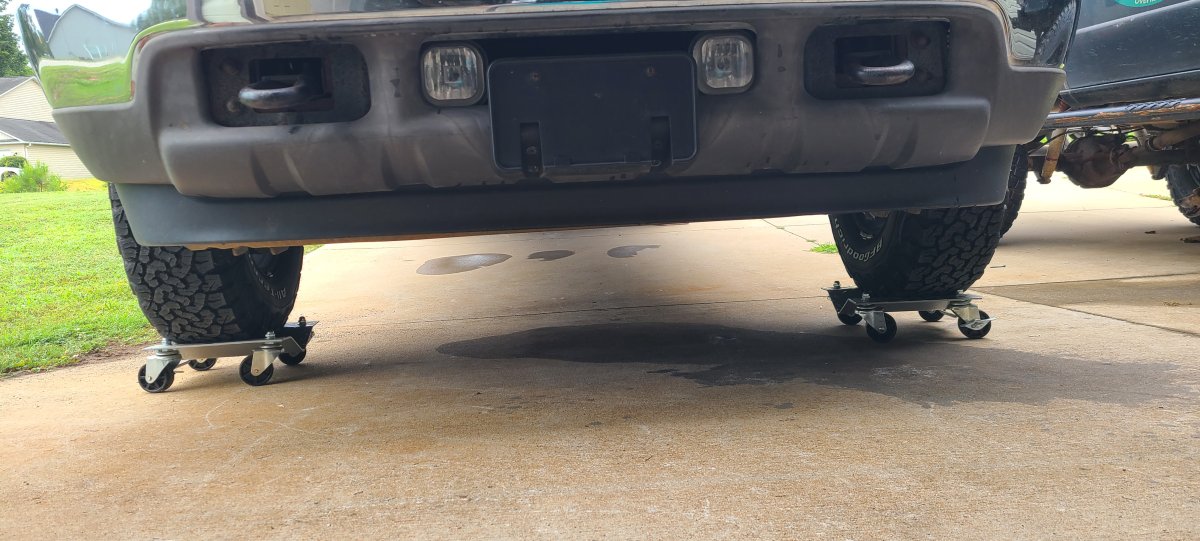

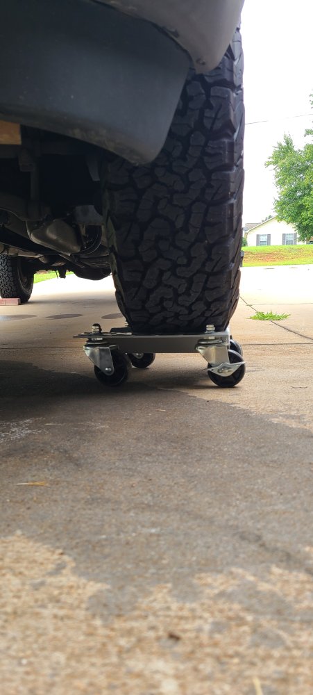

Here is what I was talking about when I mentioned using the skates under the wheels during a DIY alignment. Now, things can move while I make adjustments. I can also bounce the front end up and down to help things settle in after an adjustment. When I feel like its6dialed in pretty good, then I'll drive the truck around d the block and come back for a final check on my measurements.
Preliminary checks are showing a full 1" of Toe in on this truck. Don't know when it was last aligned before I bought it, or by whom. But that's pretty bad.
