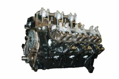

I found a supplier for a long block with hypereutectic pistons,Moly Rings,Brass Freeze ,RV Camshaft,12 HP Valve Springs (RECOMMENDED for use with RV Camshafts),ZDDP Additive,and heavy duty heads. I'm not sure what stock comes with but if that's the strength of stock building a 2.9 just got a lot easier.
