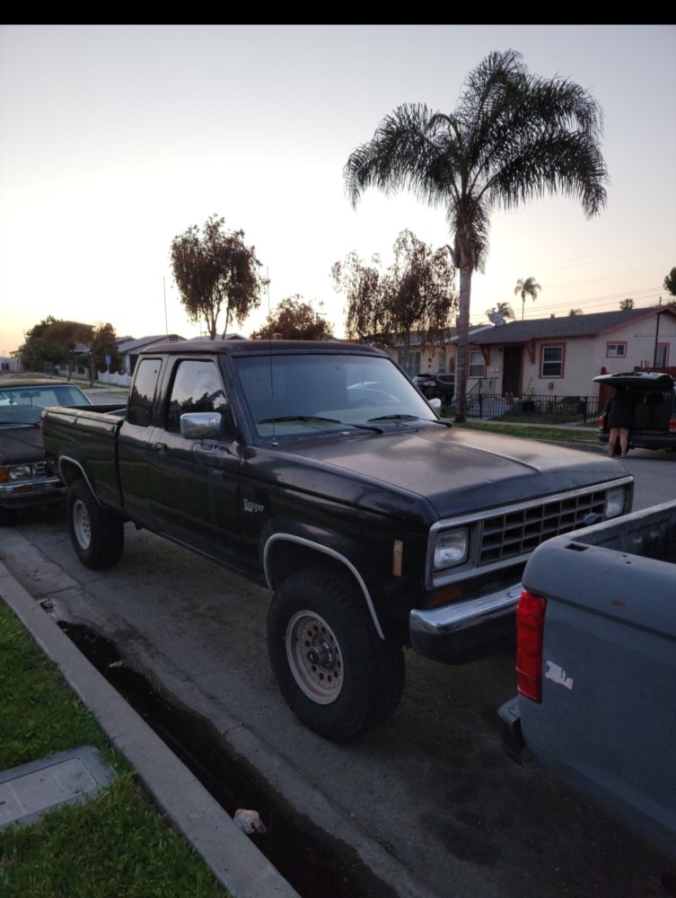

Hello again, I'm actually posting this for my buddy who just bought a 1988 Ford Ranger Extended Cab 2.9' 4x4 Auto. We picked it up for 3000$ and it's a really nice looking truck. It needs a little bit of work. It was owned by a old gentlemen who owned it for over 10 years. The truck had a rebuilt motor in 2012, had the paperwork proving it. It's just been sitting for a while.
Hard to start but runs great.
The main issue is that it's hard to start and to keep running. You have to hold the pedal down for about 5-10 seconds before it'll catch and stay running. After it's up and going, it idles and runs like a dream. We've replaced the ignition coil. The ICM is working fine, we had tried replacing it with a Durashit brand ICM and it actually caused the truck to run even worse. We stuck the Motorcraft back in and it returned to normal.
It has a new fuel pump in it along with a pig tail. I'm suspecting it's something fuel related like the fuel pressure regulator, injectors, fuel rail, or just the system in general. We put a can of sea foam through it and she ran a lot better. Drove it two hours from LA to his place in San Diego and it never shut off or broke down. My little 2.3L, 4x4, '4 Speed that I own myself could barely keep up with it lol.
Anyone got any ideas of what it could be?
