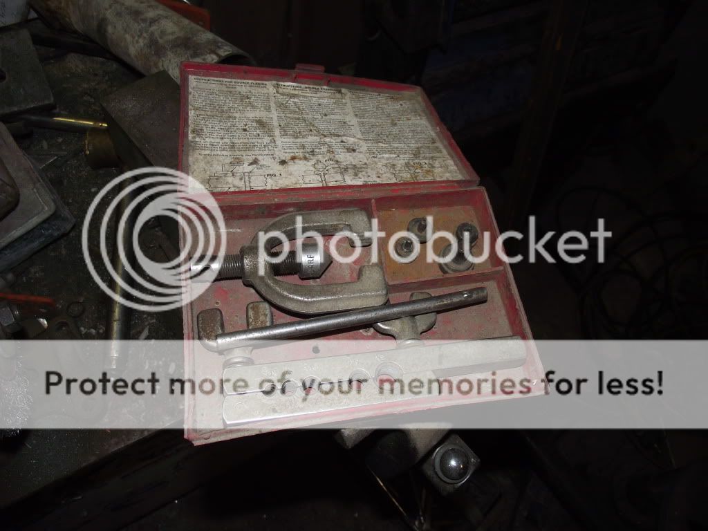

A little off-topic, but Gwaii, what type/brand of flaring tool do you use for brakelines? I've tried everything short of snapon and matco with less than pitiful results...:annoyed: maybe its the cheap $25 roll of brakeline I purchased? :icon_confused:
Gt-12
i'm not even sure what brand this one is,the label's been gone from the box for about 15 years now....but i can tell you it was not an expensive one.i think it may be KD.
i remember it took a while to get the knack for forming good double flares,and several of the people i tought to do it had similar troubles at first,but once you get it down pat,it's like riding a bike.

Im pretty sure some of my problem is "user error", but then again I have to first find a tool where the little "dies" will quit bending:D

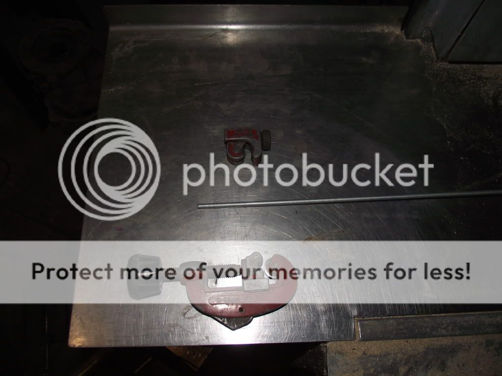

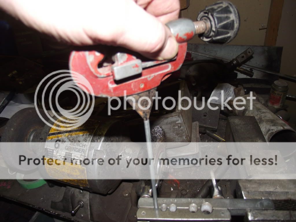

the first important step is getting a perfectly square cut.always use a tubing cutter,hacksaws and zipcuts will not do.the bigger one in the foreground is a very handy tool,the smaller one in the back is for tight spaces,like when you have to do a brakeline on the vehicle(not a nice way to do it,i don't recommend it unless theres no other way)
Gt-12
the cutter has this reamer in the handle to open out the cut end.

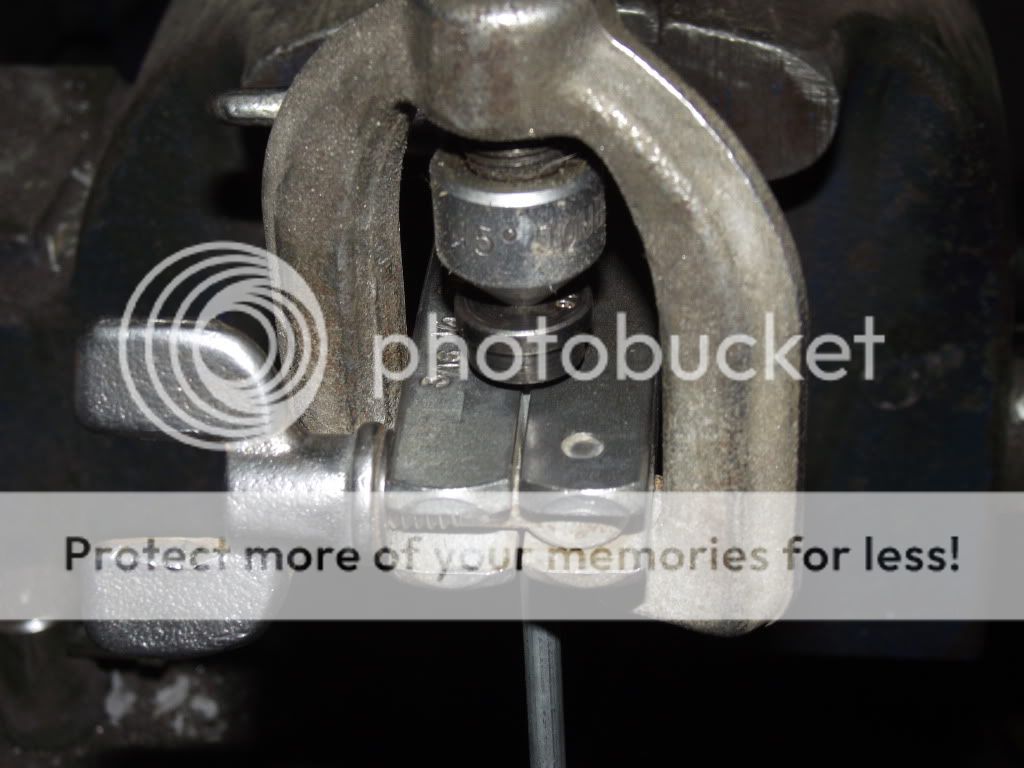

the pin on the upper die should slide easilly into the tube and sit square.if it's tight,more reaming is needed.

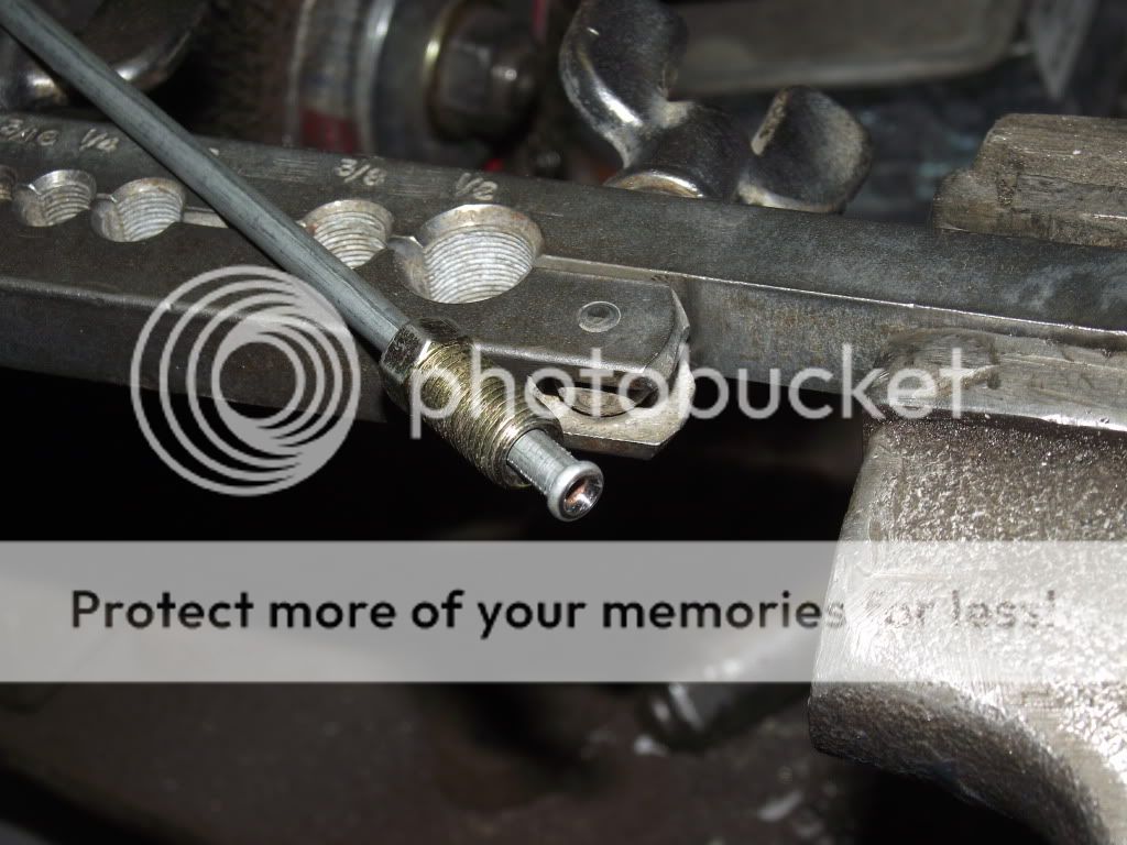

now,slide on the fitting.i don't know how many times i've forgotten this step and had to cut off a freshly formed flare to put it on.

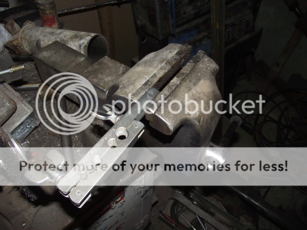

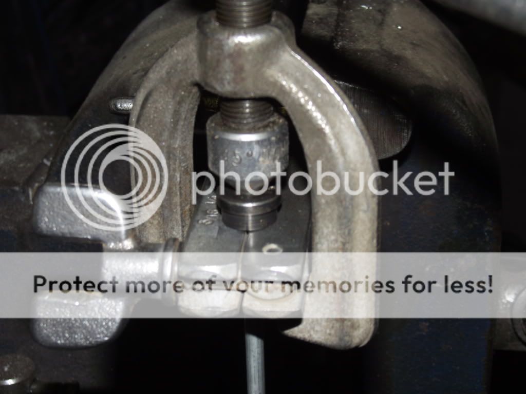

whenever possible,use a vice to hold the clamp.this will make life a lot easier.
Gt-12

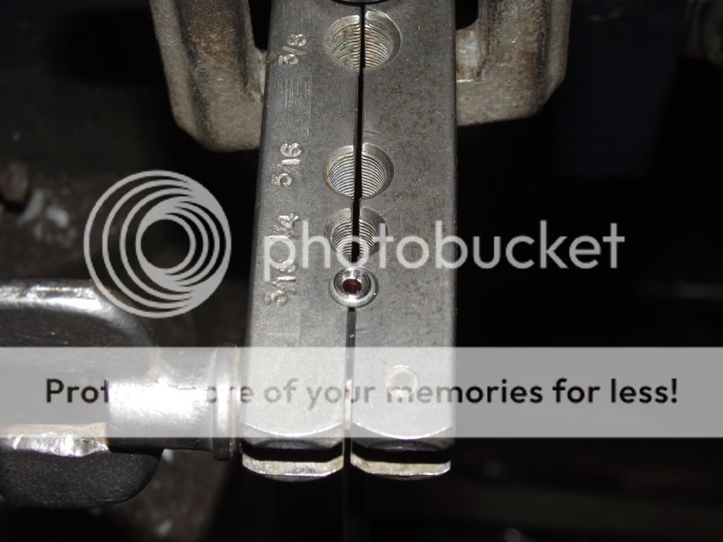

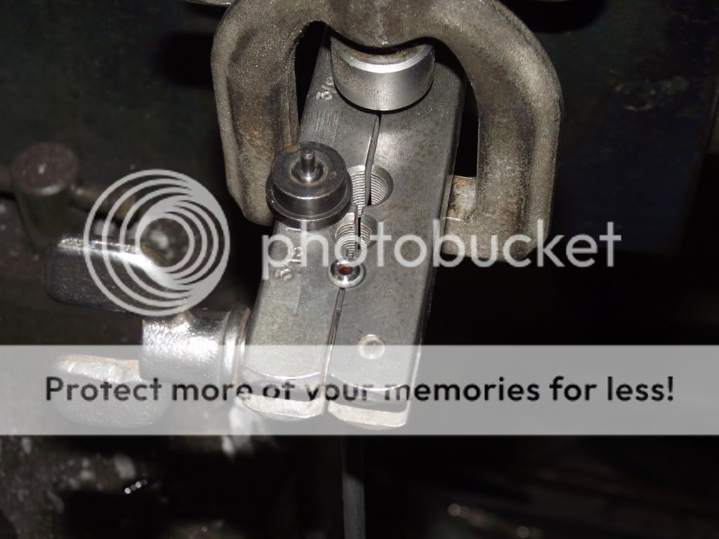

the dies have this little step on them....it's not there just for looks,it's to measure exactly how far the tube needs to project from the clamp.not approximately-exactly.
Gt-12
make sure the clamp is tight-both ends.set the die in place,and the press on top.twist the press frame clockwise on the clamp so it can't move when turned.look close at the die to make sure it's perfectly parallel to the clamp face.if it's not,slide the press to correct it.
Gt-12

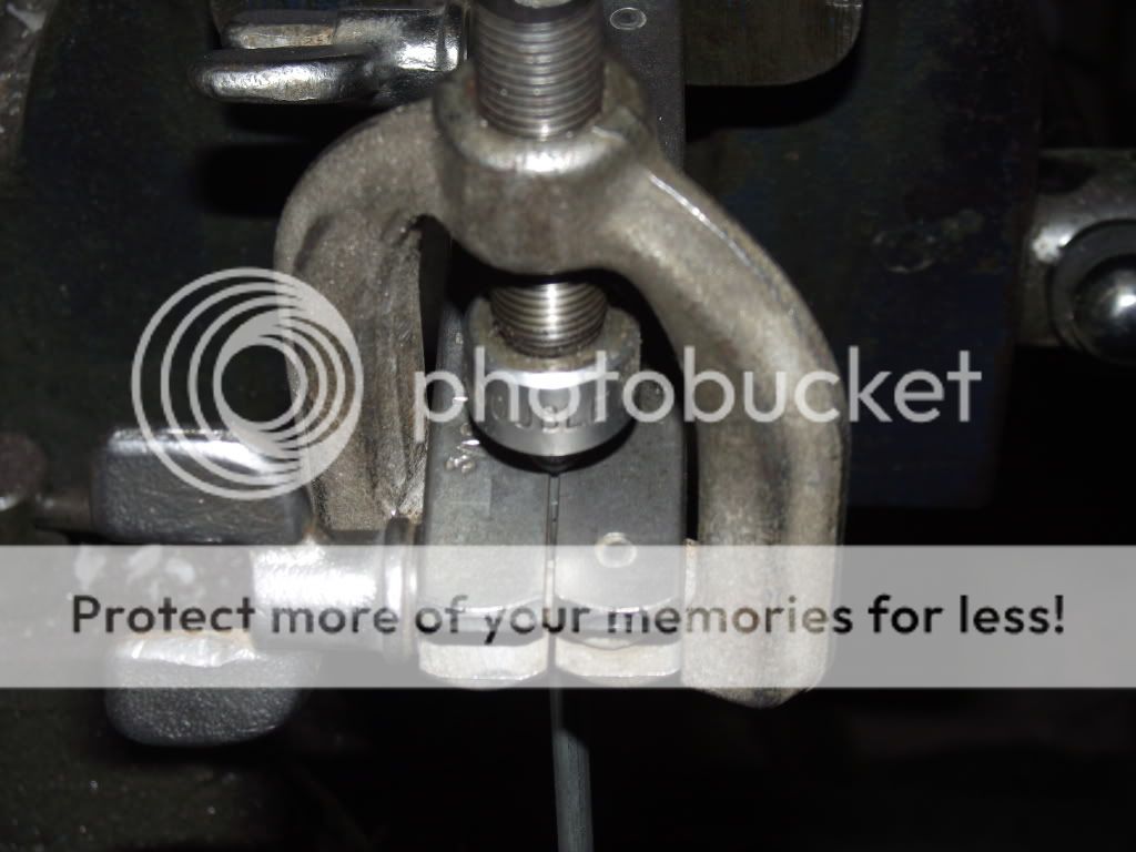

tighten the press down SLOWLY,watching the die to make sure it's going straight.also,make sure the tube is not sliding in the clamp.tighten down completely.

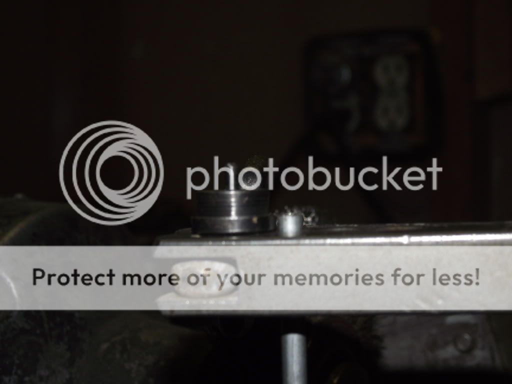

reposition the press(without the die)and turn clockwise as before.press down the flare.don't get too carried away with how tight it is-you don't want to squash it out too much-just press it down.
Gt-12

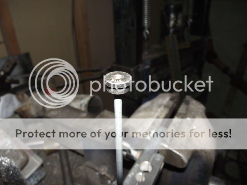

remove the press,it should look like this.
Gt-12

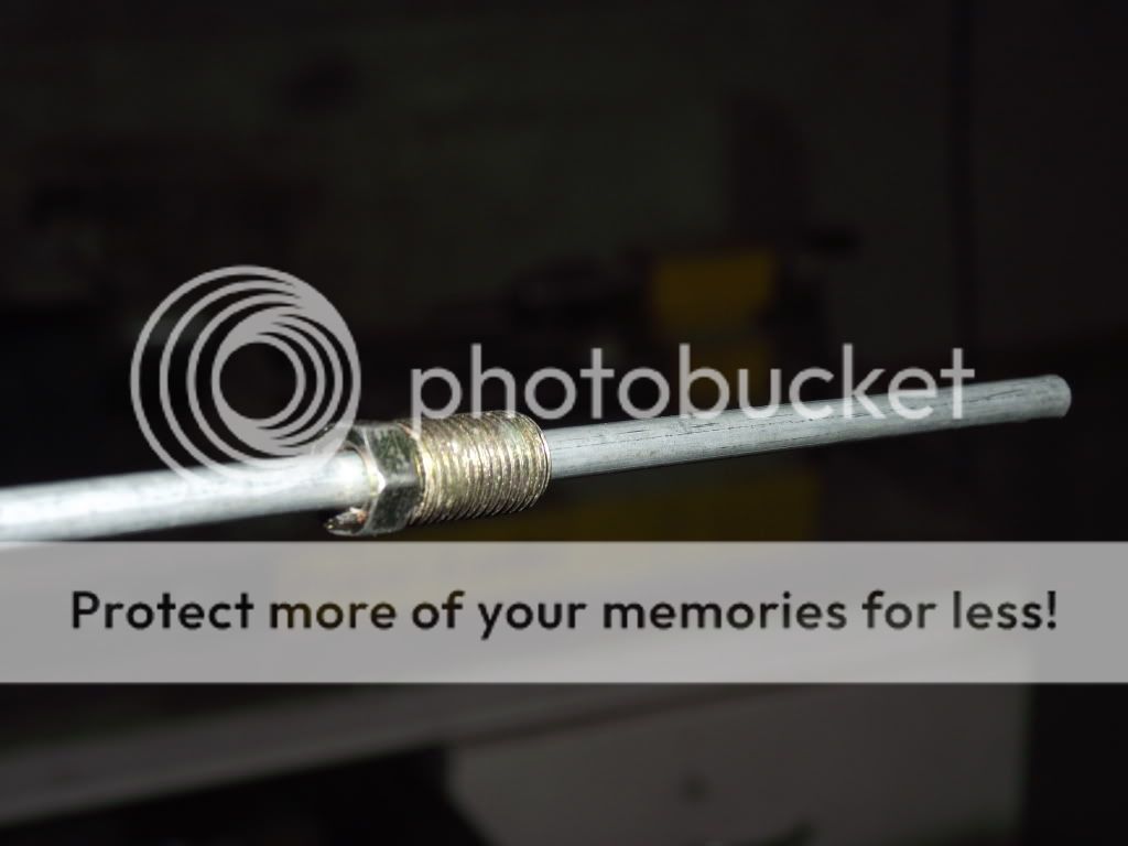

now undo the clamp....ta-da!
one perfect double flare.
don't worry about how long it takes at this point,it will get quicker with practice.and a line that took a little while to make properly is less likely to make you dead than a quick and sloppy job.
:icon_cheers:
Thanks Gwaii, biggest difference I see in your process and the way I've attempted to do it is using the vice and the way you rotated the press to keep it from moving around...oh and not squashing the flare in the last step:D I'll be giving it another try Wed now:icon_thumby: Hopefully I can figure it out because I'm redoing the whole system on my ranger while its apart and I'm not accepting anything less than perfect...this could take some time:icon_surprised:
a drop of oil on the screw and on the die helps too.
that it does....but you need to be carefull not to get oil on the fittings or in the tube,as it will contaminate the brake fluid.
