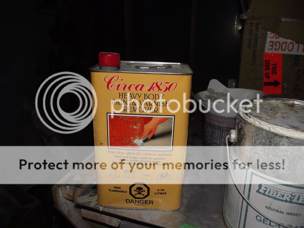

i know what you mean about having to keep it down when it gets late.once the kids go to bed,i'm hooped.for chemical strippers,i like this stuff.

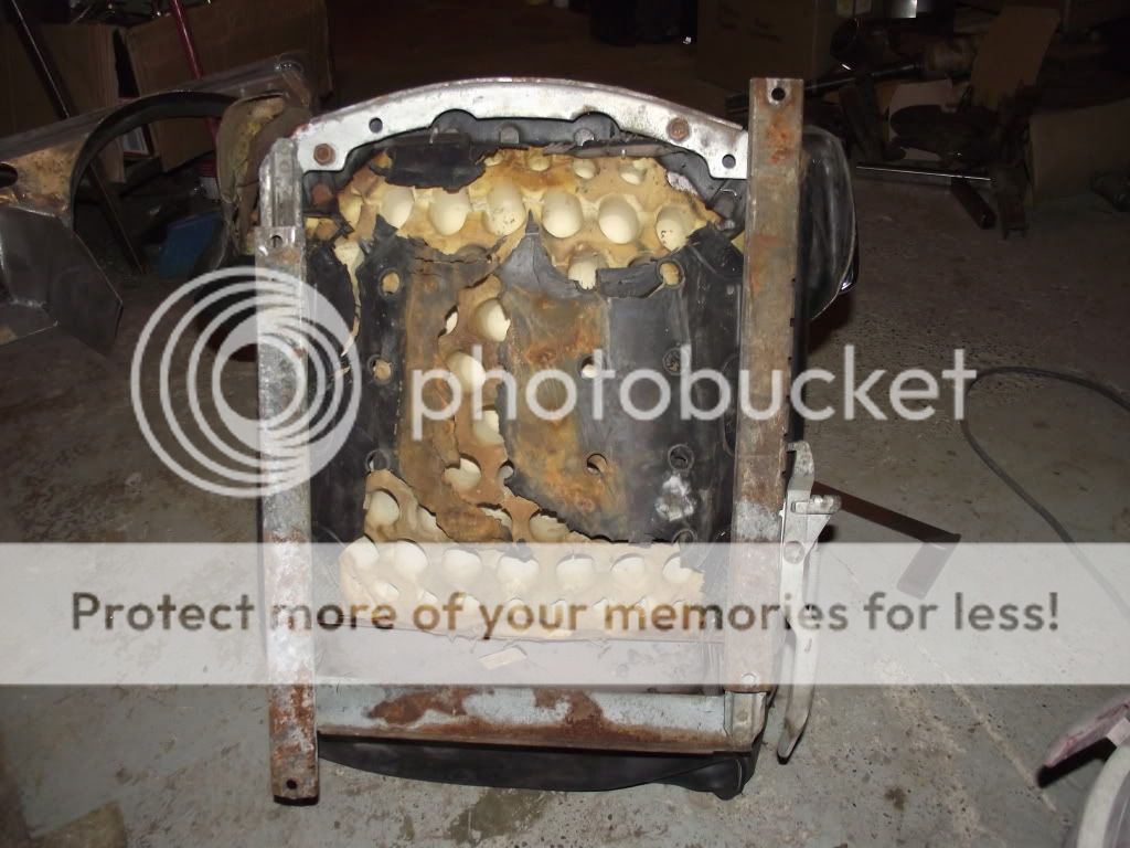

an area that i brought up in the first couple of pages,and haven't addressed yet is the seat fit.while i can get them in as is,i can't use the adjusters(like i'd ever need to pull them from the furthest back position)so i'll be rearranging things there.i'll swap the tracks side for side,so the adjuster will go in between the tracks.

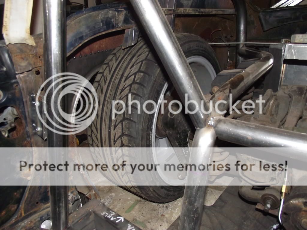

as for how they'll fit between the frame rails,i cut out big sections from the rails to allow the seats to fit.these still need to be plated in with 1/8'' steel to get back some of the strength that was lost.

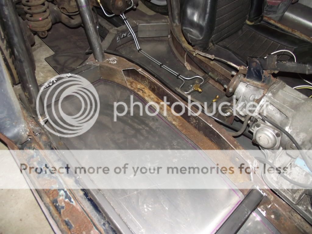

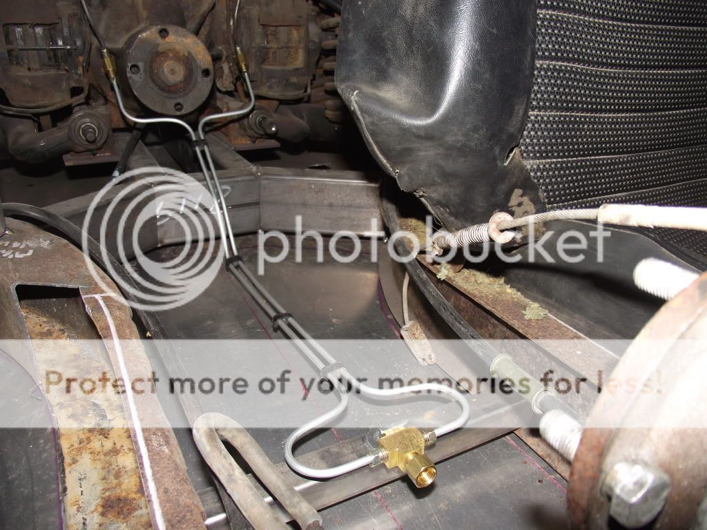

another thing to bring up while taking pics in this area is the running of brake lines.it doesn't matter that no one will ever see them....a nice neat routing with even bends will always be the sign of a person who cares about what he's building.

so heres the area i need to work in for the tubs.i cut out the inner fender structure when cutting the car apart...this will need to be replaced.

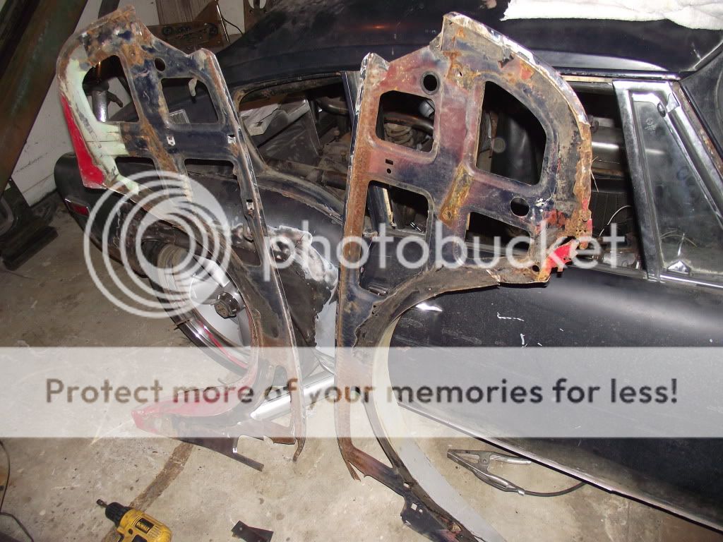

these are the old inners.i will be making new ones,as the wheel openning will be quite a bit larger than the original,and i don't want it to be pieced together(like the hood:D)

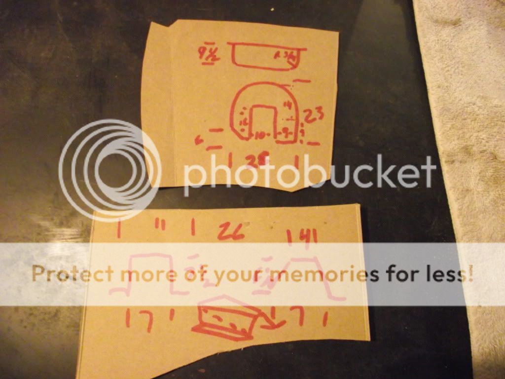

here's my fancy blueprints for the tubs and driveshaft tunnel:icon_rofl:
when i'm making a drawing for someone else,i get fancy...for myself,not so much-as long as i have the info i need i'm good.

i always appreciate good workmanship...what it's applied to is of no concern.

Just love the fancy blueprints, they look like the ones I make. The red marker's a nice touch, I usually use a carpenters pencil.
