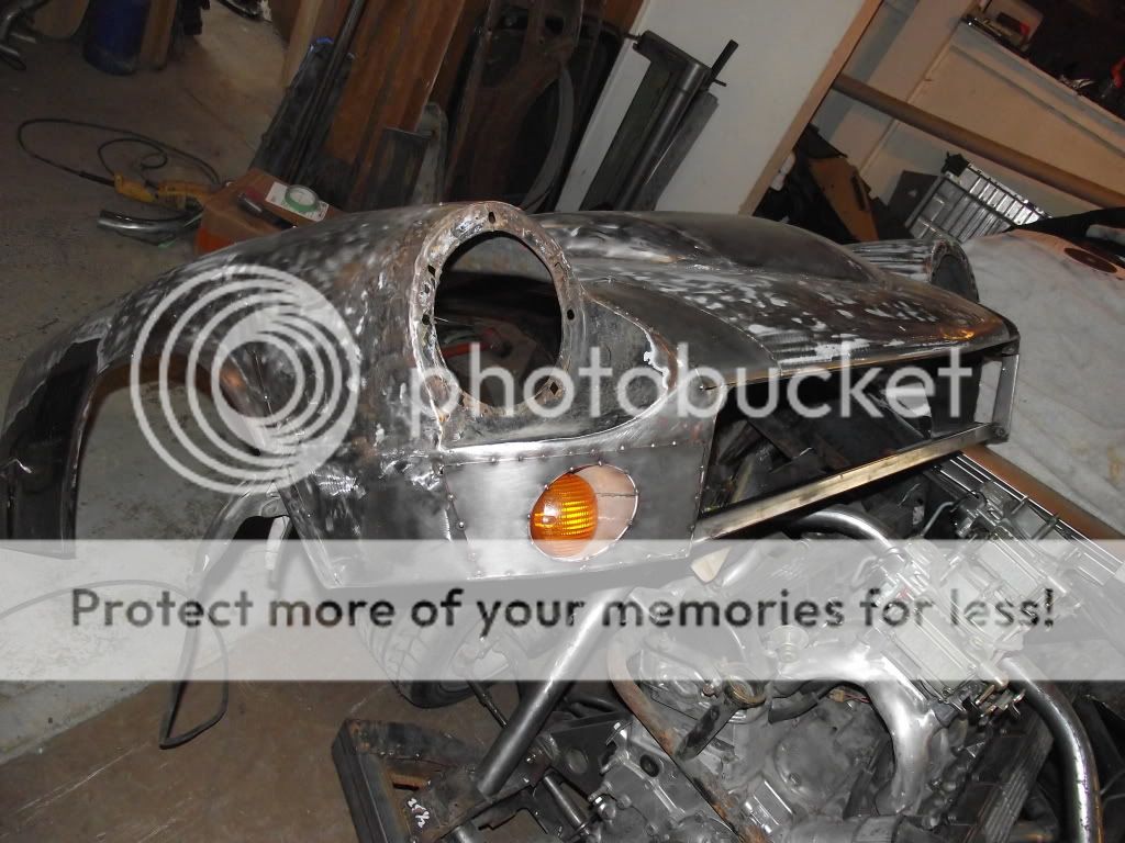

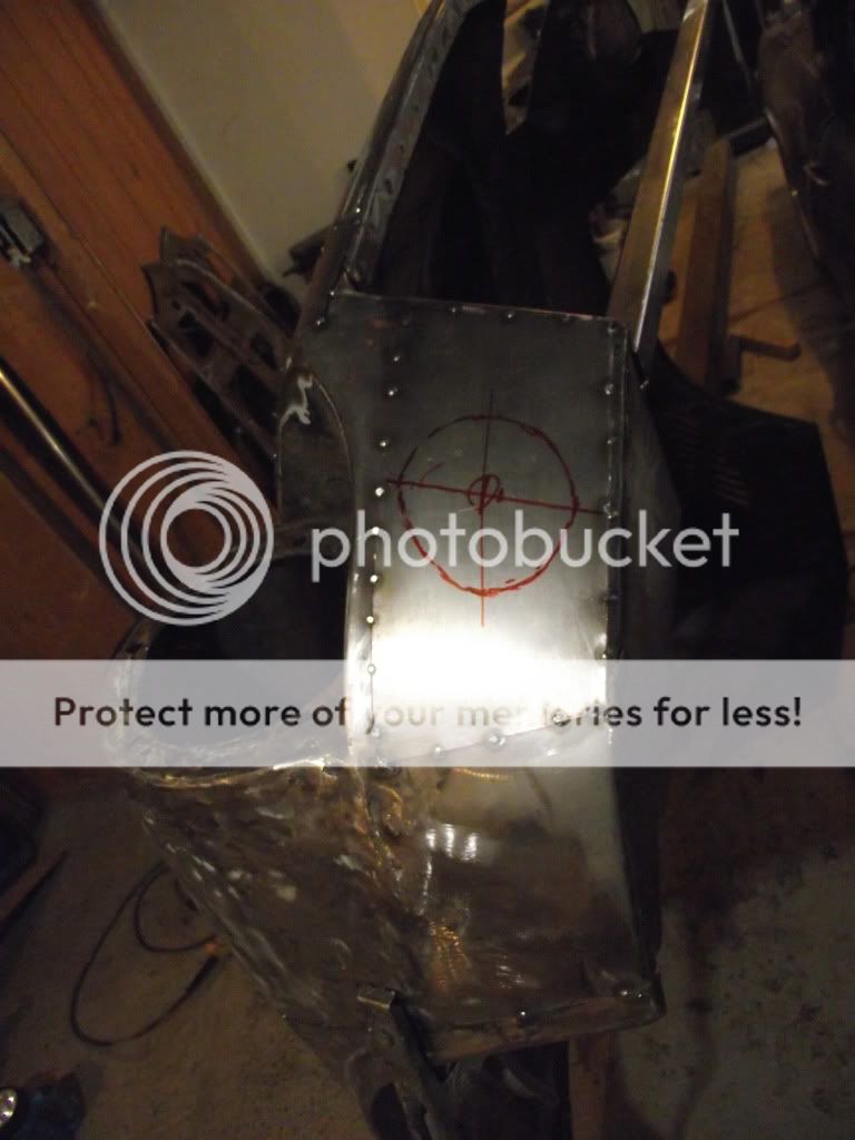

chopped out the turn signal area and welded in the new panel.

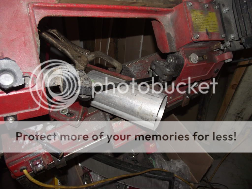

cutting the tubes for the lights to live in.it's just 3 1/2'' exhaust pipe(i think there'll be more exhaust pipe in the body of this thing than the exhaust)

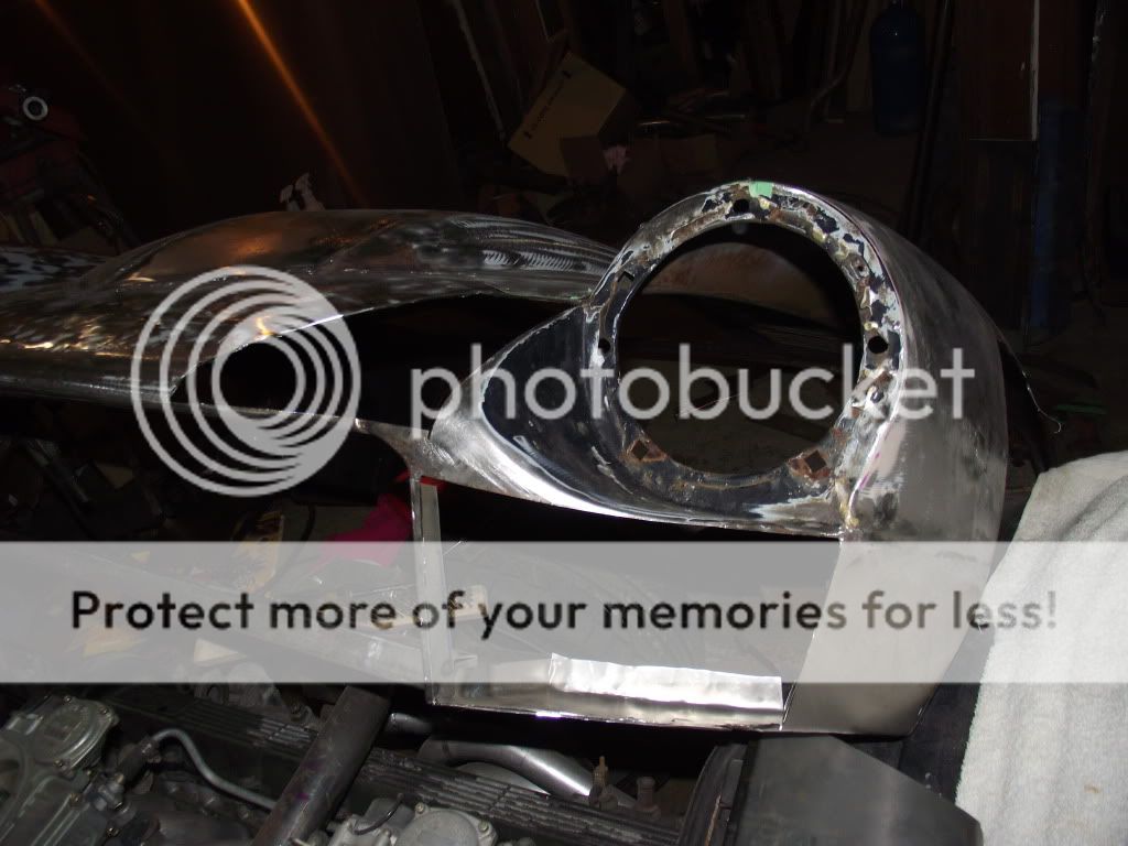

and this is what i want it to look like....i sunk the lights in just far enough that they can still be seen from the side.gotta keep the lawmen at least a little bit happy.

I love those recessed lights, man.
The more I think about it, the less I think you should paint it. You shouldn't even finish welding it. It looks good enough as it is. Give it that nice industrial look. :icon_rofl:
Just kidding. I wanna look like this when you're finished.
ya,i think the round lights suit it better.i'm just finishing off the one on the left side.

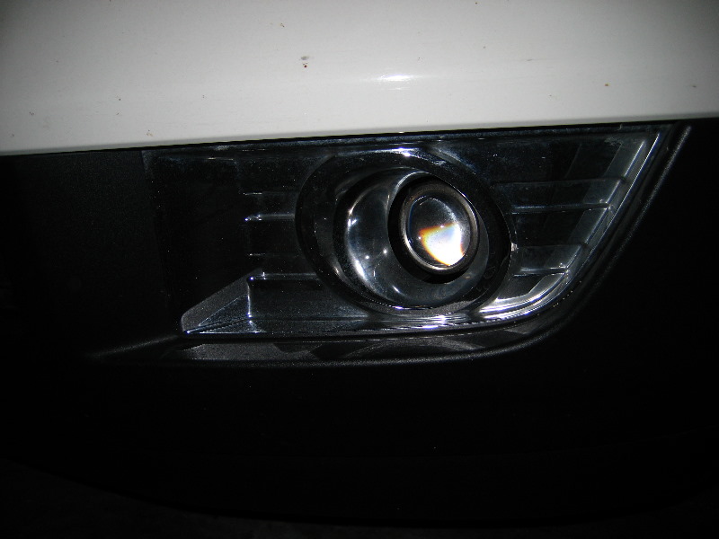

I think it would look nice, you should look for a set like the ones on the Flex/Edge/Fusion. I got a set from work and am planning on sinking them into my bumper. They have a cool look and great light output.
Could have done it in stainless like the delorian
those look good,but i'll probably go with something aftermarket and a little bigger....more retro looking.
