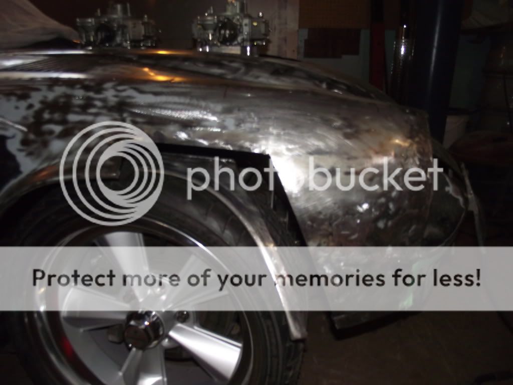

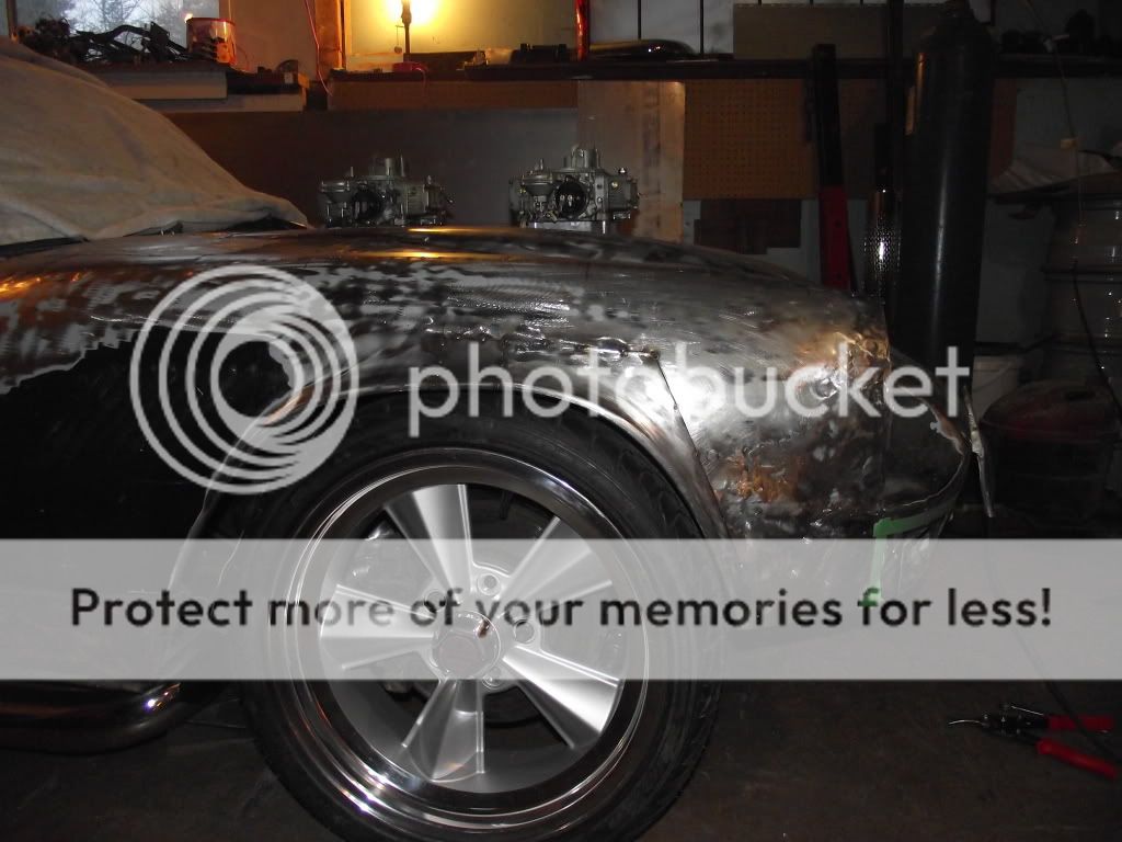

the extended front wheelwells were not making me happy.they needed to be made a bit bigger yet,so i chopped them out again.

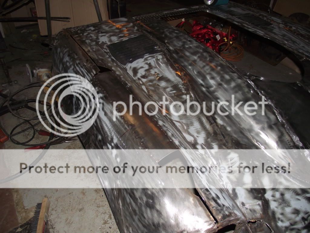

i got done fitting patch panels into the top of the right fender,now theres a lot of welding and dressing to be done in this area.

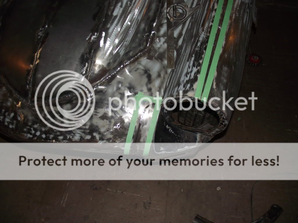

this seam at the front corner needed a bit more than just welding it up...so i cut out a large area around it to get some fresh metal in place.the old section is sitting above the cutout.

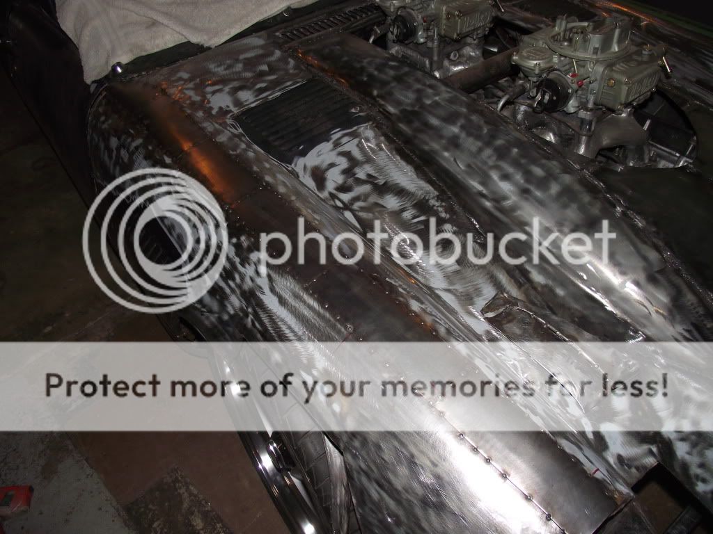

these same areas need to be cut out still from the left side.oh joy.

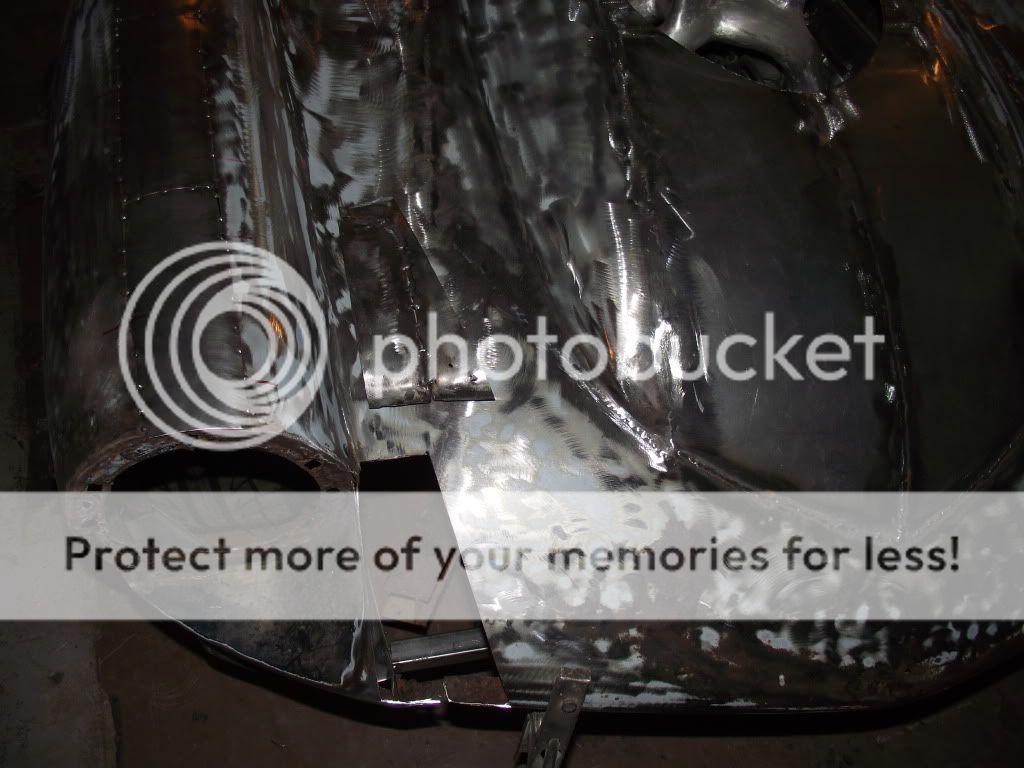

tacked back together,the wheel arch doesn't look much different,but it clears the tire much better when steering now.it was getting a little too close for comfort before.

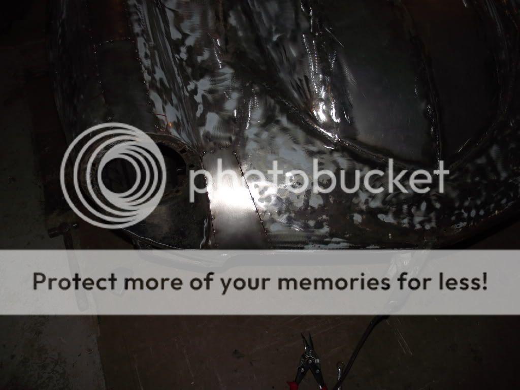

with it's new patch in place this area looks much nicer.

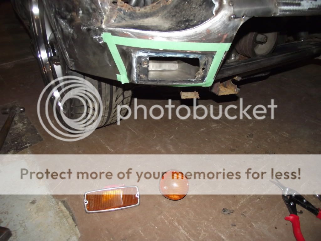

another mod i'm making is in the signal light area.i've been trying to figure out what to do here for a while,and finally came up with a solution.i'm cutting out the original mounting area and plating it with a plain piece of metal.into this i'll french in a tube where i'll mount the round light.this light is one of the fixtures i eliminated from the rear,and think it will look better than the rectangular one that was original to the car.

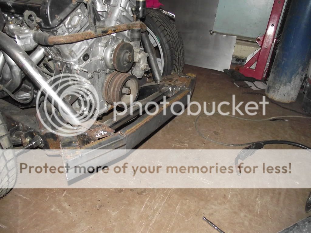

another little item i had to take care of was the front frame crossmember.this one gives quite a bit more rigidity to the frame.for those keeping track,this is the third(and hopefully last)version of this part.the round tube under the pulley that was for the first version of the front suspension will be removed.
