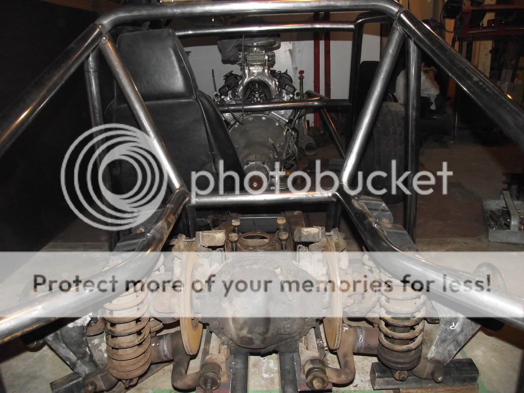

here you can see a little more bracing has been added around the diff,but not too much else.the wheels should show up any day now,and the components for the front suspension will be here soon too.
i'm not in too much of a hurry,as long as i have it rolling(not complete)by spring,i'll be happy.

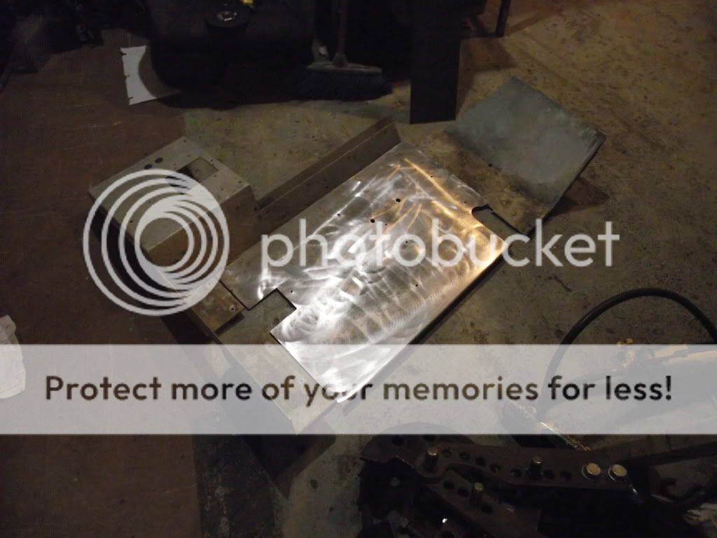

figured it was time to get the firewall/cowl/footwell area started.those that have been following the ranger build might remember that fancy aluminum floor i built for it .now,that is just material on this project.
this is the part that went across the back of the cab.it happens to be just the right width for the cowl,and the profile is good too.

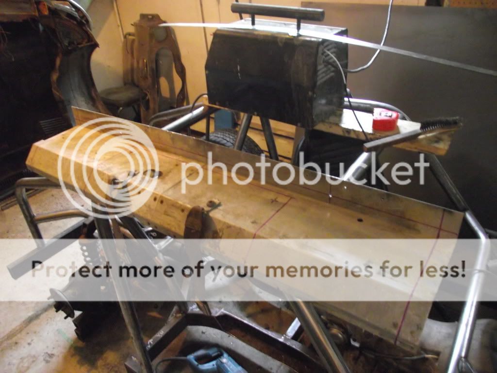

the passenger side floor,about to become the firewall.

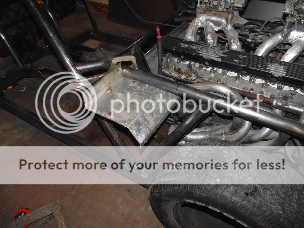

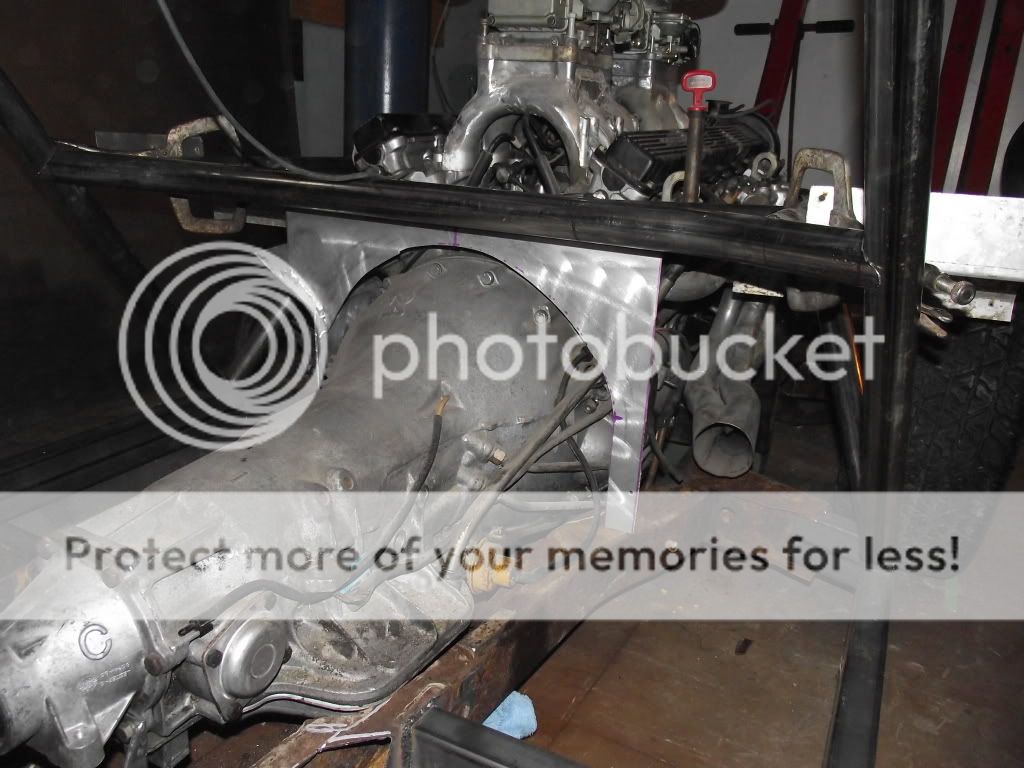

the firewall rough fitted
and the cowl piece clamped in.
i'm starting to find out just how tight this thing is going to be-i tried sitting in it to see where the pedals would need to be.i need to be sitting right on the floor to clear my head,and the footwell is just wide enough to get both feet in there,but not move them around.this means that i will need to drive with my left knee bent just enough to bring my foot out of the way of my right foot,so i can work the brake and the throttle.good thing it's an automatic.and no long trips for this,it's just good for a summer town cruise,as the exhaust will be trying to cook my feet as well.

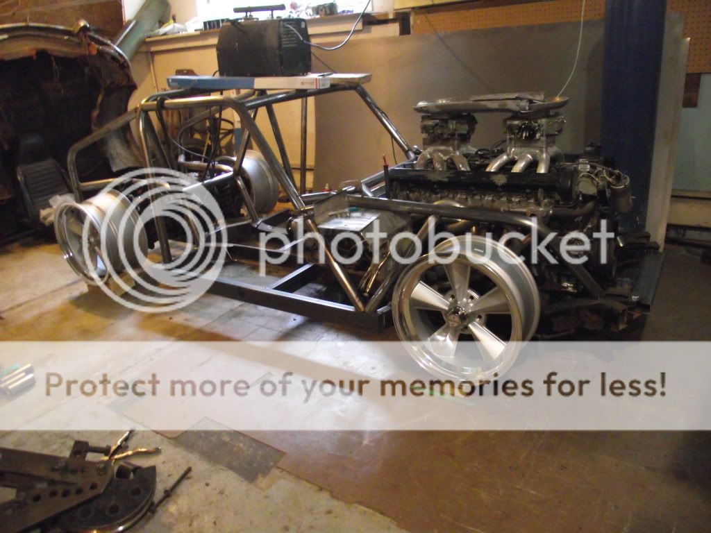

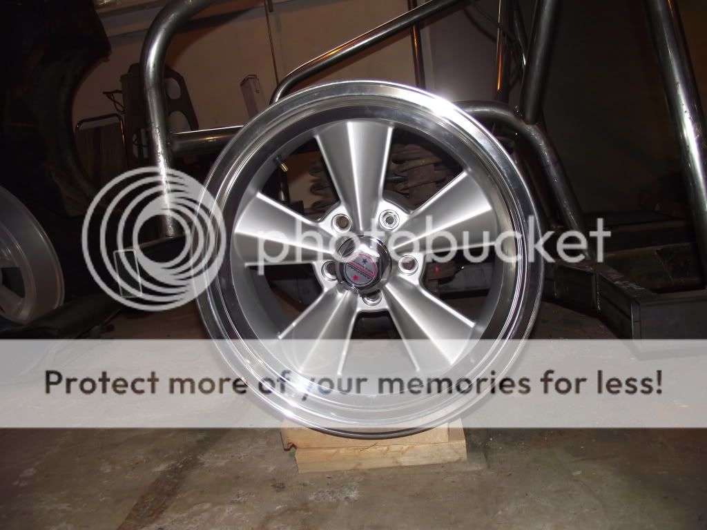

bling!
sure wish i could afford the tires now.oh well.

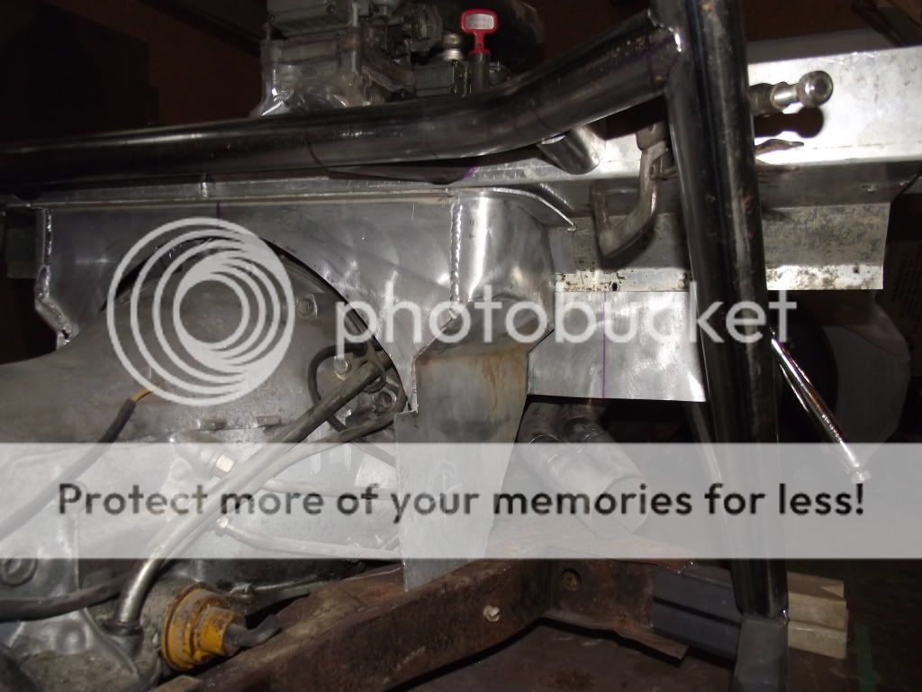

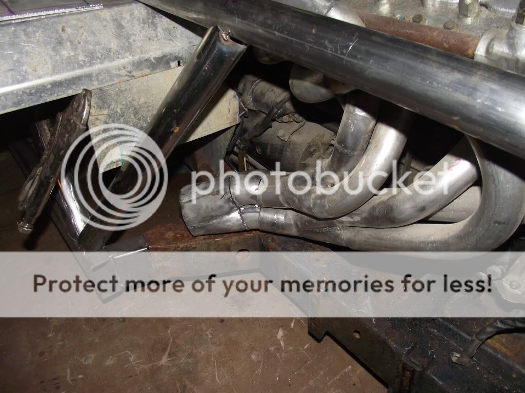

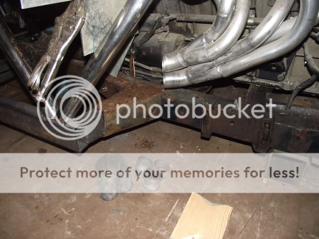

also,i finally had to cut the header as i'm building the firewall and the collector was in the way.
but a little rearranging of the parts gets it pointed in the right direction.
the firewall/footwell area is shaping up....lots of bits to fit together.
those rims look sweet man!
i wasn't sure at first about going with the 17'',thought 15'' might be better.glad i went the way i did.:headbang:
It's coming together nicely. I think the 17s were a wise decision also.
