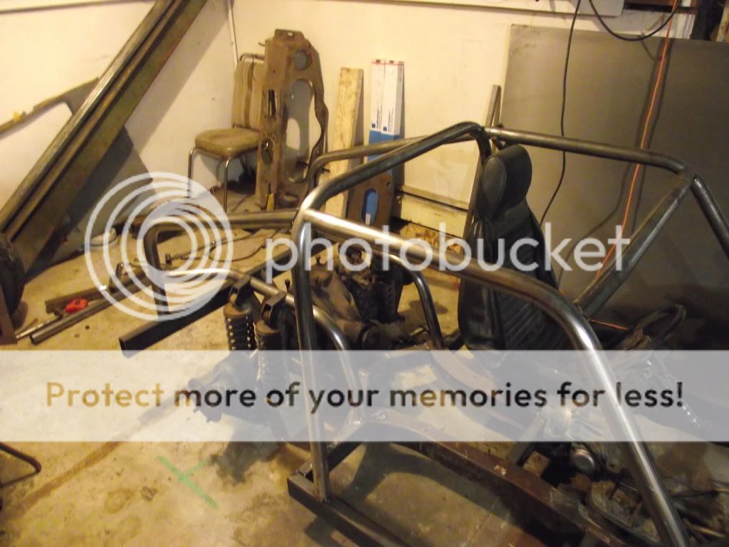

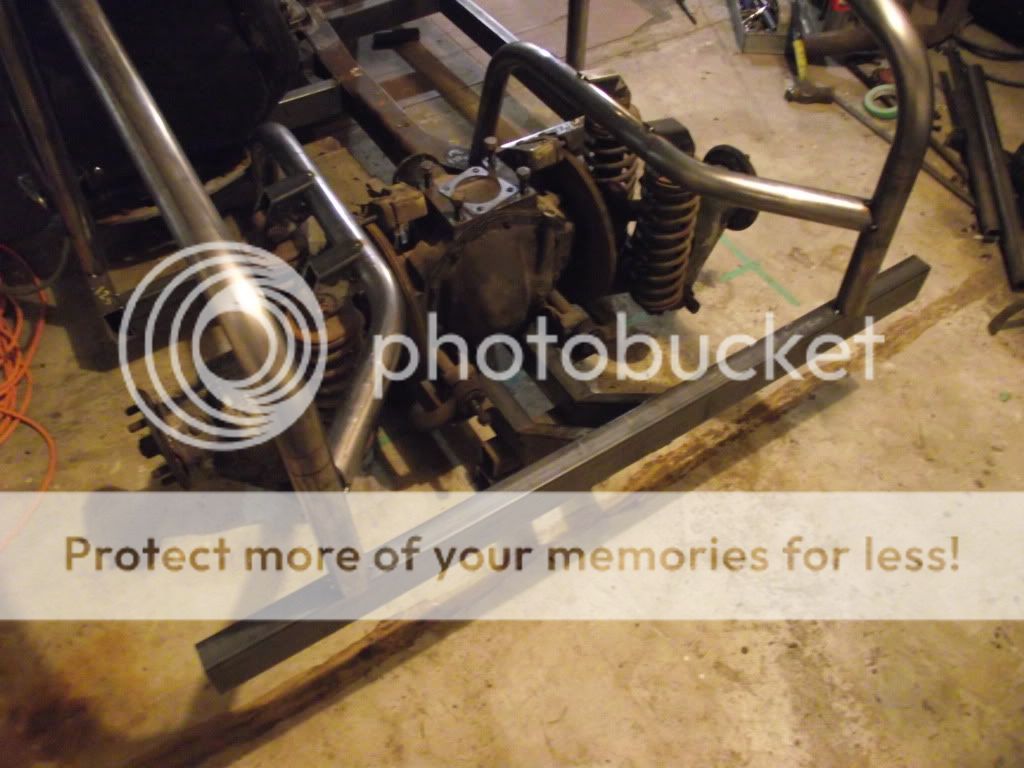

rear cage framed out,and springs are one with the car.
from the back.i still need to make the top brace for the diff,this needs to be a removeable part so the diff can be taken out.in the jag setup,it dropped out the bottom-this one it will come out the top.

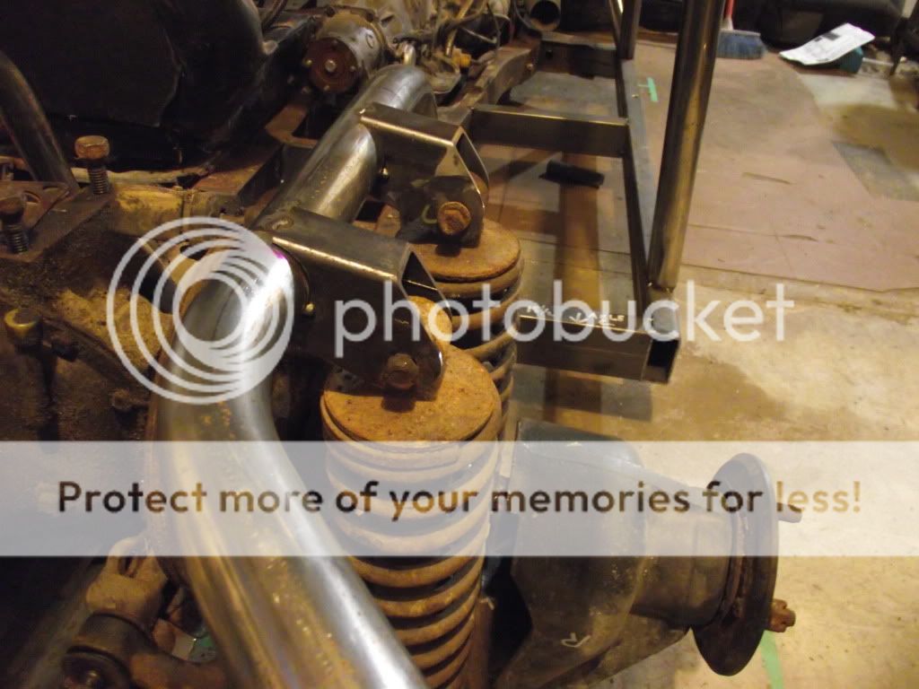

a closeup of the spring hangers-i copped out on the adjustment idea-what i will do is tack them in place well enough to hold the weight,then if adjustment is needed i will break the tacks and rotate them up or down as may be needed before welding them on solidly.
