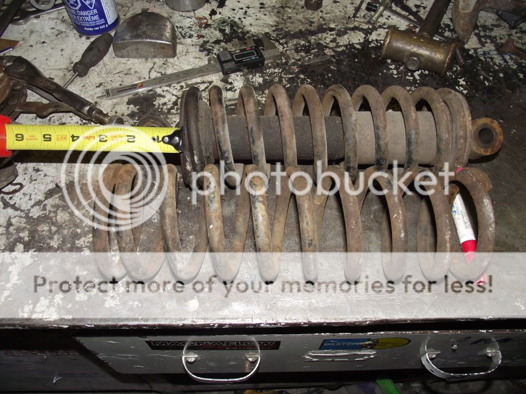

so,i've been dealing with a little problem since welding on the upper spring mounts.i could not budge the rear suspension,even when i jumped on it the springs wouldn't compress a bit.
i know the jag rear was set up for a much heavier car,so i figured there must be some preload on the springs.when i took a spring off the shock,i found exactly 2 1/2" preload.
some quick calculations determined a spring rate of 170lb/in,so 2 1/2"=425lbs just to start it moving....and theres two springs on each side,for 850 lbs/side.
but it's not quite so bad,as the spring is 4" down a 12" arm,so that must be multiplied by .66 for 561 lbs per side.so i would need to put over 1100lbs on the back of the car just to get the springs to start to move.
my plan is to cut 1 1/2 coils from each spring,giving it only 1/4" preload.this will raise the spring rate to about 190 lb/in,for a total per side of 380lb/in,times the .66 for 250 lb/in each side.
i only need a little over 1 1/2" of compression at the spring for ride height,so this works out to a total load on the rear of around 750lbs.
i think this gets me into working range.
When you narrowed the rear end it put the springs into a more vertical position, effectively reducing the springs effort on the suspension. Have you taken that into account?
yes.they are now in a near vertical position,so it makes the calculations a bit easier.
another thing that i had to get used to was the short travel,i'm used to doing these calculations for long travel truck suspensions-1 1/2" travel at the spring for full droop seems plain weird.my total travel(measured at the wheel)is 4".
