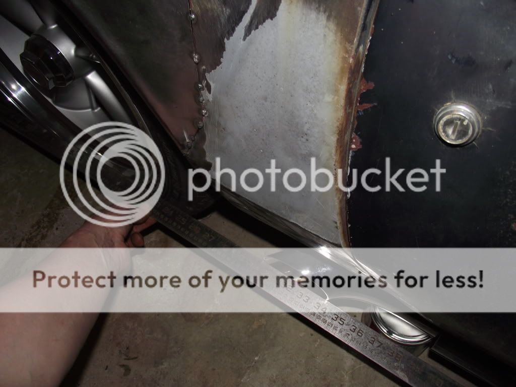

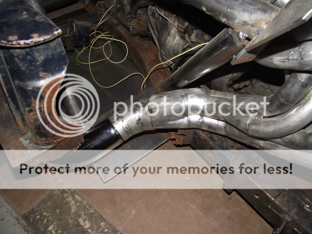

oh,and here's how i determined how far in the pipes needed to go.i didn't want the outlet to stick out past the tire,so a straight edge laid over the tire to the outlet gave me the location needed.
it's little details like this that can make the difference between a look that flows together and a bunch of parts slapped together.

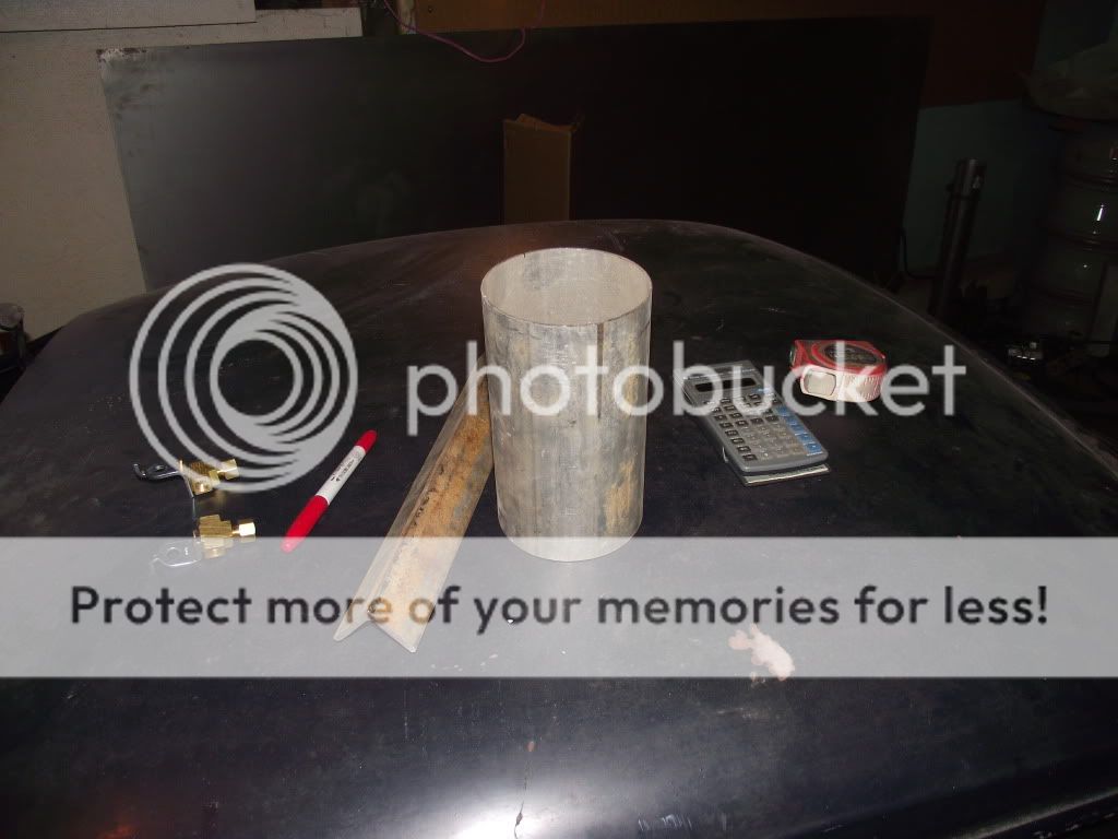

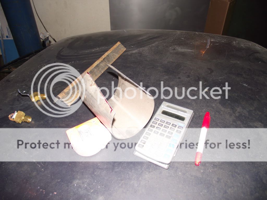

as mentioned before,a tapered elbow will be needed on the right side to join the header to the pipe.i need to go from the 3 1/2'' collector to the 3'' pipe inlet while turning about 30*.i'll show the quick and dirty method.
to do this i will use the stuff in this photo.well,not the brake line fittings....those are parts i've been waiting over a week to get.
that's a chunk of 4'' pipe i'm using to build it from.

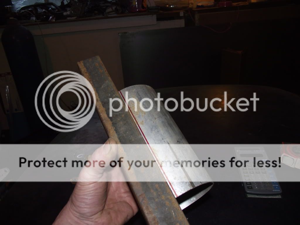

i start by laying out a centerline.this is easilly accomplished by setting a hunk of angle iron on the tube.it will sit in line with the tube,allowing for a quick and accurate line.

now i use the centerline to lay out the circumference on the two ends and cut out the unwanted material.

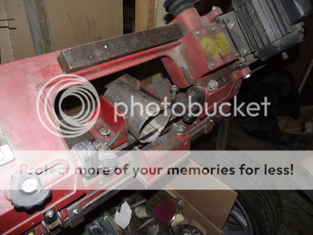

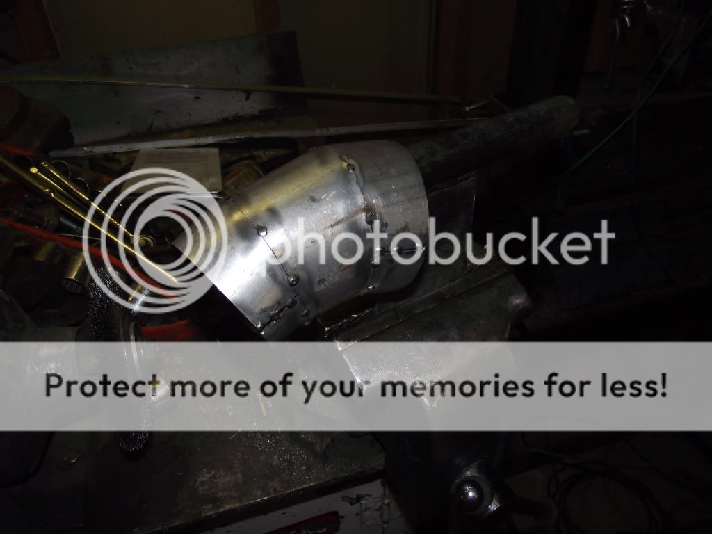

i beat the crap out of it to bring the cut edges together and tack it to make a straight taper.then i trim the rough ends with the bandsaw.

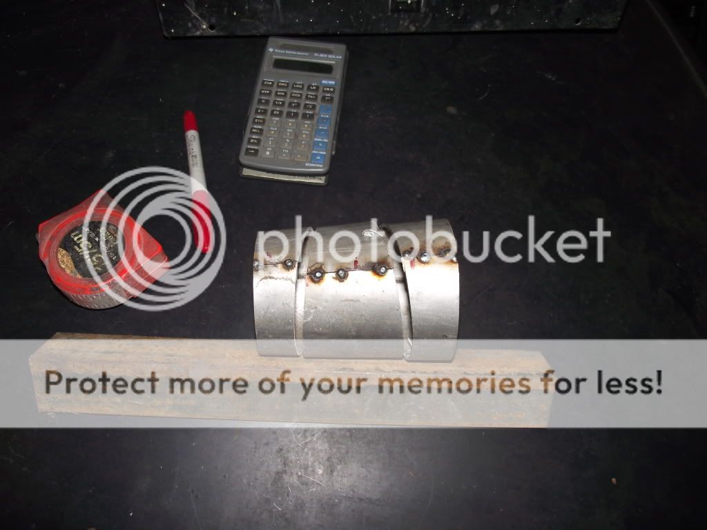

now the fun part.

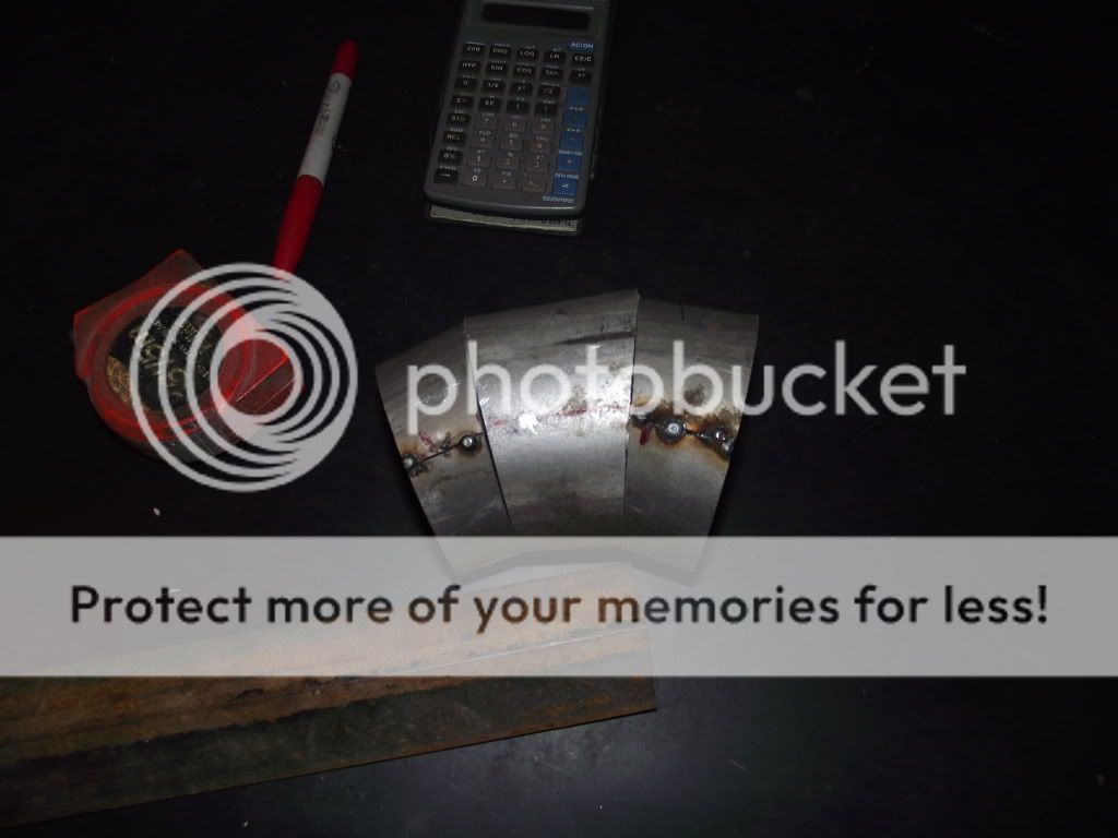

you need to decide how many segments the elbow will be made of....i decided on 4,then changed it to three when i got to laying it out.
i want it to turn 30*,three segments will give me two angled sections...so each angle must be 15*.and each angle is made from a pair of miters,so each must be 7.5*.this is my cut angle.
in this case i didn't bother measureing any of this,i've done enough that i could get it accurate enough by eyeballing it.

now when i turn the center section 180*,it turns into an elbow.
some whacking and welding required.

whack,weld.
i toss it onto the t-dolly to shape up the seams while tacking to get a clean finish.
Gt-12

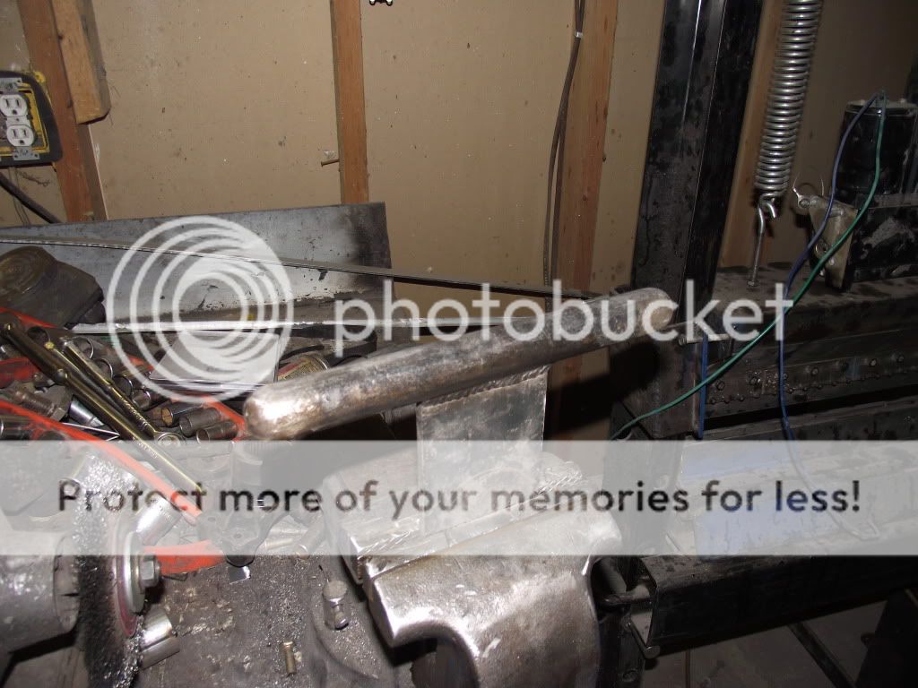

i guess this is something else i should toss into the homemade tools thread...the t-dolly is a simple tool to make-just a chunk of round bar welded to a chunk of flat bar held in a vice.for all it's simplicity,it's very usefull and versatile.

the tacked up elbow on the collector with the sidepipe elbow set in it.everything lines up good,so now it's a matter of making the slip joint and tigging up the seams.i built this angle into the secondaries on the left side,so a straight taper will be used there.

As for using the angle iron as a straight edge, that's so damn simple and ingenious! I'm using that method every time from now on:icon_welder:

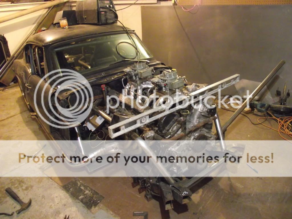

spent some time tonight trying to get everything squared up.there were a couple things not lining up the way they should have been,so more measuring was needed.turns out the engine was leaning to the left by 1 1/2*....this amount would normally not be an issue,but everything is so tight on this car that it was throwing stuff out-like the sightline down the body and the way the pipes sat.
the body itself was out a tiny bit too,so this didn't help things either.
building trucks is way easier than this stuff,theres lot's of wiggle room even on the tight builds.i need to make sure the engine is centered within 1/32'' on this car or everything goes to hell.
