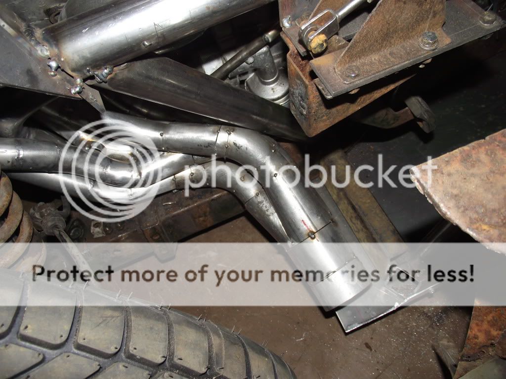

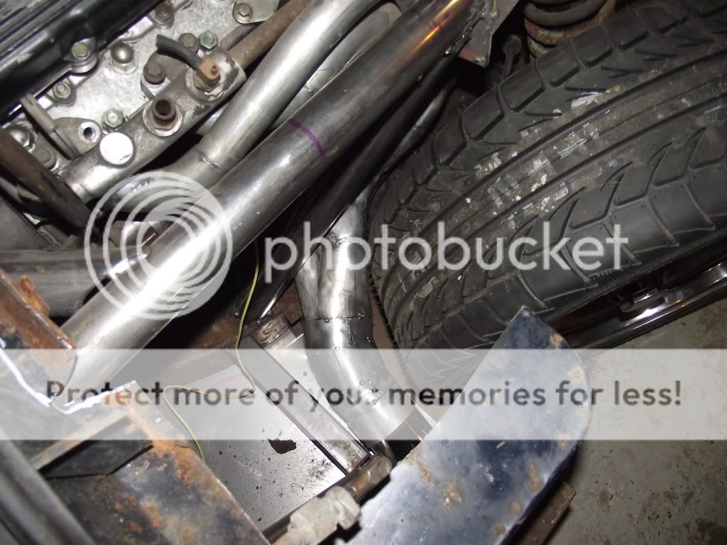

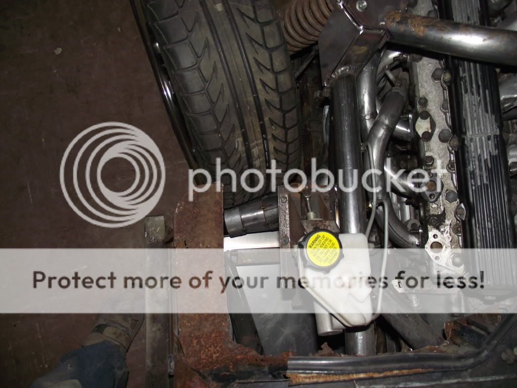

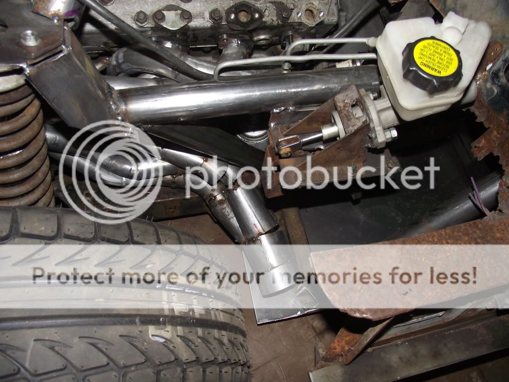

i put the front suspension back together to check clearances,
and while it's tight on the right side,it all clears to full right lock.
the left side was a different story.i could only get about 1/2 way to lock before the tire hit the collector.looks like some more rearanging is in order.
fortunately,the secondaries are still just tacked,so it won't be too hard to undo.
after some rearranging it doesn't look too much different than before,but the wheel can be steered left now.
i have some gaps to fill which will require removal of the header to complete,but this needed to be done to complete the header anyway.removing the header requires removing the front suspension again as well,but this doesn't take long.
