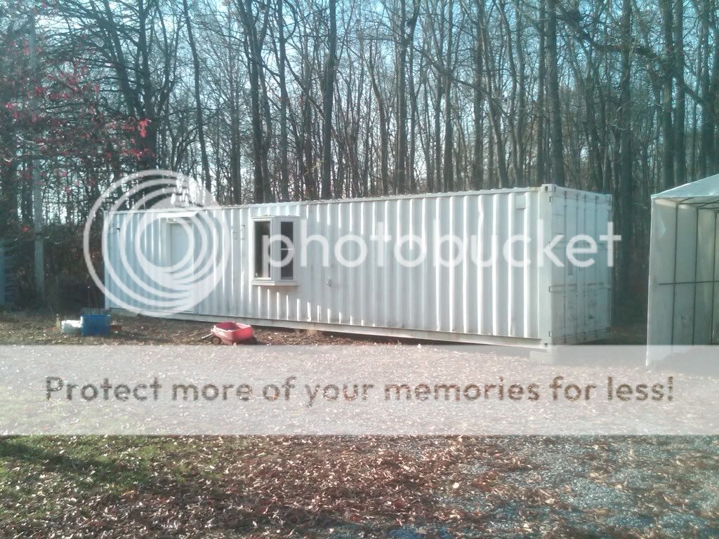

I had a customer earlier today with a cargo container he had made into a sewing shop for his wife.
All I could think when I saw it is "Wow, that looks like a mother-in-law suite Gwaii would build"
Gt-12
i lived in one of these for a year while i was overseas lol
