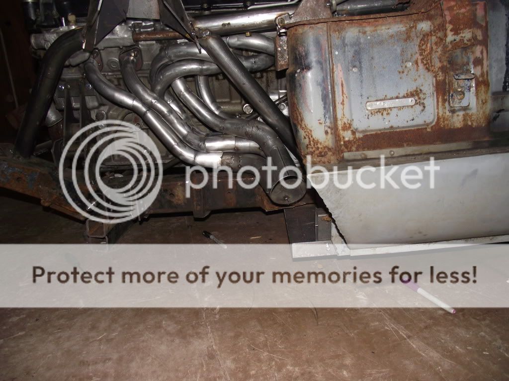

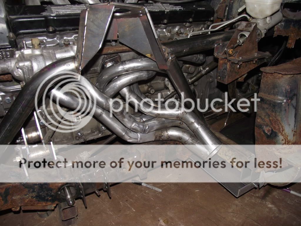

for those that like to keep track of such things,this header when done will be made from 58 seperately fitted and welded pieces.

i got the secondaries fitted up this afternoon.just about there.
Once the secondaries are welded together will the header still be able to be removed? easily? Seems kinda tight to me..
it's tight,but it comes out.there's one mounting stud that has to be removed from the block to get it to clear.

i remember being told before that when your building headers that all the runners should be the same length is there any truth to that or is it another wivestale?
Now that's a nice bunch of bananas. You know I think you would have had room to throw a couple of turbos in there after all. I'm joking, really!
Equal length runners are the ideal situation, length and diameter also playing into the equasion. In this particular situation it would be virtually impossible and with the rediculous power to weight of this thing it will not make a lot of difference.
like martin said,it can make a small difference,as long as the runner length is kept to a very specific amount,as well as other factors.
the extra effort would be wasted in this case.
