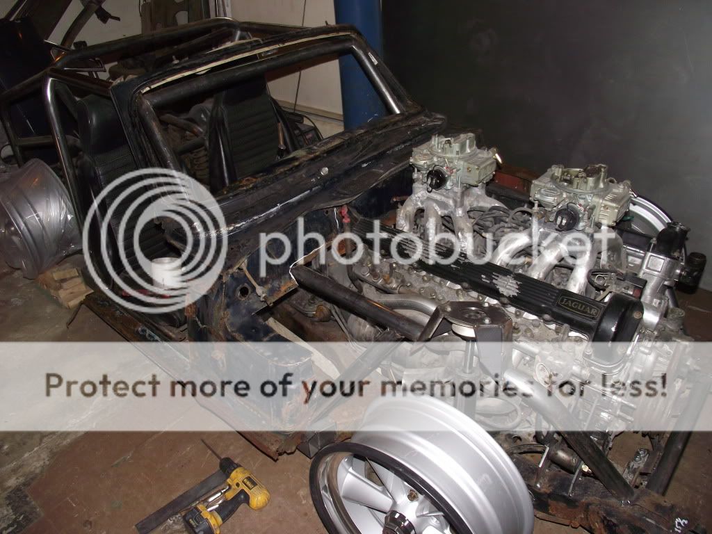

this is how the cowl fits against the motor.i was really hoping that the air intake for the heater would not be affected,and fortunately it isn't.
still,lots of surgery to do in this area.
also,when i made the motor mounts,i dropped the motor a little more(the bottom of the oil pan is now level with the bottom of the frame)so the oil cap actually clears the hood.i think that i'll still shave it though-it'll look cleaner.

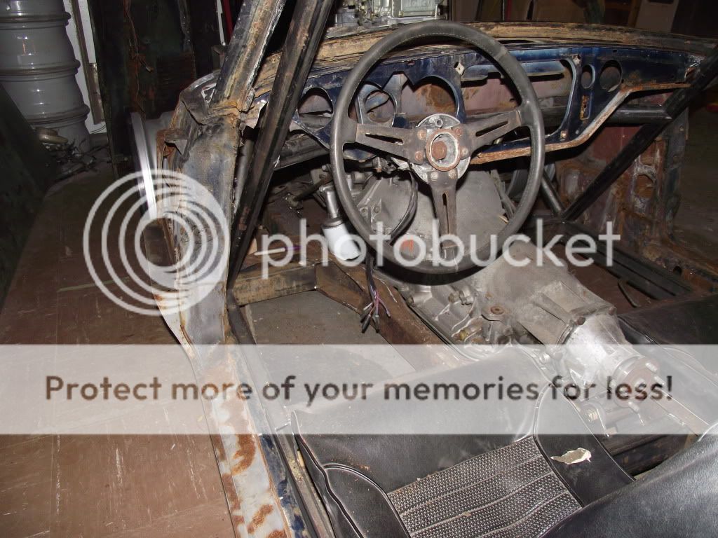

a shot towards the dash.if you look close you can see a spot in the frame rail where i notched it out for foot room by the gas pedal.this will be plated back in on an angle,giving me about 2 1/4'' more room to swing my foot from the gas to the brake.
it's still tight,but every little bit counts.
