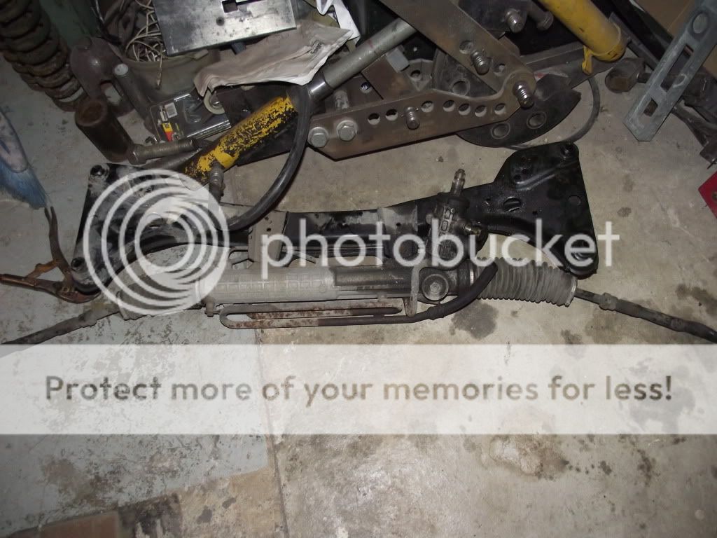

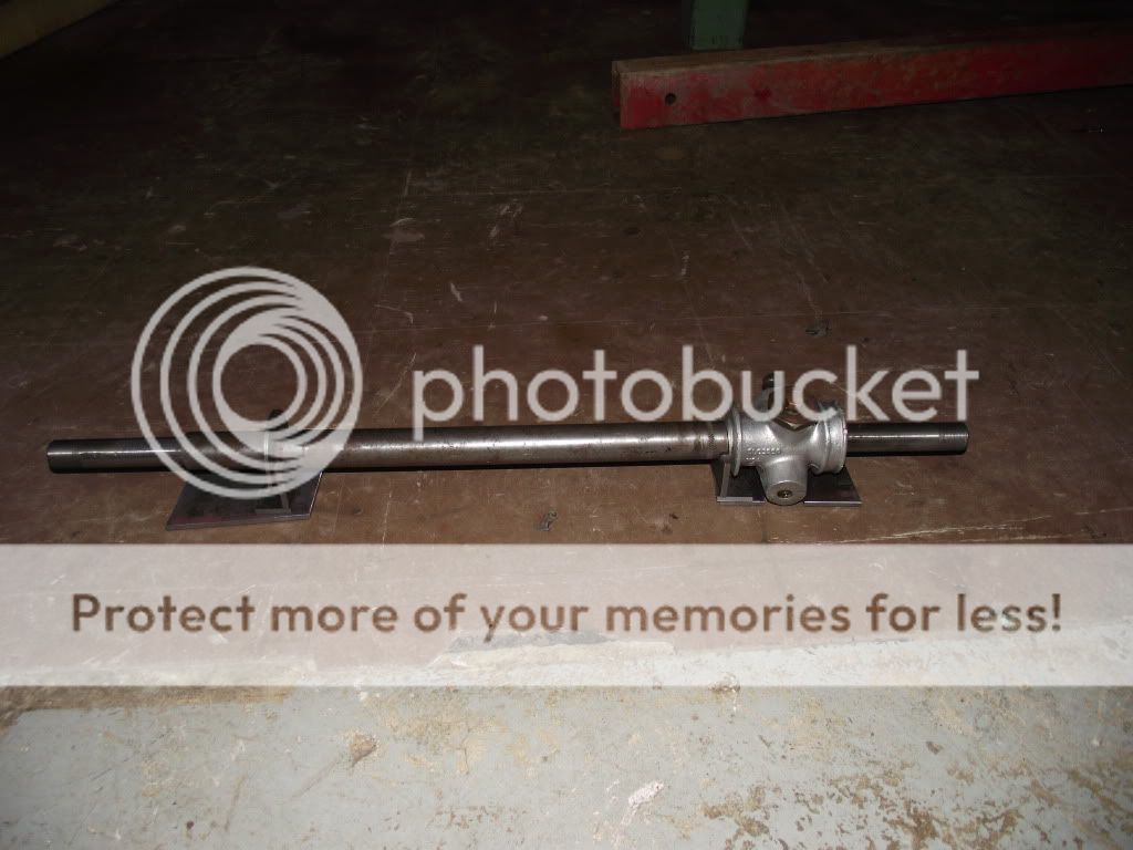

this is the bmw rack.power steering is nice,but it's bulky and i don't think i have room for a pump anyway.

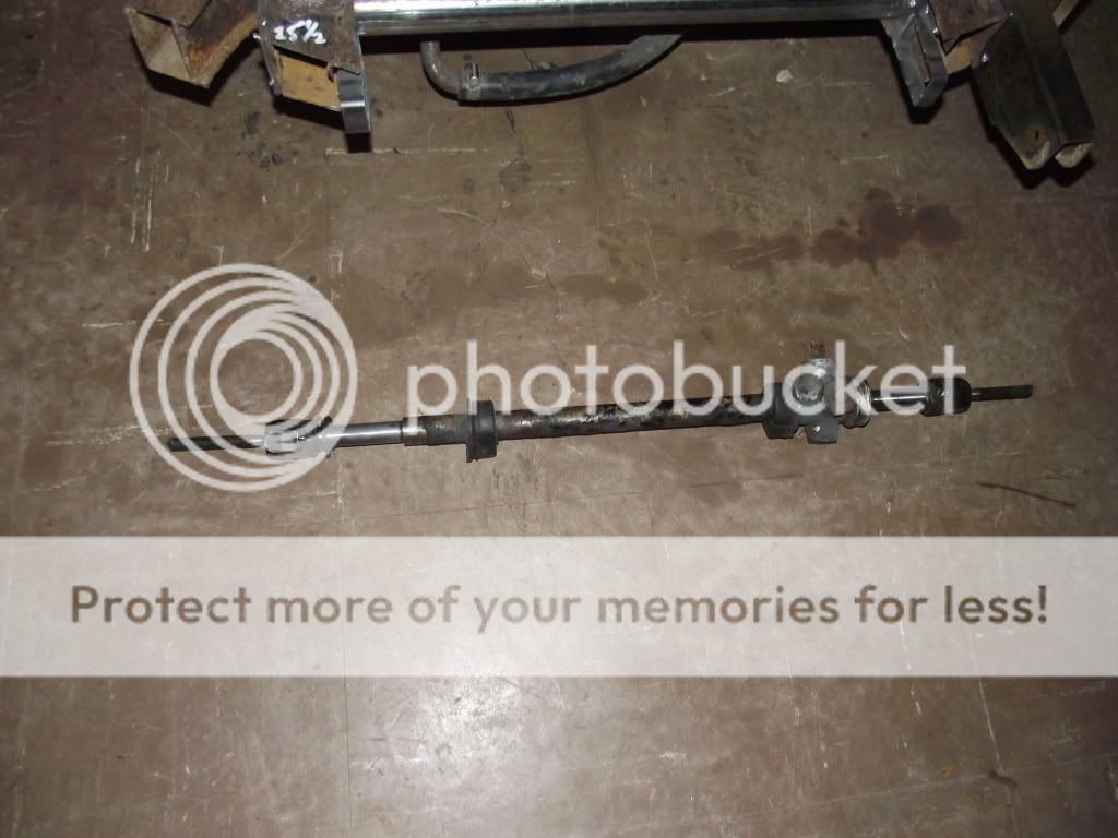

this is the original gt6 rack....no power,but much slimmer.i think this is as close to one dimention as i'm going to get.

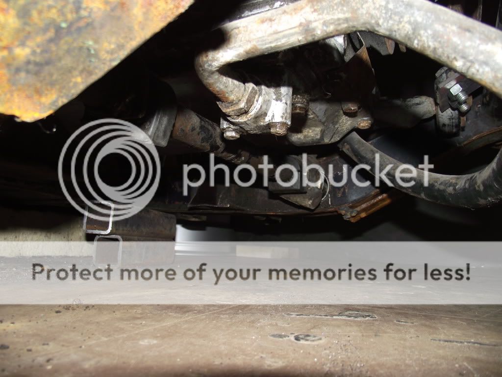

the next problem is that i cant put it above the frame,the engine is in the way.i cant put it under the frame,it goes against the rules....and would drag on the ground.
the plan is to cut a 2'' hole through the frame rail and sleeve it with a piece of tube-the tie rod can pass through it.

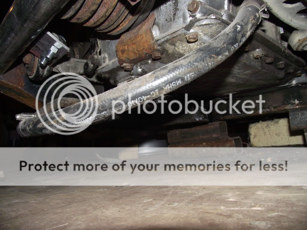

the wire is in line with where the tie rod needs to go,so the hole will be drilled directly under it.
this photo is taken from the left front looking toward the right side frame rail under the motor....this is how much room i have for the rack.

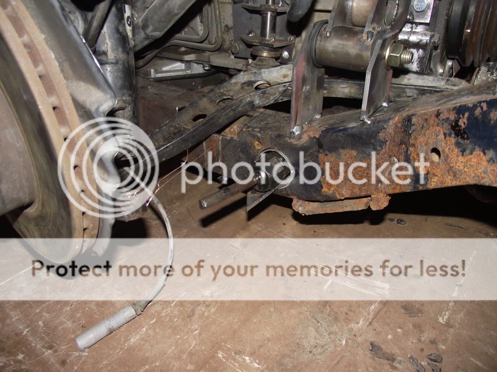

the hole drilled,sleeved,and rack placed.

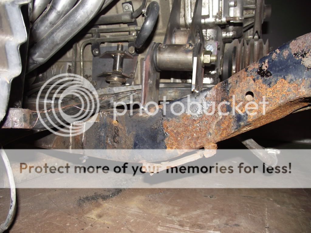

looking underneath from the other side,right to left.this shows another problem i would have had using the bmw rack-the steering input is further from center,so with the rack centered on the frame,the input would be into the left frame rail.with the gt6 rack,it is in a good position.now to make some brackets,and thread the tie rods to accept the tie rod ends.

i tore down the rack to clean it up,and found the rack gear was bent.a bit of press work,and it was good again.i'm now setting up the brackets to bolt it to the frame.

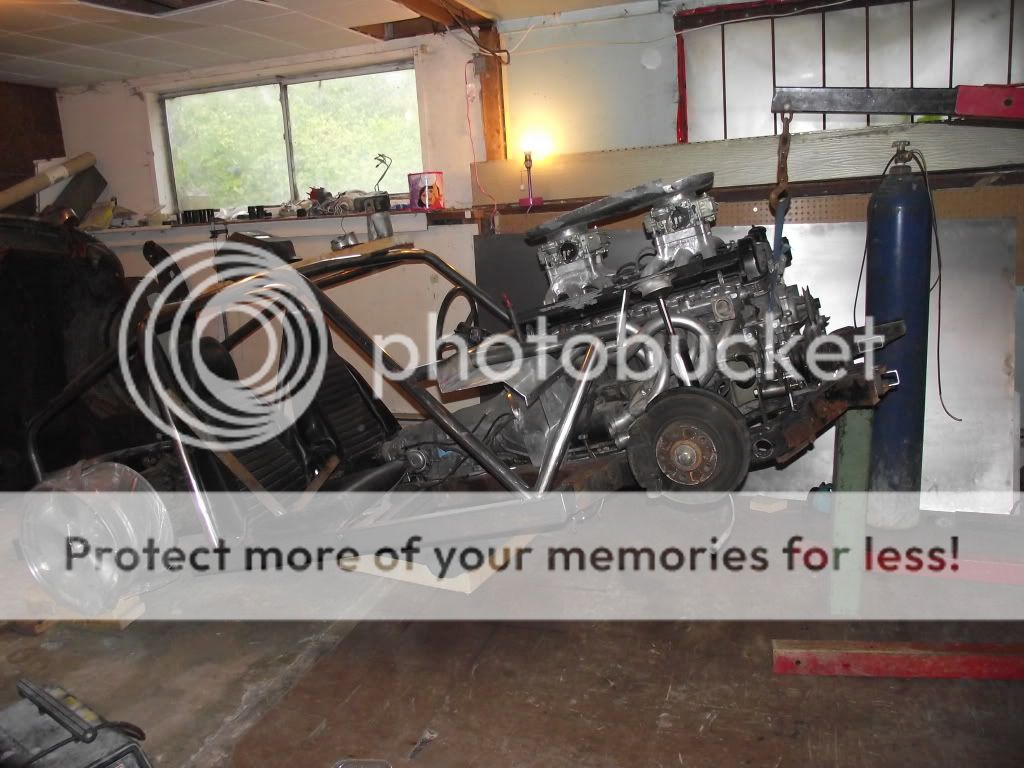

i'm also checking out how it will look while doing wheelies.....
actually,it was hard fitting up the steering with the frame 3'' off the ground.....this way i can get to the underside.
