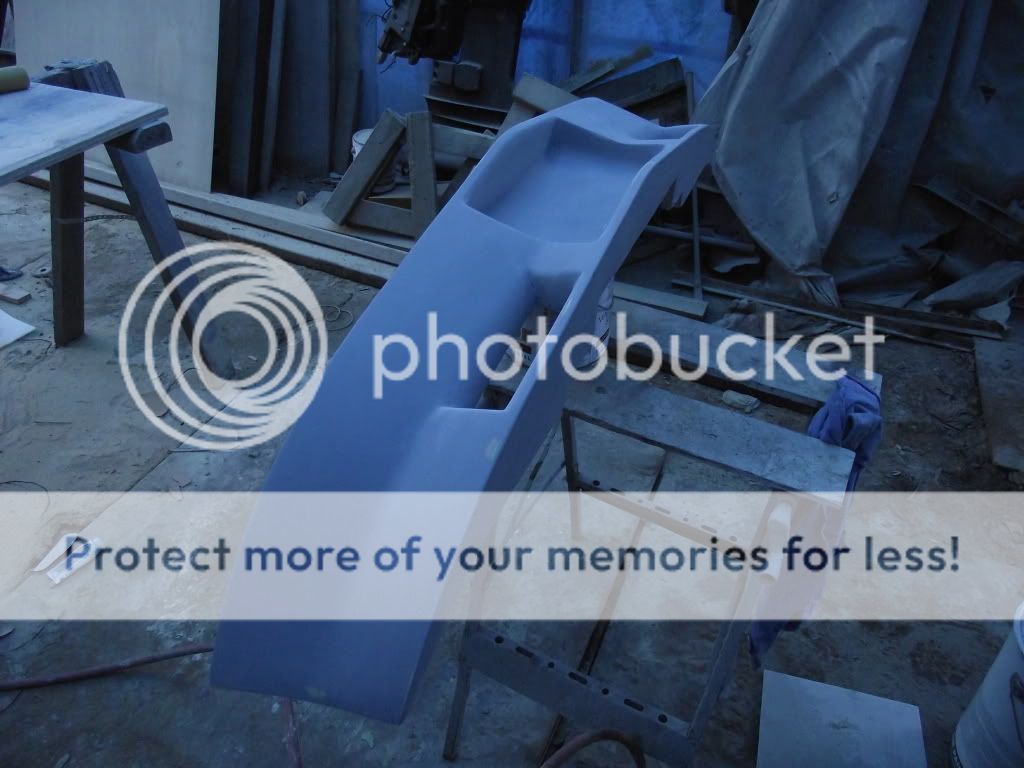

Looks damn good would never guess that was wood and bondo looks like fiberglass. I thought you were going to primer the whole car I read to far into that guess.
That's really impressive. Is that all hand sanded and what kind of bondo did you use? I'm always impressed by guys that can achieve that kind of a finish on parts like that, I don't have the patience. It's also going to be a fairly expensive piece by the time it's finished, just in material costs.
It's hard to primer the whole car when there is so much finish welding and sanding/smoothing to do, especially the hood...
He don't have as much into it as you would think.. 2 gallons of bondo, maybe half a sheet of plywood, can or two or primer and a couple sanding discs, less then $100 USD I'd say...

yup,that's a pretty fair estimate so far.throw in some sandpaper,glue,and fiber disks.
still have to put on the basecoat/clearcoat...then it's fiberglass suppies.but by far the biggest investment is time.probably 15 hours or more so far,and there's still a few to come.
the filler is napa's bodypro gold...it's a reasonable quality filler(and about the best i can get here without special ordering and paying through the nose)and shaping was done mostly by hand sanding,though the d/a was used some too.
there was a lot of time spent with a file on the inside of the lower vents to get the corners right.the inside of the licence plate recess took quite a while to get looking good too,outside surfaces are pretty easy.
I was thinking in terms of the whole thing. The mould will probably be the most expensive in terms of materials. Mat and resin are not cheap these days, and the mould will take quite a fair amount of both. I wasn't even thinking about the labour involved, that would be too scary.
this ones not too bad,as it's not very big.i'll probably use $100 worth of resin,$20 in matt,and $25 in gelcoat.as they get bigger(like a truck hood or something along those lines)the costs go up quickly.
once done,the first piece turned out of this will have a total cost in the $300-350 range...each after that about $50-60.
one other point at this time-and it's critical.
i was a little confused about svt's saying 'a couple of cans of primer'.while sanding the plug it hit me-he's referring to spray cans.
do NOT use any paint product that comes out of a spray can on a plug...if you do you've just wasted any time and money you've invested in the project.
my primer is an automotive grade urethane with a catalyst.the paint will also be automotive grade base clear.if you use spray paint,when you go to start glassing the solvents in the resin will cause the paint to wrinkle up,destroying the whole attempt.

so i got the sanding done on the primer.i went through in a few spots,but not enough to bother respraying.if this were on a finished body panel,these spots would eventually print through,but since this item will only last a few days it should be ok.
guess i'm ready for paint:icon_thumby:
