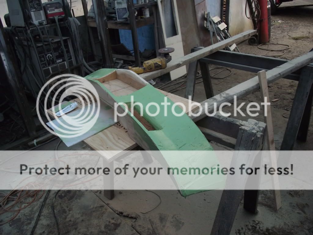

starting to layer the filler on.be prepared to go through lots of filler if you are going to try this.all the wood must be covered and since the filler layer will be about 1/4'' thick i expect to use about 2 gallons on this part.
Gt-12
be sure to build up the thickness in multiple layers,and sand periodically between them with a long board to keep the shape right.recessed areas are the hardest to get smooth,but patience and hard work will get it done.

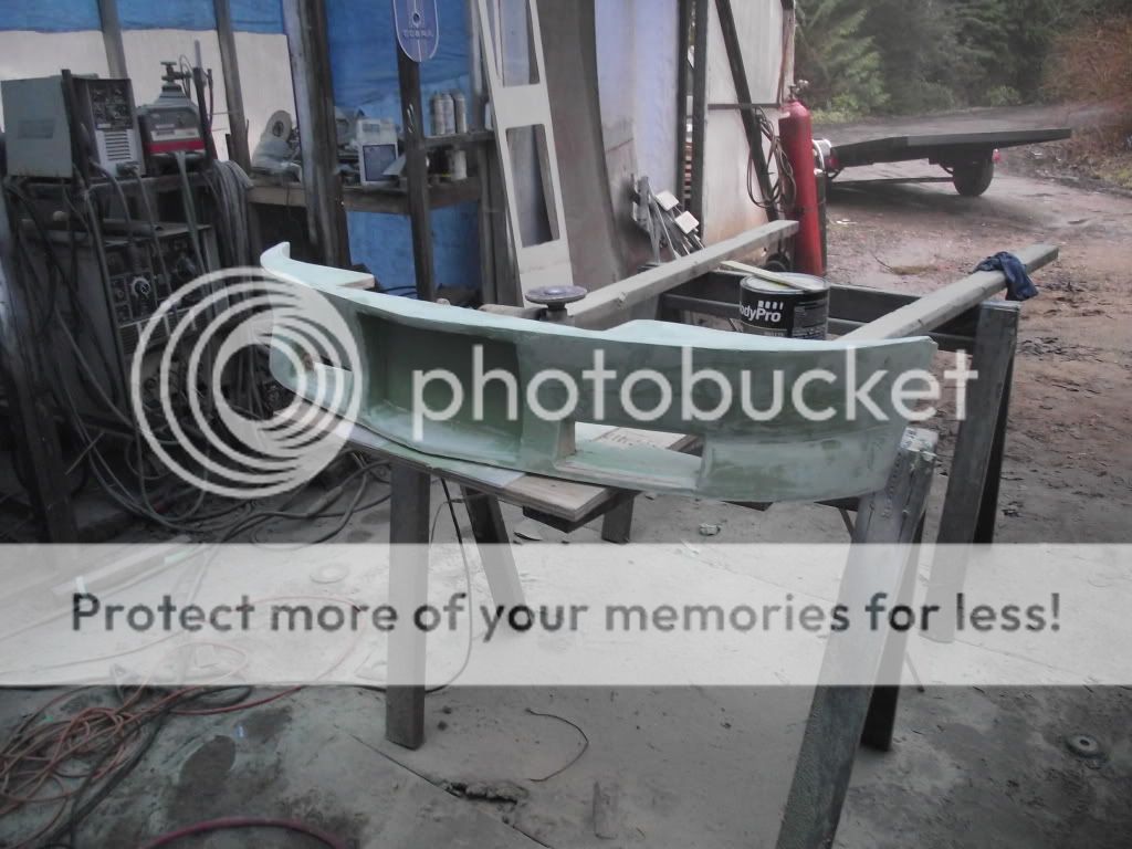

np....here's another.
Gt-12
after a bit of sanding(and lots more filler)it's getting to the shape i'm wanting.unfortunately i ran out of blue hardener for the filler and had to switch to red,so i've got a varigrated effect on it now...but that doesn't matter except for how pics look at this point.
i have some more detail work around the plate recess and the scoops,but it looks like i'm on track for priming tomorrow.

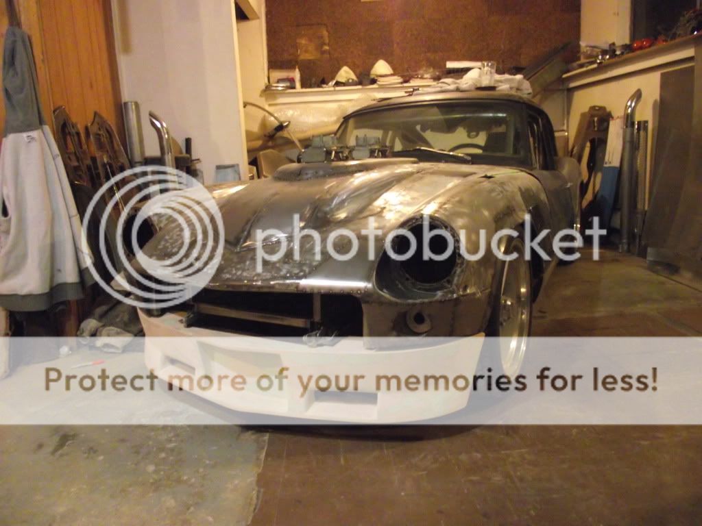

Can you post a better pic, mate? There seems to be a car blocking the view of the top.
Gt-12
Flat like this?
JESUS!!!! What are those??? Mosquito bites??:icon_confused::icon_confused:
who am i kidden? I'd still hit it.
oh yea, gwaii, the body kit looks great! :D
