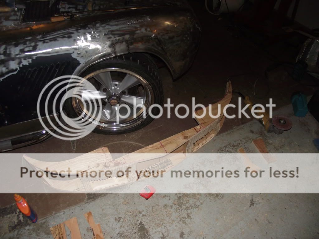

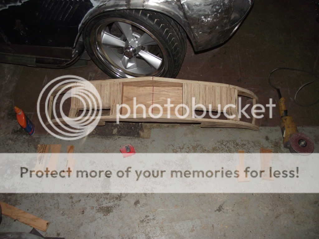

this is the beginning of making a plug.i'm using 3/4'' plywood as it's easy to work and has a very low moisture content.i'm making it by cutting a whole whack of profiles and glueing them together so i have the endgrain to carve-this is a more consistant grain for working.
i don't use nails or screws anywhere on this as i don't want to run into any metal while carving the wood.
the carving is roughed in with a grinder and a 24 grit fiber disk.
i carve the plug to rough shape and a little undersize,as the next step will be to use body filler over the wood to get the finish needed.
it's a good idea to check the fit regularly while making this as it would suck to get a nice mold made and have the final part not fit the car.

Might be an idea to make the part where the plate goes removeable, to aid in de-molding. You've probably already thought of that though.
actually the top and bottom plates will be molded seperately and added after the face is molded.
if i mold the plates on at the same time i won't be able to get in the tight space above and below the licence plate recess to roll out the air bubbles.

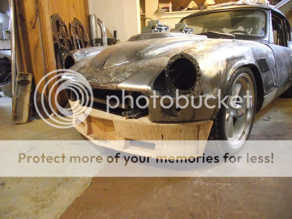

me too.the downside of doing it this way is waiting for glue to dry on the wood.i'll be able to do some shaping tomorrow when everything is solid.probably get the first layer of filler on,too.

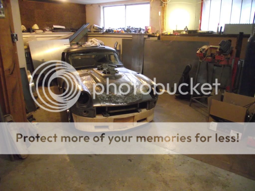

after getting all the laminating done,about 10 minutes with the grinder got it rough shaped.i still need to take the size down a little,it has to be about 1/4'' undersize all over to make room for filler.the wood is just a backing,the filler will be finished out to shape,then primer and paint as with normal bodywork.like i said before,the plug must be an exact representation of the desired product...right down to the gloss.
