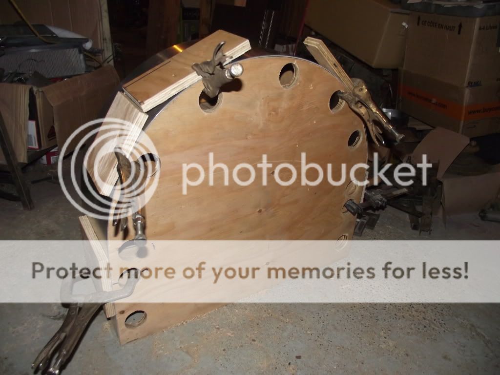

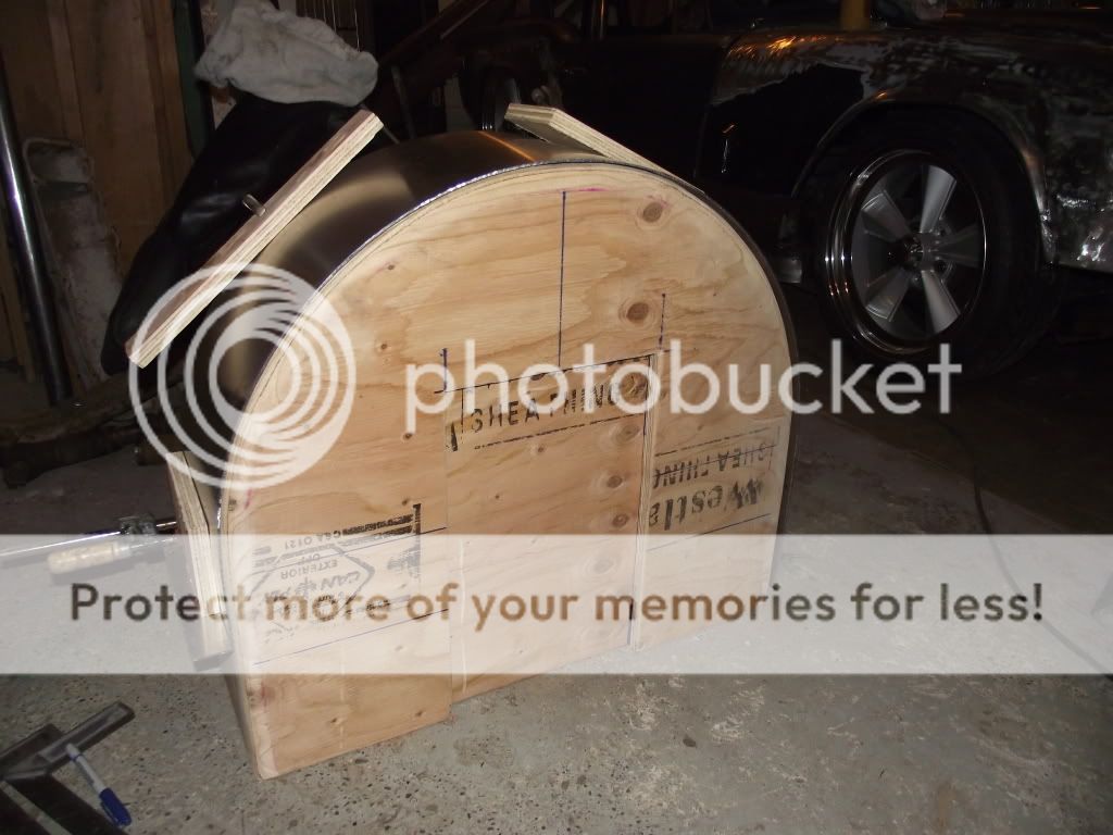

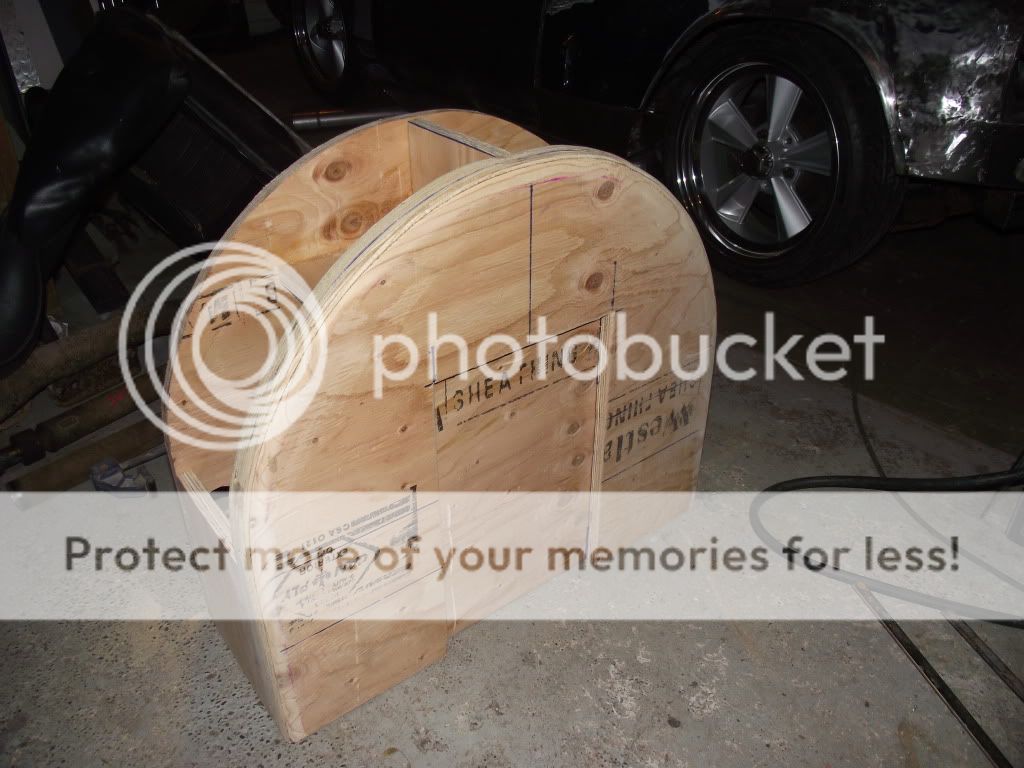

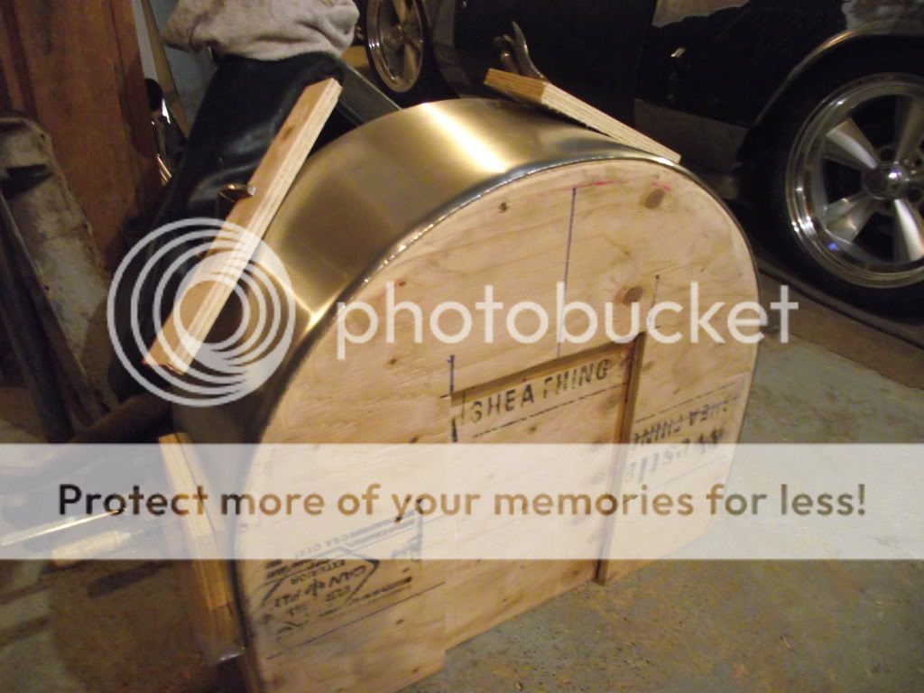

well,i went a bit further with my cabinet making skills.
Gt-12
got the edge rounded off,ready to use.
Gt-12
some aluminum clamped on,ready to start whacking.
Gt-12
from the back you can see how i just drilled some holes to clamp through.
Gt-12
tapping the edge down didn't take long.now i have to cut out a piece for the face,and round it's edge off.then the two pieces need to be fitted perfectly together,then welded.the welds will be smoothed out,leaving a nice rounded edge.

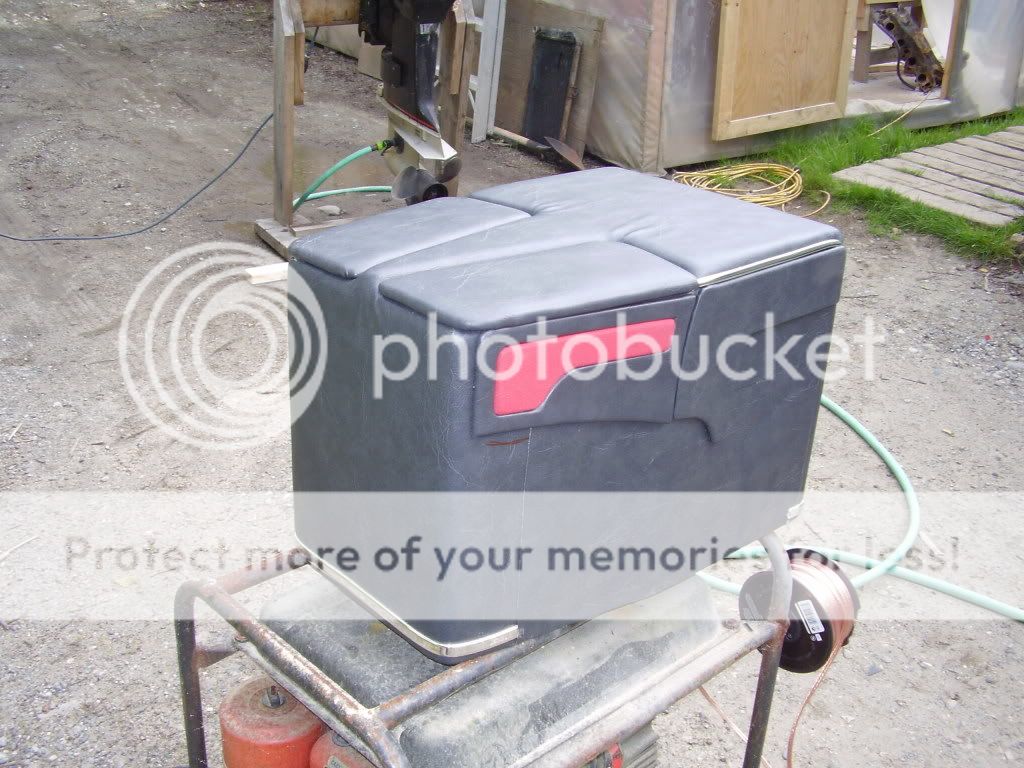

Have you ever thought about being a clock-maker?
Gt-12
You're already halfway there!
hey!they copied me!
copyright infringement!(guess i should get a copyright)
