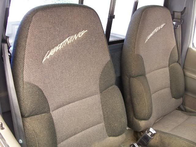

Spending all my time parting out my Lightning but I decided to keep the seats for my Ranger. Sold the racing buckets and bolted in the Lightning high backs... mmmmm comfy!
Spent 14+ years in that drivers seat covering 209,000 miles so it just feels right. Easier to get in and out of too and with the power side bolsters they'll keep me in place going through the twisties. Pics coming...

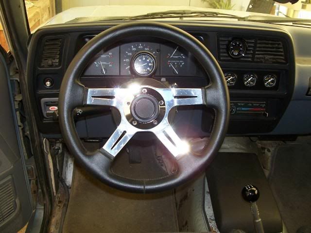

Currently working on auxillary gauges and lighting controls. Still waiting on caliper brackets and decent weather so I can sandblast and paint the steering knuckles/spindles and the driveshaft. That's all for now, I know... still need to post pics...

I finally took a few pics, here they are...
