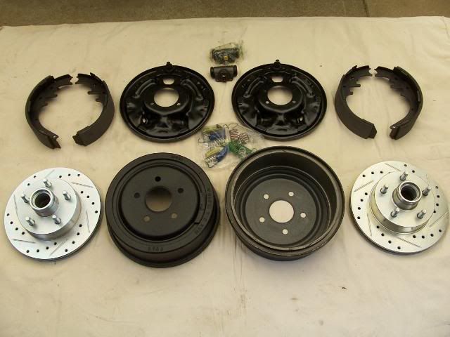

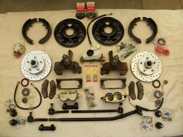

Here are a couple parts pics...
Goodbye 2.3 4 cylinder...
The elusive 2wd bracket, note part #...
Here you get a sense of the 10" drums size...
I LIKE the new rotors!!!
Mike
So based on the info I read in the links I should be heading in the right direction.
By removing weight from the front, (lighter motor), and adding weight to the rear, (bed cover) I am helping create a front bias condition. I should say adding to the assumed 5 to 10 percent of front bias already present, factory designed for stable braking.
The "cure" for added front bias is to increase the effectiveness of the rear brakes as in upgrading to the 10" drums with wider shoes. The front brake upgrade should add efficiency and better cooling while retaining the same diameter rotor as the original.
In extreme heavy braking the increased load on the front axle from weight transfer should be where the drilled/slotted rotors really make a critical difference due to better heat dissipation.
Hey, it's no race car but I think the braking performance will be acceptable. I have no "before" to compare to the "after" since I trailered the truck home and never drove it. It will be interesting to see how it all operates together.
One nice thing about these upgrades is that, except for the drilled slotted rotor surfaces, these are factory components which are designed to work together for the vehicle in question. Hopefully that will mean successful consistent performance.
Mike
