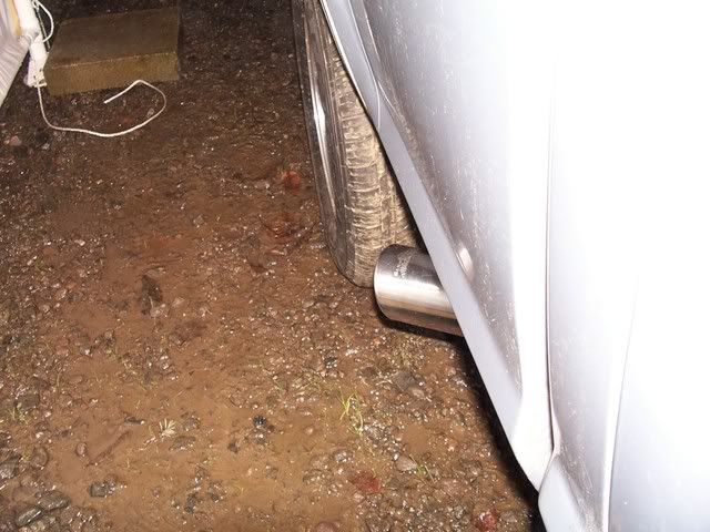

Simplified the exhaust layout to save time, trouble, weight and $$$.
Still a 2 into 1 via the stainless Magnaflow Y , ( 2@ 2 1/2" into 1 @ 3").
I have the Y and 3" Catco convertor welded together occupying the space the factory cat was in, works great with the factory floorpan heat sheilding.
The Thrush muffler is welded directly to the cat and has a steel hanger I fabbed welded to the outlet pipe that fits the factory dual rubber hanger.
The 3" tailpipe is welded to the muffler and has about a 47* bend which points it out just ahead of the spring hanger and exits through the Pilot Motorsports 3 1/2" tip just ahead of the rear passenger side tire.
I think it looks pretty cool, I just have to fab a hanger for the tailpipe at the frame rail then all that's left is the downpipes from the headers merging into the Y. I'll get those done once the motor is bolted back in.

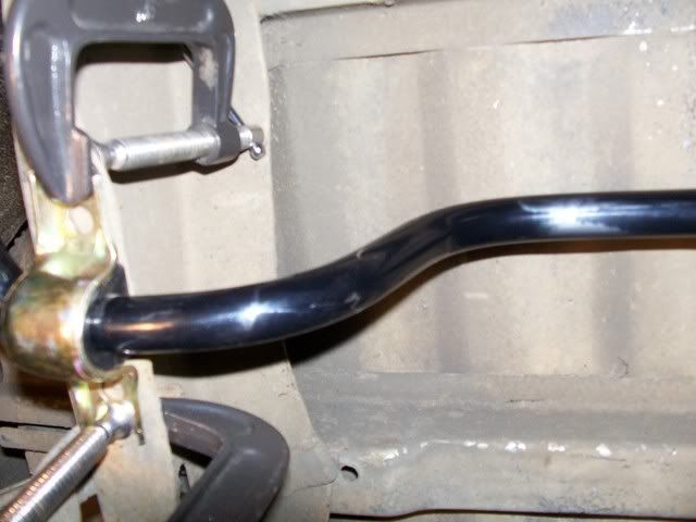

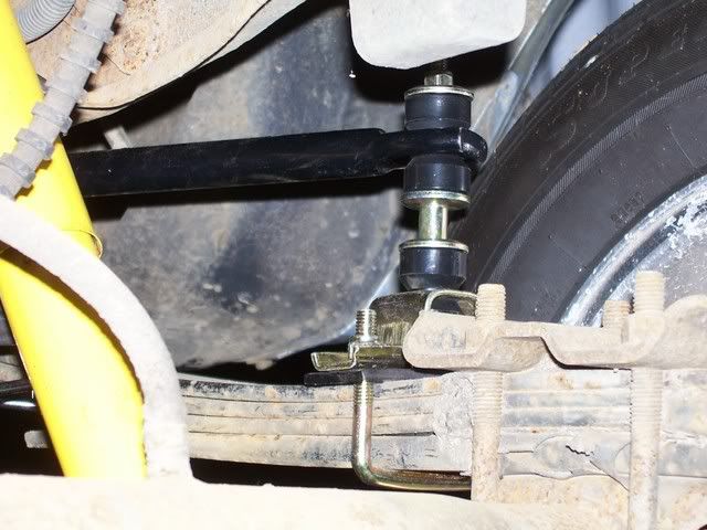

I did get my rear sway bar mostly installed last night after work, just need to drill four holes in the frame and install the bolts/nuts through the bushing brackets which are C-clamped in position.
It's a nice bar, powder coated gloss black. Sure can tell the difference, makes the leaf springs work together and greatly reduced the side to side body roll when I try to rock the bed standing in back.
The directions were confusing and the diagram was obviously not for my application but I figured it out. Would've went much quicker with the correct instructions and diagram...
