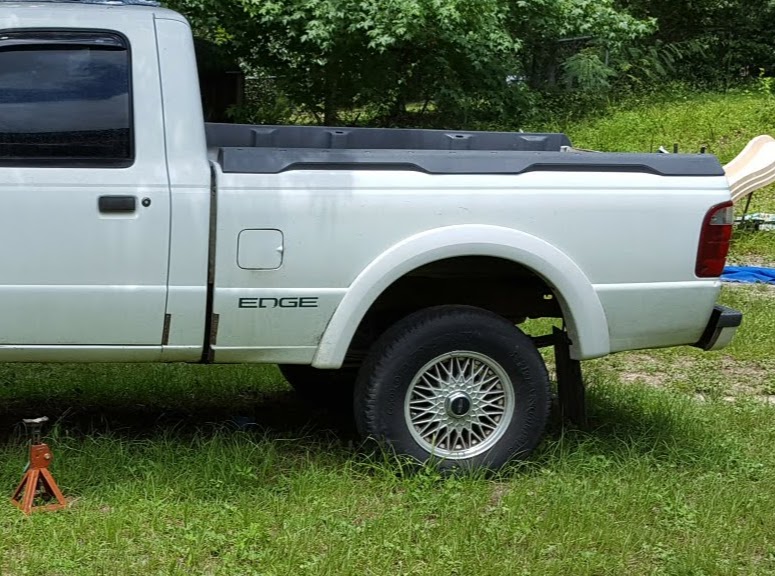

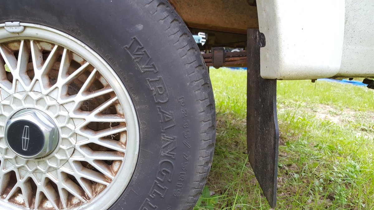

Going the other way with gears
Man, those lincoln wheels look good on the truck. I need to find aome for my truck
The wheels do fit that truck well, but not the style I'm aiming for. I'll be on 16s minimum and there's only one set of Ranger wheels I'd consider.
