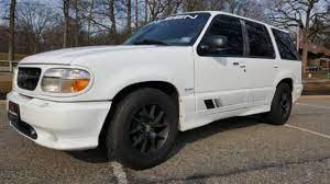

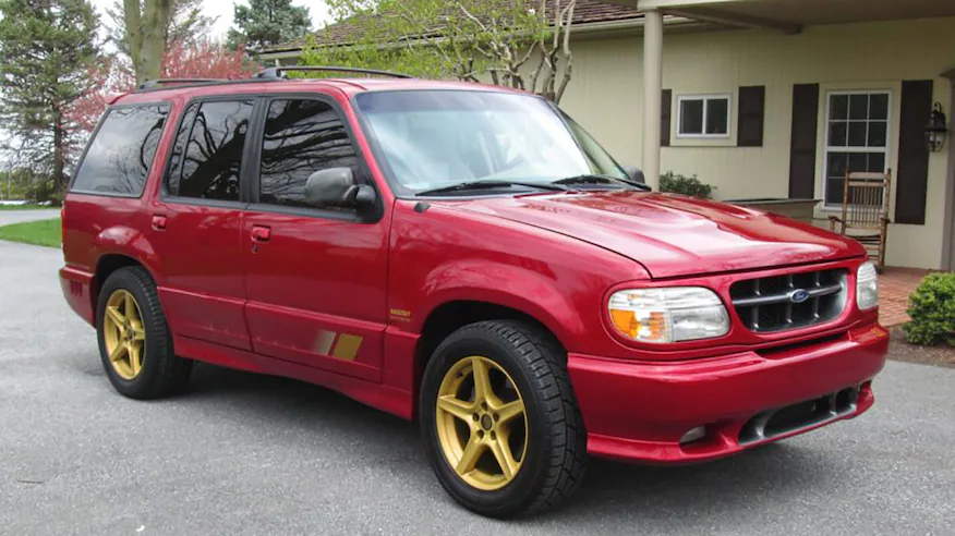

Saleen xp8
Saleen xp6
Saleen xp8 supercharged
this ^^^^Sounds like my end goal. When I finish, I hope to have an AWD Single Cab Ranger 5.0. I'm using a '01 Edge as my base and a '00 awd Eddie Bauer Explorer for the donor.
Visually that white one is closest to what I'm after, except Ranger and without the Saleen pieces.
