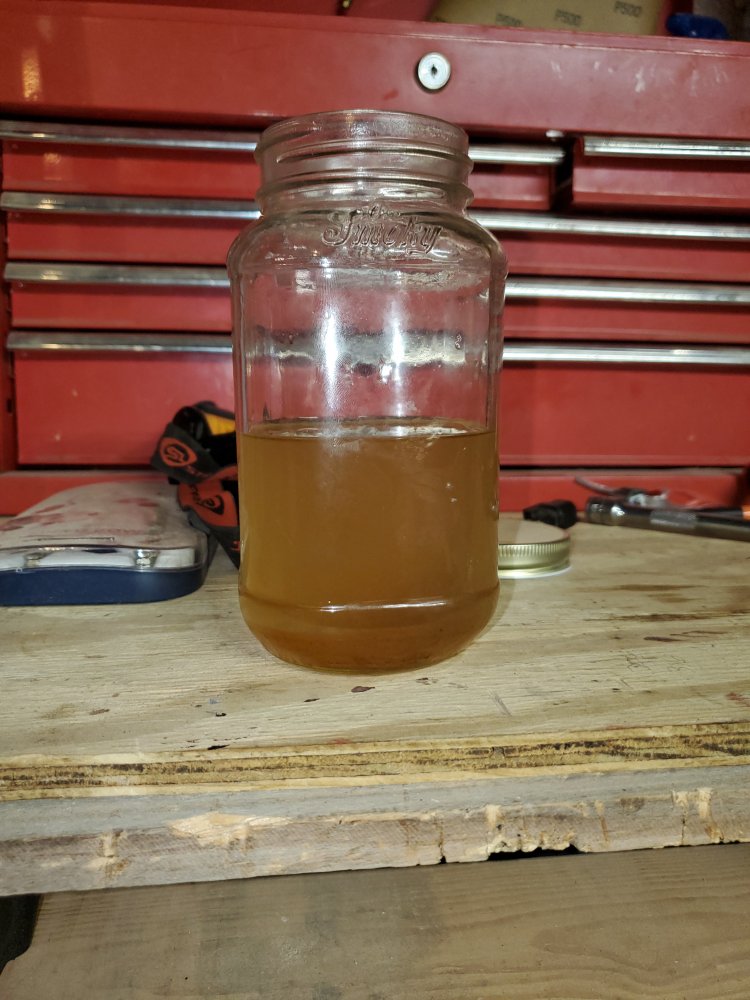

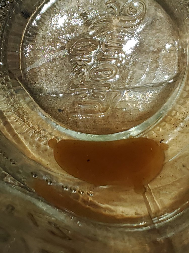

So, I changed out the plugs again this morning. Also the new injectors came in. I removed the old ones I had on the fuel rail and this is gas that came out. I assume it's oil, but how in the hell is oil in the fuel rail. If this ain't oil then what is it. Bigger question is WTF do I do about it. Not going to put the new injectors in till this is figured out that's for certain
68087
Is this dirty gas or did someone put something in my fuel tank?? I have a fuel filter coming too, but not going in till this is answered DEFINITELY

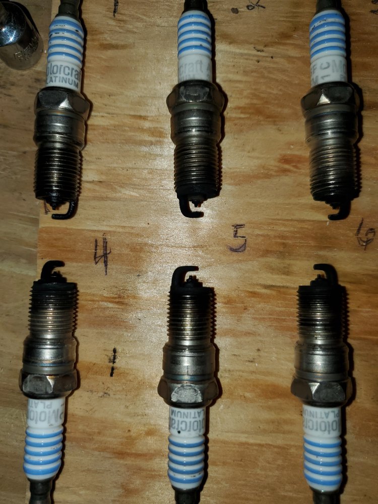

These plugs are 2 months old and have been mostly used during all of this. I've pulled them twice and cleaned them. This was what they looked like this morning. #1 & #5 were saturated. The other were dry

I would pull the fuel filter and put a container under the Fuel Pump OUT hose, then hot wire/jumper the fuel pump relay to pump out some fuel from the tank
Key on and off a few times might get enough fuel, then put it in a glass/see thru container
To see if its the gasoline in the tank
You may have been Pranked
Ok I'll do that. New filter should be here tomorrow anyway. What does it look like to you Ron??
Looks like dirty water or old gasoline
Water is heavier than gasoline so settles to bottom in a container
Picture here of water and gas, water is at the BOTTOM of container: https://qph.fs.quoracdn.net/main-qimg-d77d5add0f877780961a6611d265e109.webp
Looks similar to what you see
While fuel rail is out blow it out maybe put some cleaner in it, let it sit and blow it out again
Do the same with fuel line from filter to Rail when filter is off
Yes sir will do. I'm going to just do to full gusto... drain and drop the tank, pull the fuel pump, clean it best I can and replace with a new pump as well. This is a cycles of the key and it sitting for about 15 mins.
