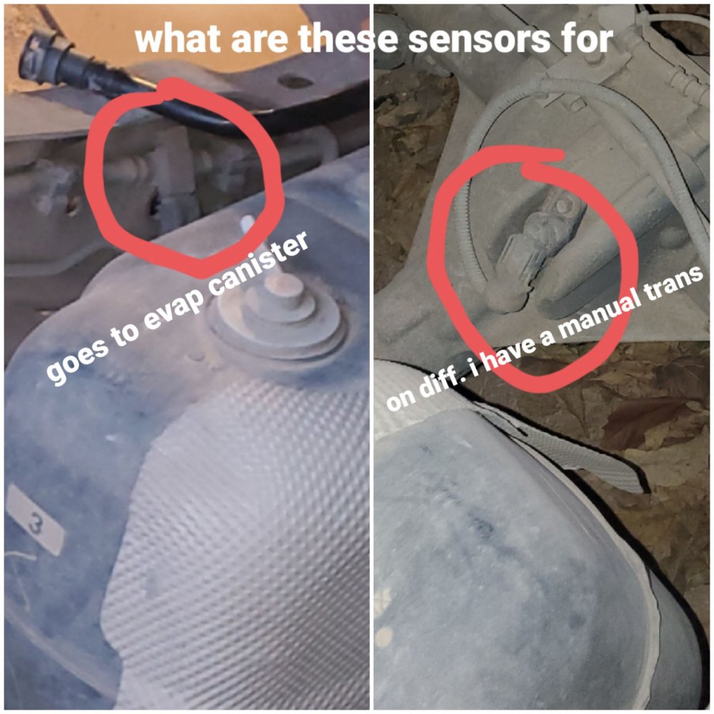

Ok so I needed to take the bed off to drain the tank. I opted to purchase a new fuel pump since I'm there. Kinda hoping to get the gas leak fixed as well. I'm not sure what it is a I've already replaced the filler hose. There's also a broken plastic fitting going to the evap canister that I need to replace. This leads me to a question. Just what are these two sensors??

The sensor on the left looks like the FTP (Fuel Tank Pressure) sensor.
The sensor on the right is the rear axle's speed sensor (allowing the ABS module to know and report the speed of the rear wheels).
So would the ABS sensor effect my speedometer. It reads about 15mph slower than actual vehicle speed
No, rear axle VSS wouldn't effect speedometer in 2003 Ranger
ABS is a separate system
In 1998-2000 Rangers rear axle ABS VSS was used with GEM for speedometer, but only those years
2003 uses an OSS(output shaft speed) sensor for speedometer, manual or automatic, its at the rear driver's side of trans just before tail shaft housing, 2 wire sensor
Tire size and rear axle ratio effects speedometer/odometer, larger diameter tires shows slower speed than actual, also less miles traveled on odo
It can be re-calibrated using Forscan software, or you can pay Ford dealer to do it

There's been some disagreement about this in various threads. Some have said that the rear axle speed sensor provides the VSS (Vehicle Speed Sensor) signal but I'm not sure if that's always the case. I think that the value reported by the PCM as "VSS" can also be "synthesized" from a transmission shaft speed signal (and, in the case of 4WD, the '4x4 LO' signal). I suspect that the speedometer is driven by the same signal that the PCM reports as "VSS", but (A) I'm not certain of that and (B) there are enough differences in the various Rangers / Mazdas, based on things like Model Year, 2WD versus 4WD, manual versus automatic transmission, that I'm unwilling to say things with too much authority.
Being me, I'd use FORScan and compare the VSS output to the ABS report of rear axle speed. That's the fastest and easiest way. And of course, compare both to my (human-read :)) speedometer.
EDIT: Looks like RonD beat me to it and with a more-definitive answer. :)
