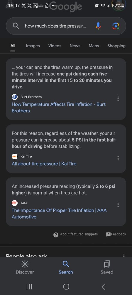

The danger of the heat isn't pressure. The pressure increase from heat due to driving is negligible. The danger is breaking down the rubber and weakening the structural integrity of the tire.
I remember track tires on the Fiesta you'd air them to be what you wanted hot not cold so maybe start cold 32 psi then check them after running and they'd be like 45 or something.
Might go up to 35. But that would be pretty extreme.
You sure? Maybe my memory on it is shot, entirely possible.
Here. I just asked Google for confirmation.

Ok. For race tires it could increase say 8 so maybe if I had (Fiesta) set them at 32 and they were 40 hot that's possible. For sure I remember they were telling me you measure them cold and you also measure them hot (for track).
Interesting to get some quantifiable info around it.
