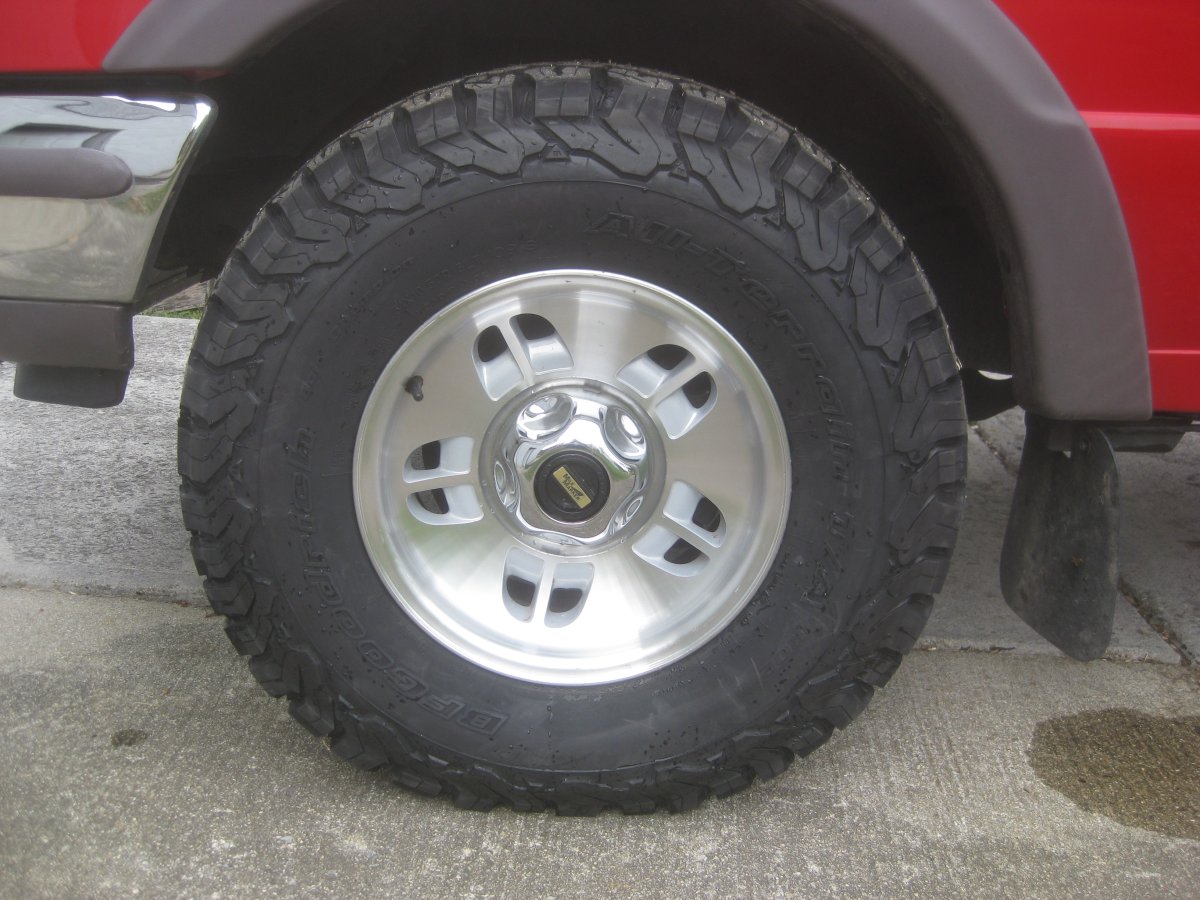

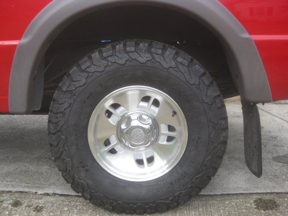

I finally got the tires on so it's back to oem configuration. Totally changed the truck for the better. To me it almost looks raised but it's not. Rear diff clearance 8-3/4", front diff 7-3/4". Door sill plate is at 21-1/2" so that's quite a step. It probably raised it a good 1-1/2" anyway which doesn't sound like much but I really see it compared to before.

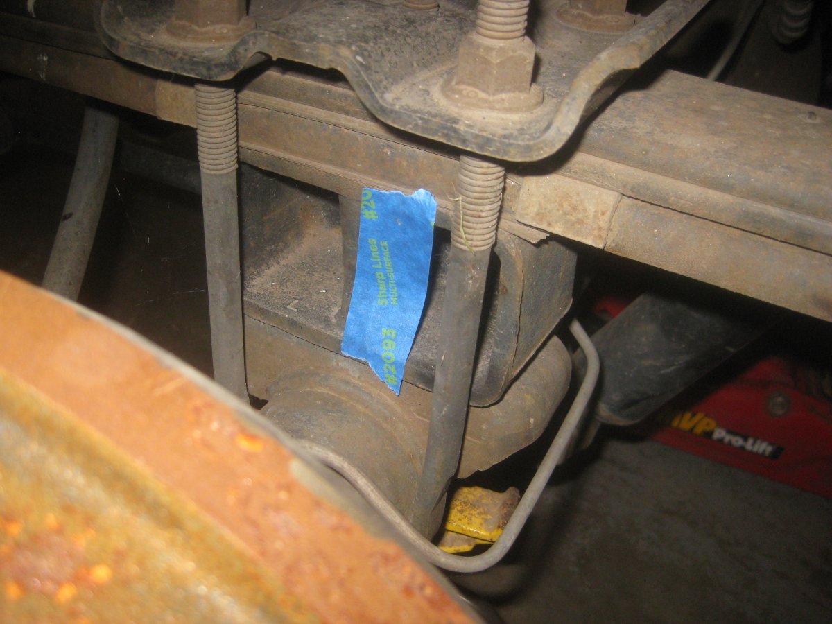

Even though technically it's not raised, there's a 3" steel block in there. The blue tape is 3" long. If I set it next to the '99 rwd it's quite a bit higher.
Add to that 31x10.5R15s are a pretty large tire for Ranger

So, first drive, checked speedo vs gps, reads 35 going 34, reads 45 going 44.5, reads 55, going 55, reads 60, going 60. So not reading high any more and not reading low which you wouldn't want. I found best way to get a reading is a nice level stretch of road then set the speed control, it keeps it even.
To me that confirms, that's what the truck came with as to tire size. Before it was reading 5 to 6 mph high with the 235's.
Not noisy, maybe can hear a little bit but you'd have to try.
Didn't feel any vibration up to 60, sometime I'll try at 70 and normally I'd never even get to 70 although I know if I ever went around Atlanta they drive 85 or used to anyways.

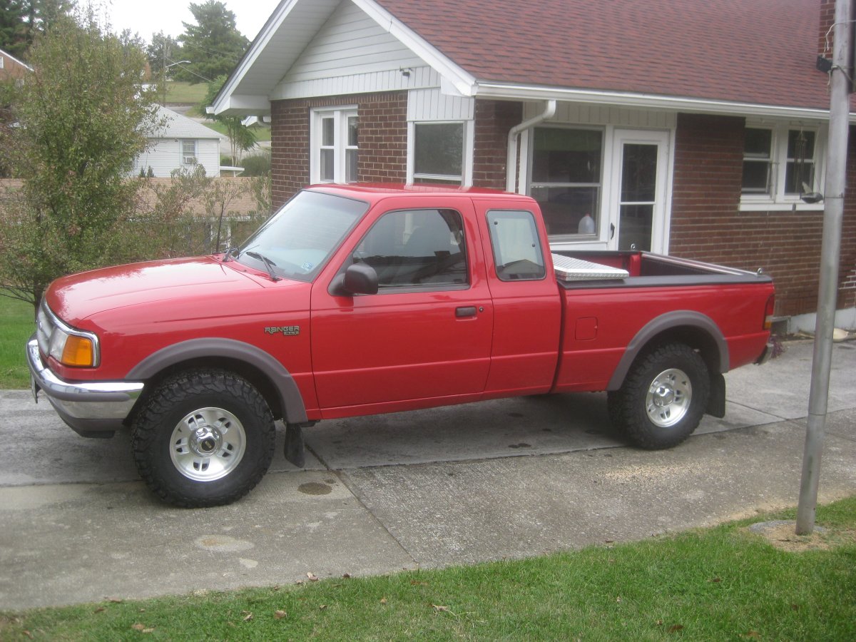

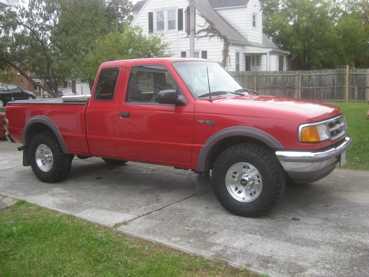

I was next to a newer (current gen I'd say) Ranger Lariat Supercab at a light and it looked to be the same height maybe very slightly lower. For what that's worth, nothing I guess.
Looking at it in the parking lot there's a lot of daylight underneath. It's definitely higher than it was, noticeably.
So like people said when I was originally scoping out what truck to get, that one out of the box is already pretty capable for light to moderate off road. Also in that '97 you were getting skid plates which later you had to option or get FX model.

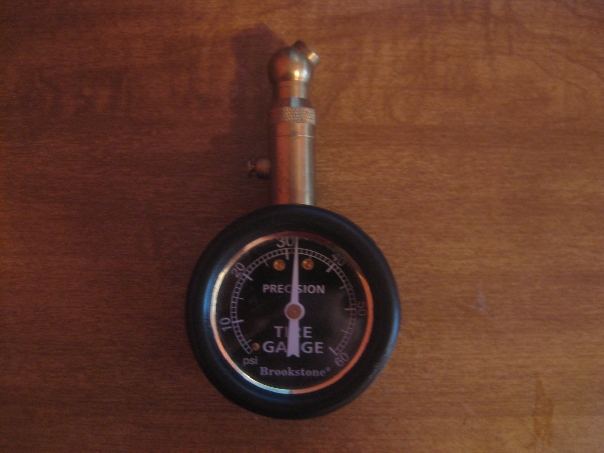

My good pressure gauge lost the little insert that seals it against the stem so I went and got another at Auto Zone it's crappy. I mean, maybe it's kind of ok, but the indicator just comes out like 1/2" for the 30 lb range and my old one comes out like a couple inches or something to me the latter is easier to read and just seems like it'd be more accurate. Made a tiny leather washer and fixed the old one, gonna return the crappy one. I used to like having a couple -good- ones then I'd check them against each other to make sure there's no huge discrepancy.

This one gives consistent results I think it's accurate. The other ones generally read the same but I don't get consistent readings or they don't agree.
It's kind of neat it has a button you can release air. It holds the reading. Vicky picked it up at Goodwill a while back but I hadn't tried it and it seems good.
