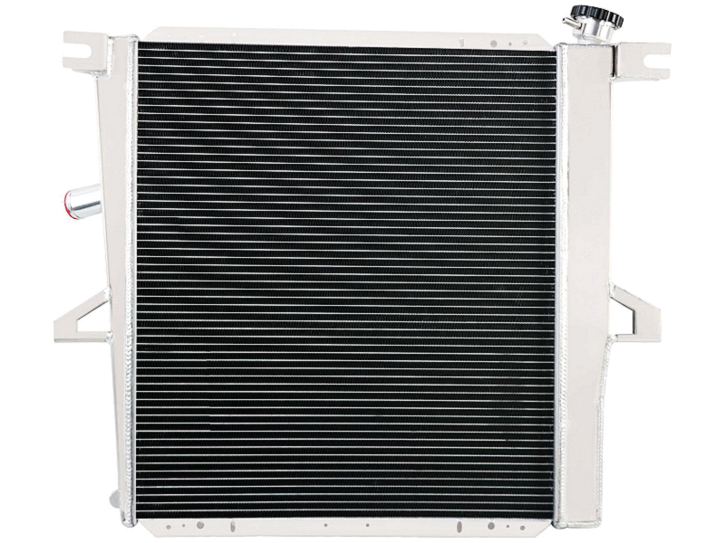

The '91-94 Explorer dual core fits my '92 just fine. Is that what you are using?
I'm seeing several options on RockAuto for 2 core (technically they say '2 core equivalent') that are about 2.25 inches thick when selecting a '97 Ranger 4.0. All of them have 1721 in the part number. The thinner radiators have 1722 instead.
Rockauto search results
I'll give that a look, thanks!

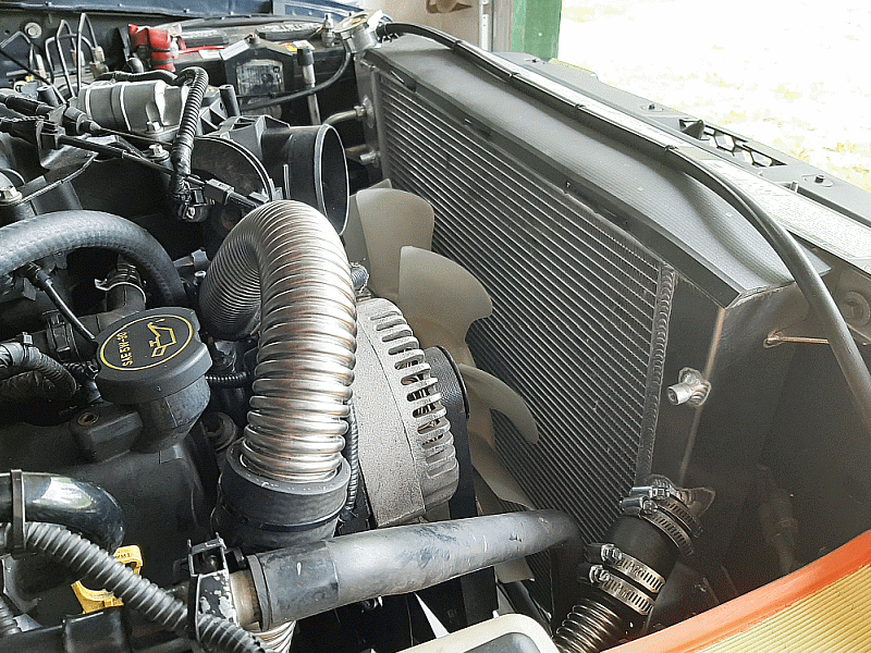

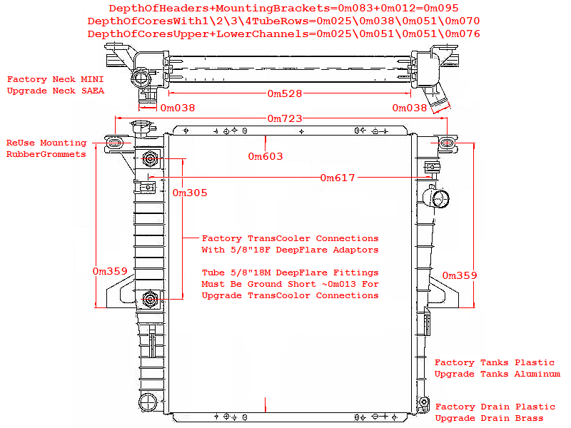

Best thing I've ever done for my truck is get rid that
factory junk PlasticTanked 2RowCore Radiator + stock 1.5"RubberHoses,
replaced it with an AllAluminum 4RowCore Radiator + 1.5"SSFlexHoses.
