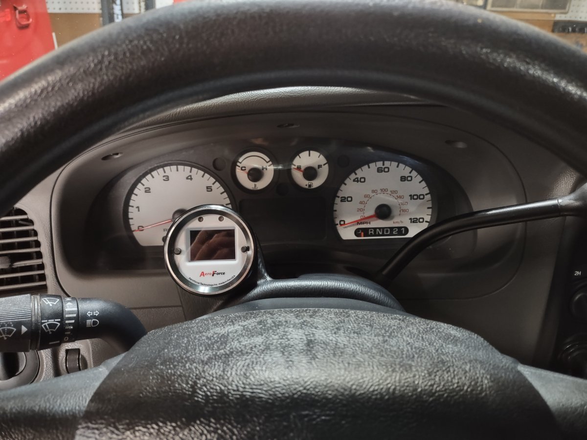

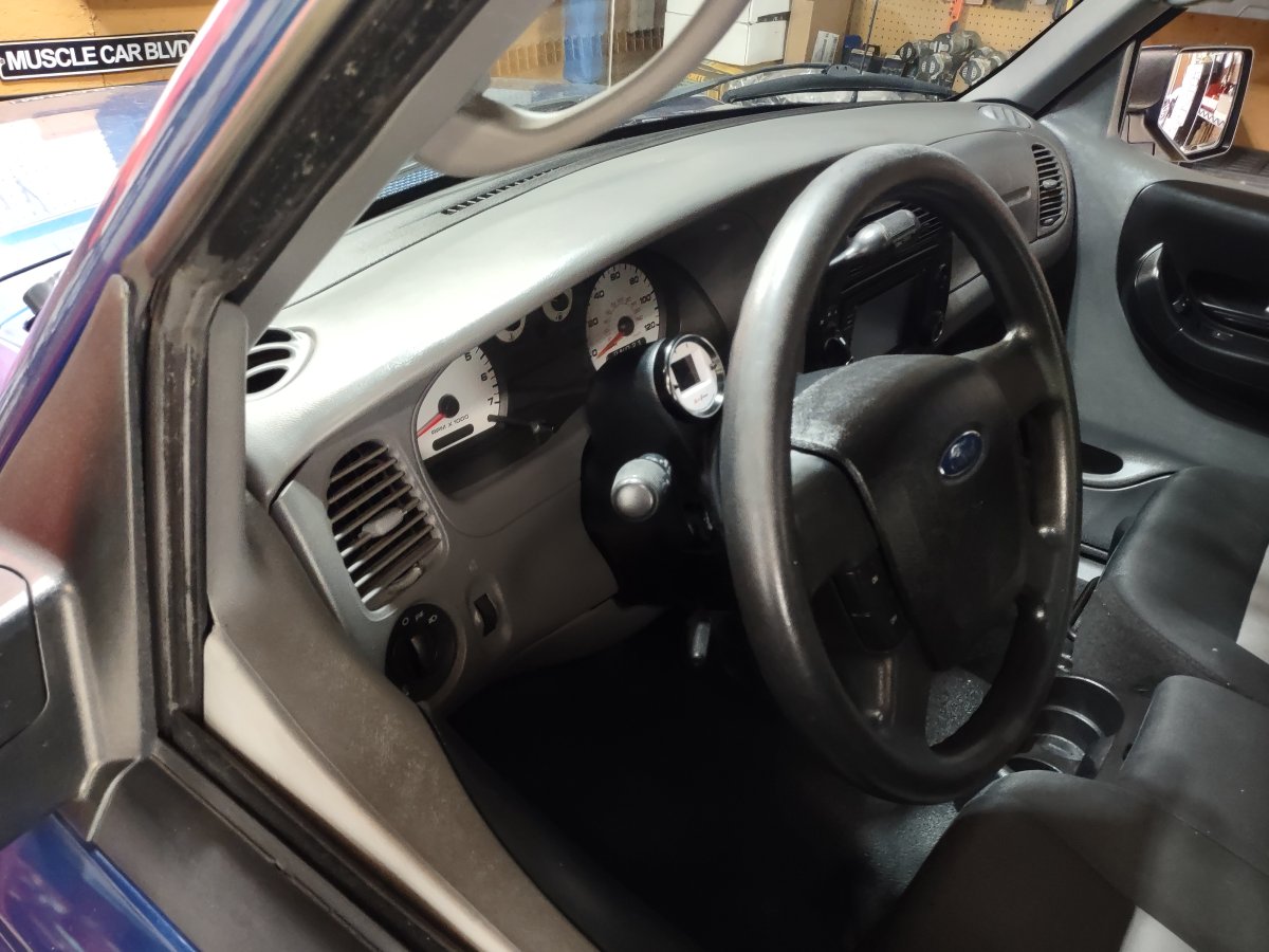

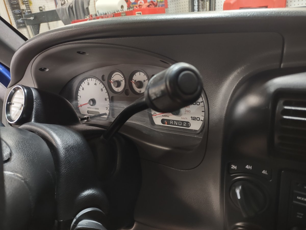

I had a unused Aero Force OBD2 gauge left over from a Mustang build, so I put it in the 2008 Ranger. Did a little looking around (thanks!) and the Auto Meter column mount gauge pod p/n 15004 (listed for 1997-2001 F-150) does fit. Its not 100% perfect, but very passable. I'm a little picky about looks & this is good enough. I had been using a cheap $50 Amazon "tack on" OBD2 gauge for gauges, but the Aero Force gauge is top notch & has access to everything the computer sees. It even has a analog input for my AFR gauge. If anyone is looking, p/n CNF101 works on this gen Rangers.
Check it out!
