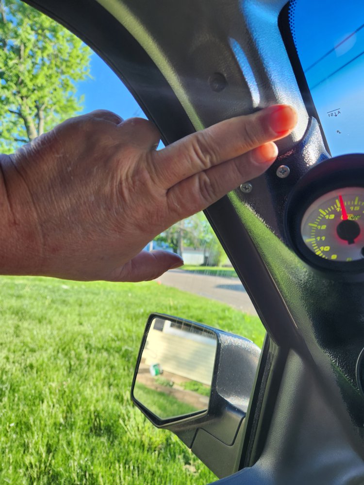

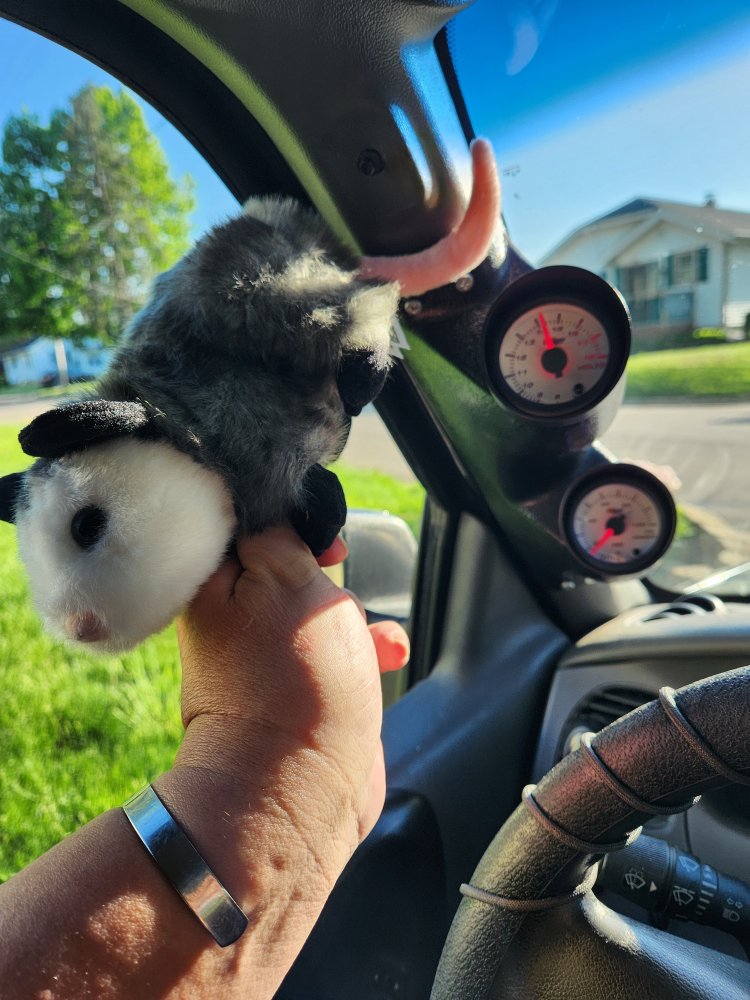

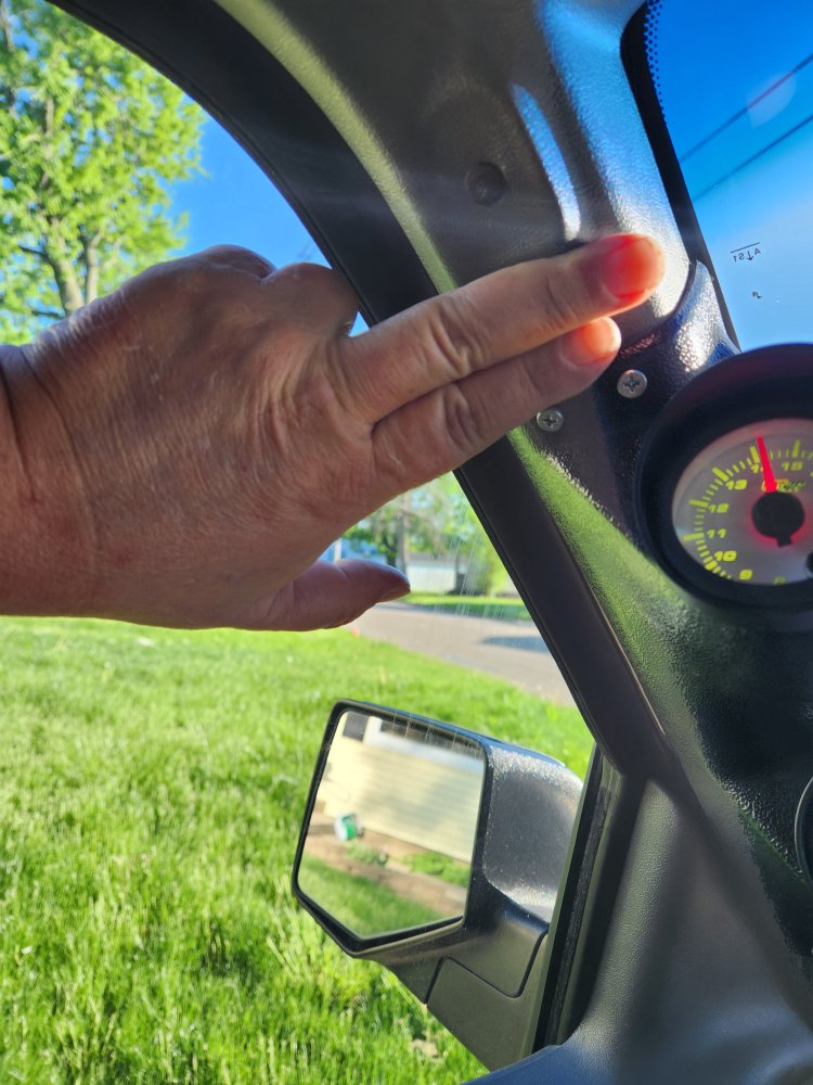

But it's about two opossum tails down from the upper handle boss on the a pillar trim.
Or about two fingers below...
And two fingers above the dash...
It keeps enough air moving across the driver glass to keep it clear for me.

I assume that the fingers are Standard; is the possum Metric or Standard?
It speaks Romulan... so however they measure.

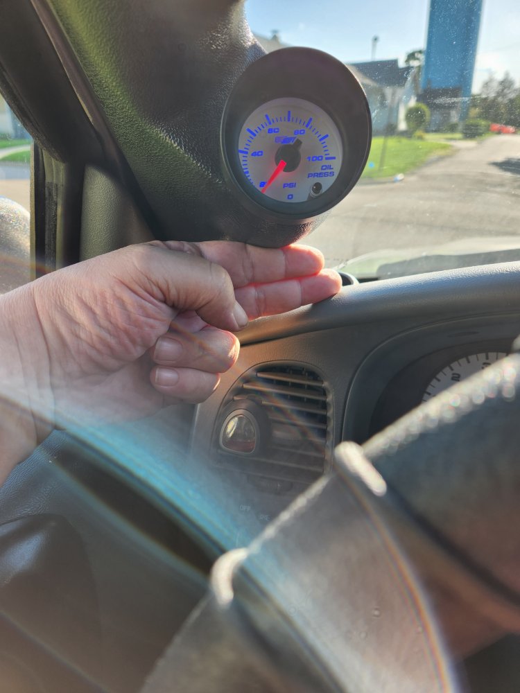

Mine is 1/4" from the dash. I slid it down as far as possible. I can easily read the bottom gauge. The top one is not as direct. I little bit of the bottom of the gauge is obscured. If it were any higher, It would probably be blocked even more. The fist pic shows how far down I mounted it. The second one shows my line of sight to the gauges when sitting in the driver's seat.
