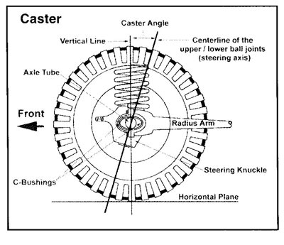

What is your castor set at? 99% of the time, this was completely disregarded in an effort to "get a good pinion angle". Castor should be the number one concern when setting up the axle.
I'm not really sure what my caster angle is, i just I balled it when i was doing my axle. It wouldn't doubt it being around 10*. Which as i read was bad it needs to be closer to 2*. Also yes, i was focusing mostly on the pinion angle when i welded perches on.

Positive or negative?
I would shoot for 4-6° of positive caster (tipped back towards the rear of the truck).
<----Negative- -Positive---->

I went and looked at my truck after work today just so i could double check. It looks to have about an 8* positive caster.
