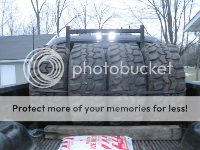

Well, i dont know how, but by word of mouth, i scored another set of 36x14.50 TSL Radials. This set has about 90% left. So now i have 8 36" TSL Radials. They are wider than i wanted, but i could not pass up the deal. So i now have 6 Good tires and 2 eh ones. I am trying to sell 2 as spares and i am going to keep 2 as spares.

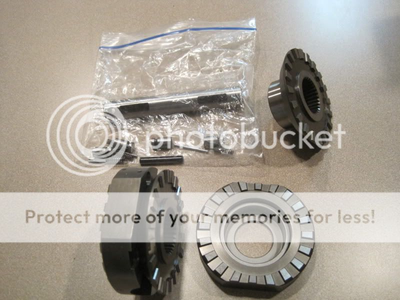

My locker came in as well and is now installed.

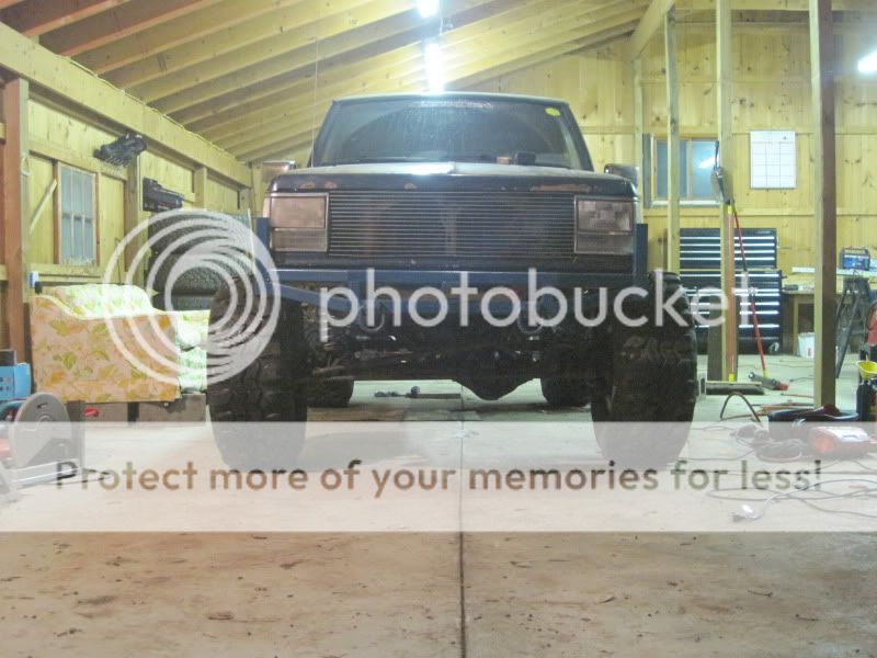

The 36s mounted!

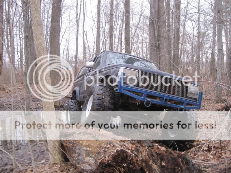

Did some testing on Sunday. First day out on 36s.
The new rear leafs dont really like to work haha
I do need to stiffen the rear springs so the front does more work. You will see what i mean in the pics below.

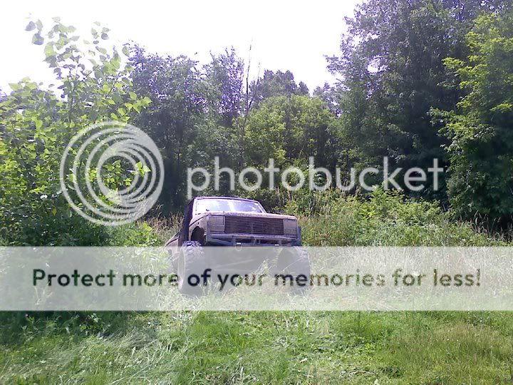

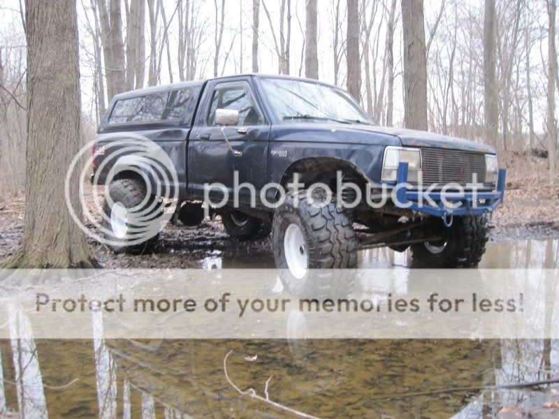

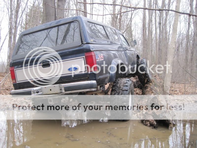

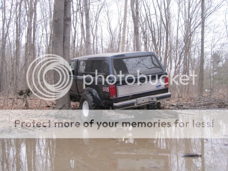

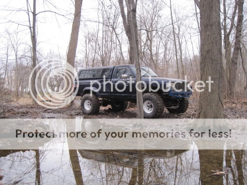

Just some pictures i took on my property. 2 feet of snow just melted so it was soggy. The wide tires and the light Ranger work well in this situation.
Sorry, a lot of pics i know. Cant help it sometimes. I was stoked at the time.

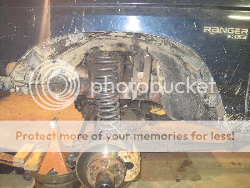

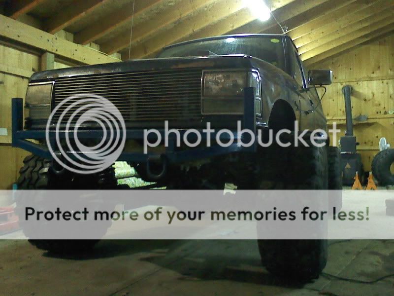

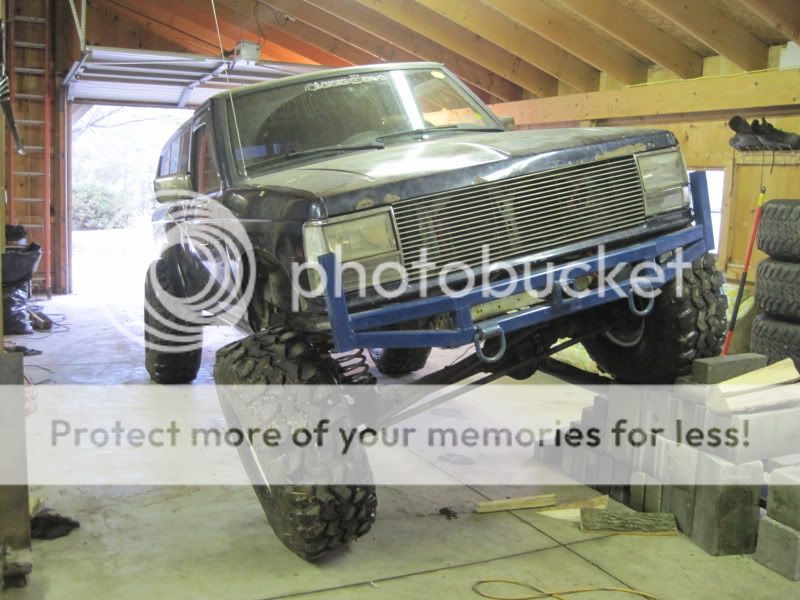

Doing some final shock measurements
I could take it farther, but in the garage i didnt want to.

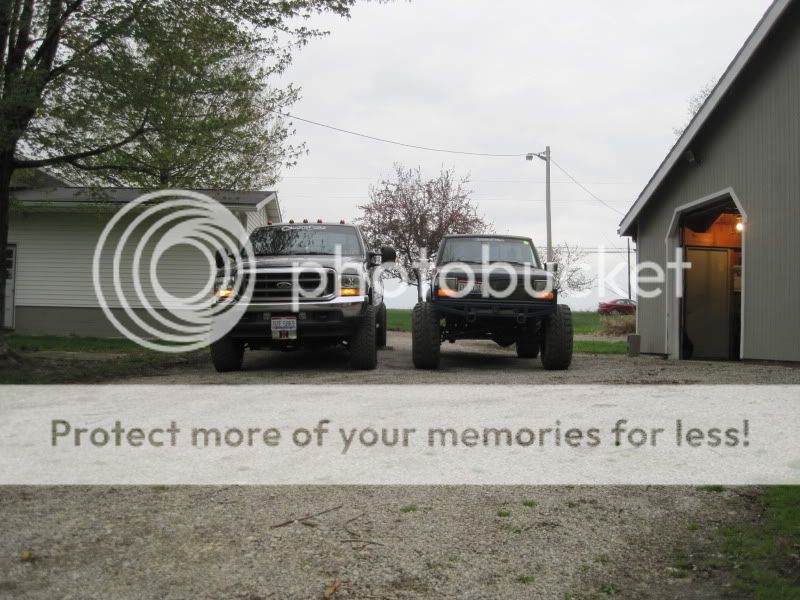

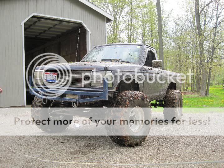

The I installed the drivers shock tower. I also put my 2003 F350 shocks on the front of it. The travel is perfect as well as the stiffness for 190lb/in coils.
As it sits now. Almost road ready!

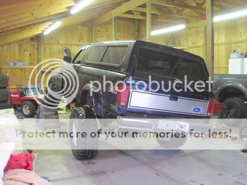

looks like you need to trim the rear some more but other then that it looks sick. but i do prefer wide tires
i would be puttin those 36's on that superduty :headbang:
The Bed is going bye bye. Know anyone that wants to buy a cap?? $80 lol
I like the wide tires until i am on a snowy highway. Then they suck lol
McCracken said:
Iwould be puttin those 36's on that superduty
Maybe some day. I run 35s now (32s in winter) but would love to do a 6" lift and 37s lol. I would need to go to 4.10s at that point. Thats whats holdin me back.

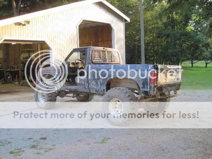

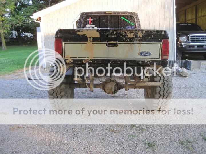

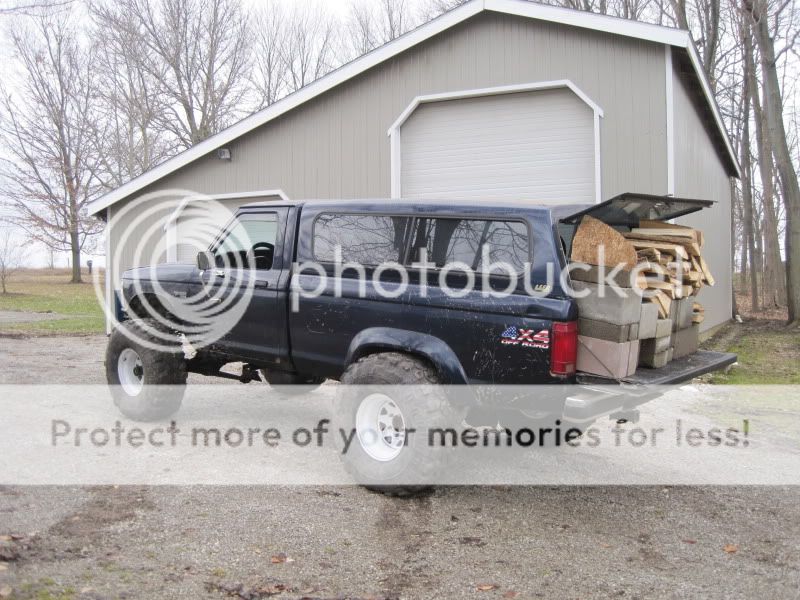

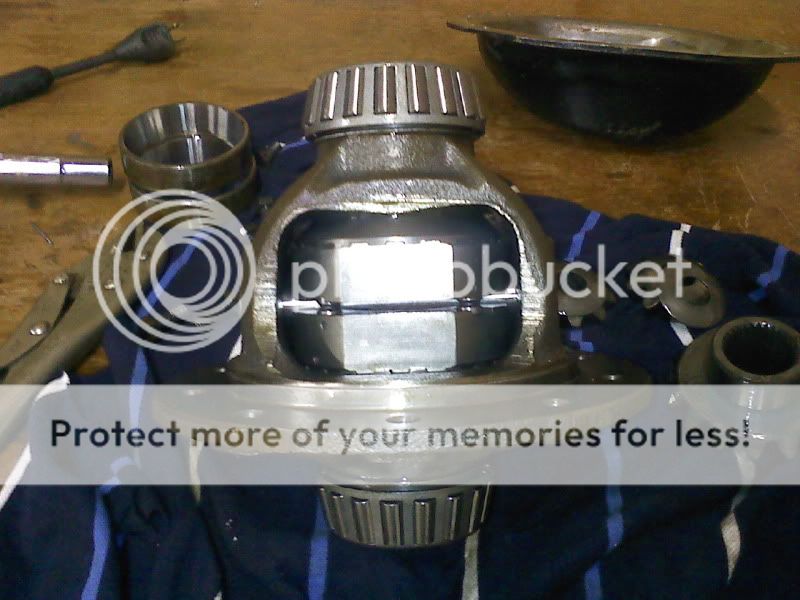

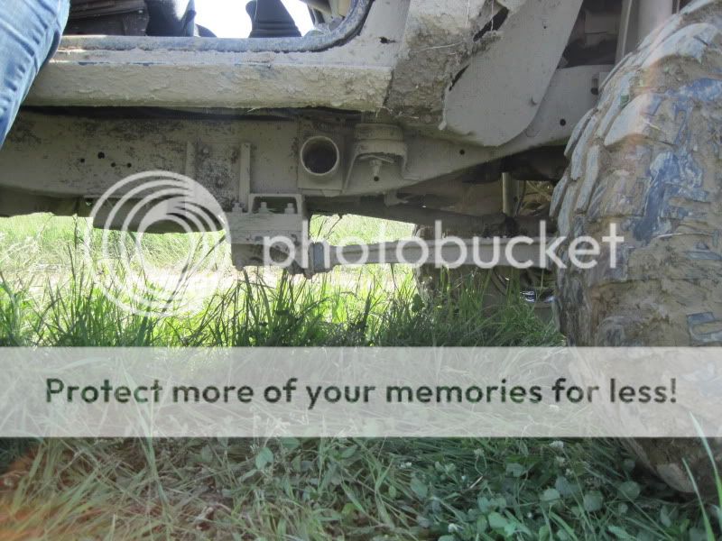

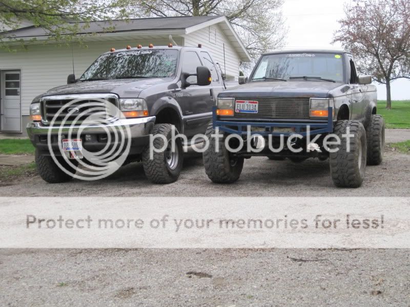

Had some 8.8 issues but i got it all back together and its rolling again. I didnt add enough oil... oops. I have a bad vibration over 62 mph. Turns out my rear DS is too short. I measured it with the cap on. When i took the cap off, the rear went up 2" extending the driveshaft a little too much. So i ditched the 2" lift blocks for 1" blocks and it drives much better now. Still some vibrations. But now i am betting its either the tires or my eye balled alignment. Some pics of it on 1" blocks next to my SD on 35s.

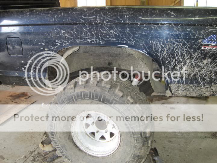

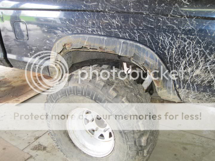

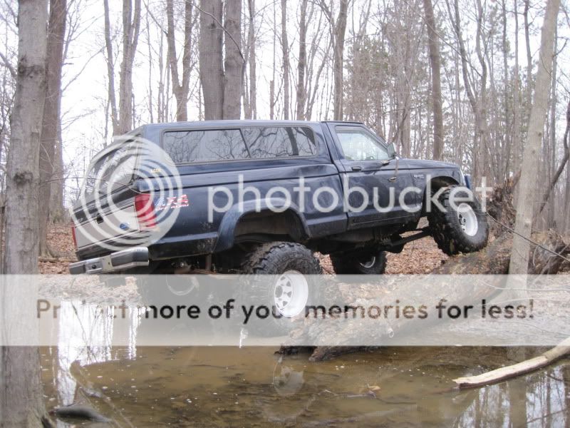

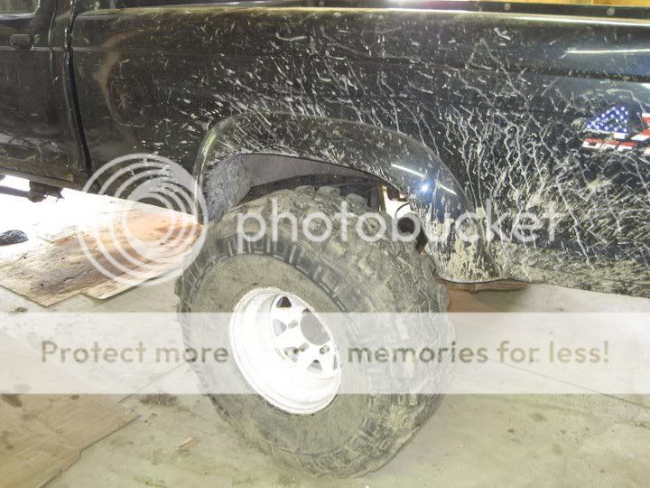

Rear Fenders Cut

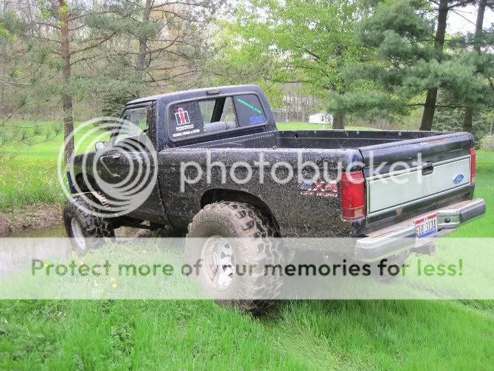

I have a lot of updates.

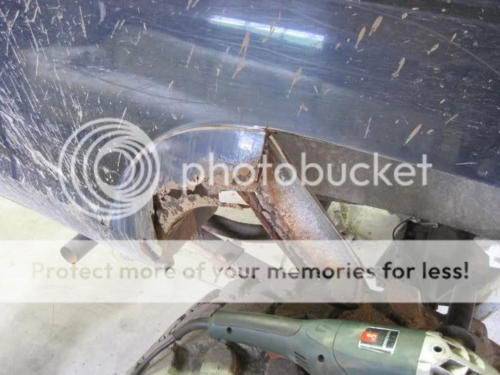

I finally got around to cutting out the rear fenders for tires clearance. It turned out better than i thought. They came out prettier than i thought i could do. But they are by far from perfect. But hey, its a wheelin' truck. Who cares.
Before
This is what happens when you live in northeast Ohio. I have seen 2007 trucks (Dodge, GM, Ford, Import, it doesnt matter) with rust on the body. It sucks.
Cutting away
Good enough for me

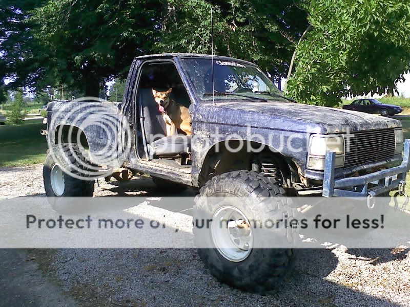

Then i went for a drive around the property

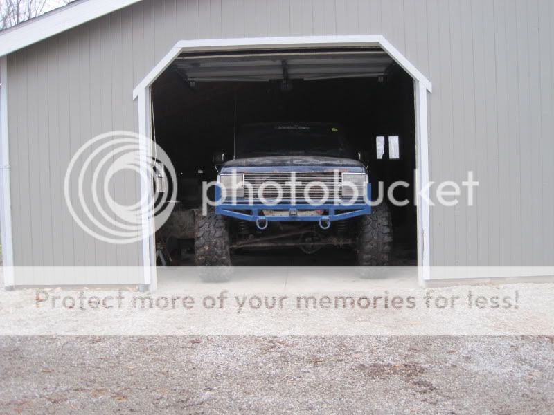

Current Stance

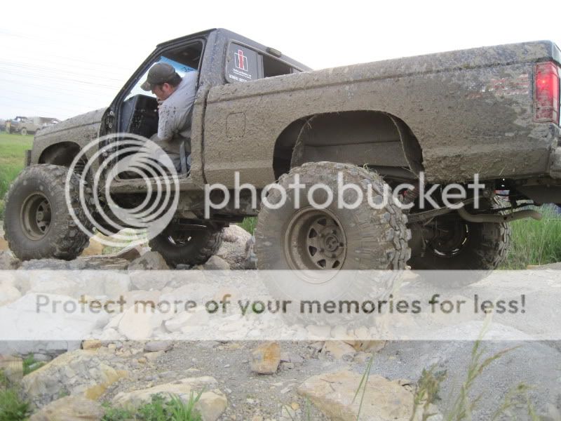

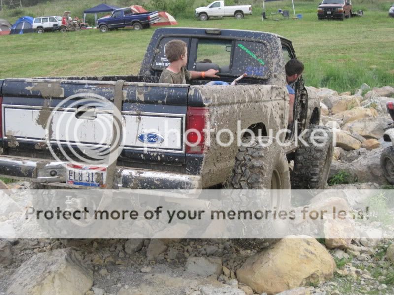

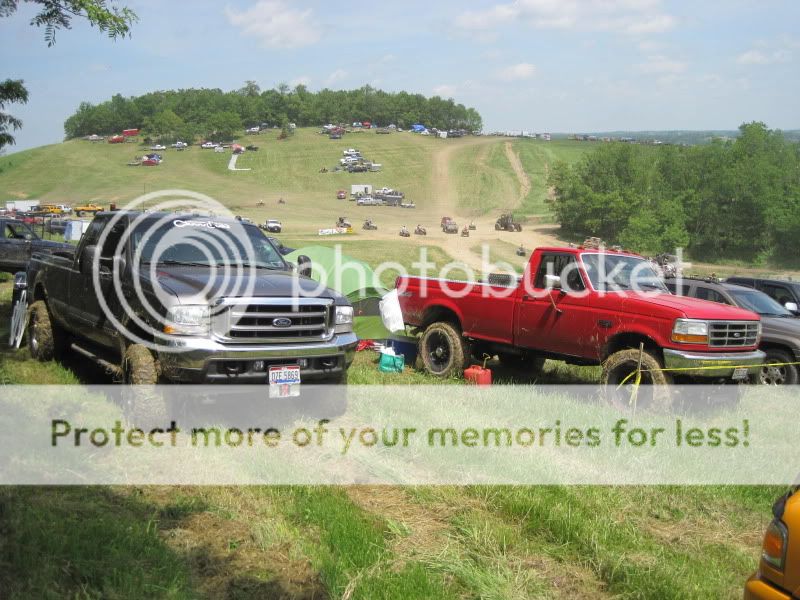

First Wheelin Trip
I also went for its first wheelin trip over the Memorial Weekend.

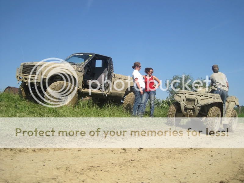

We went to Powerline Park in SE Ohio. It is mainly for mud trucks and ATVs. I didnt think it would be too fun. But i actually found alot of cool stuff to play on! I took the truck down most of the ATV trails. It made all of the ones i tried but i did get a lot of body Damage.

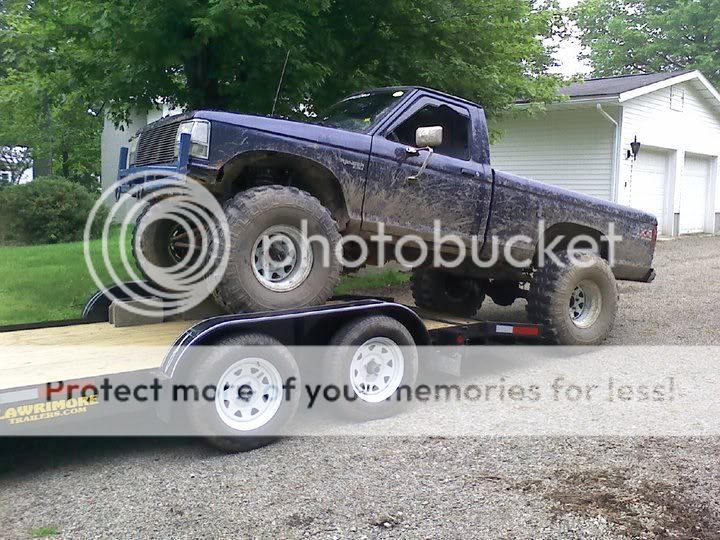

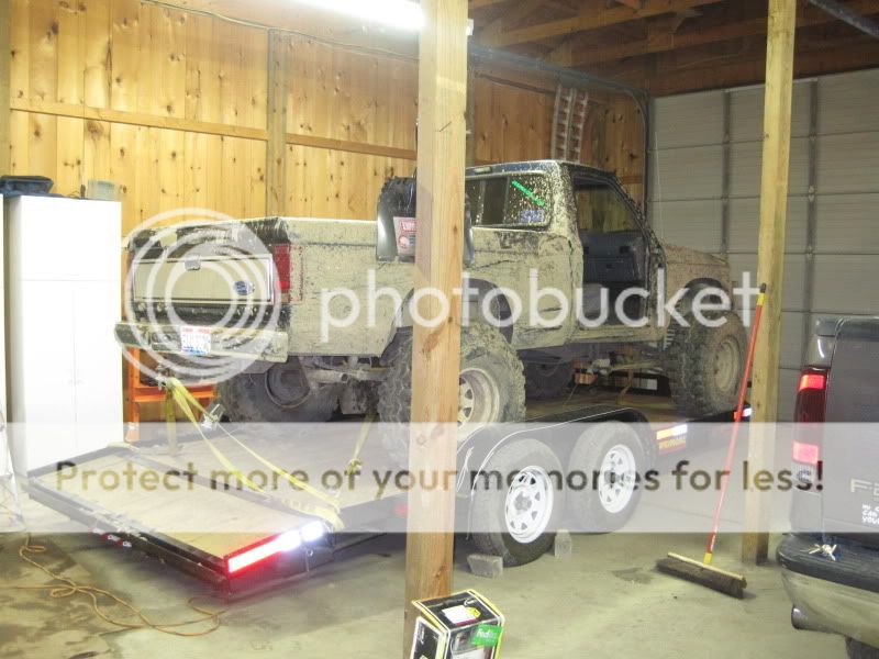

Loading up. Dont need the ramps
But i do need the blocks so i dont smash the fenders on my bran new trailer

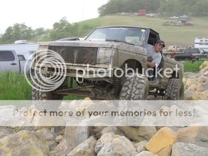

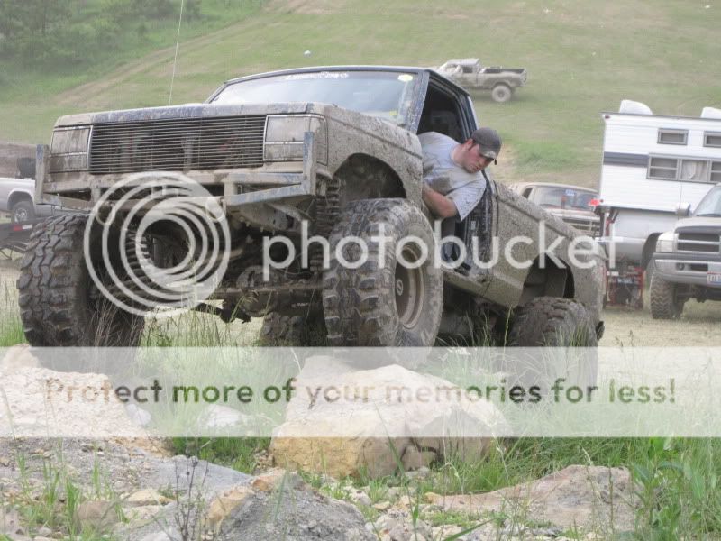

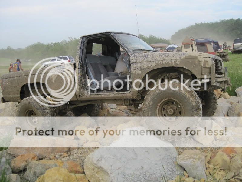

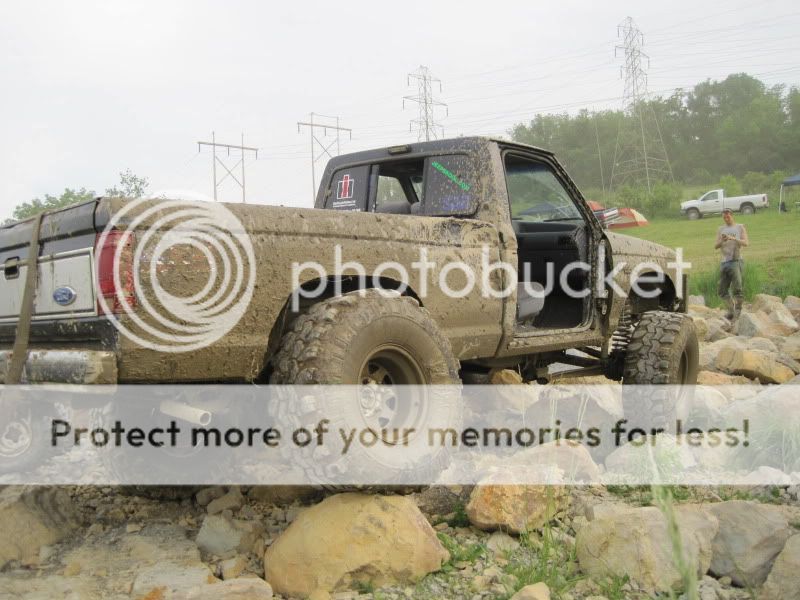

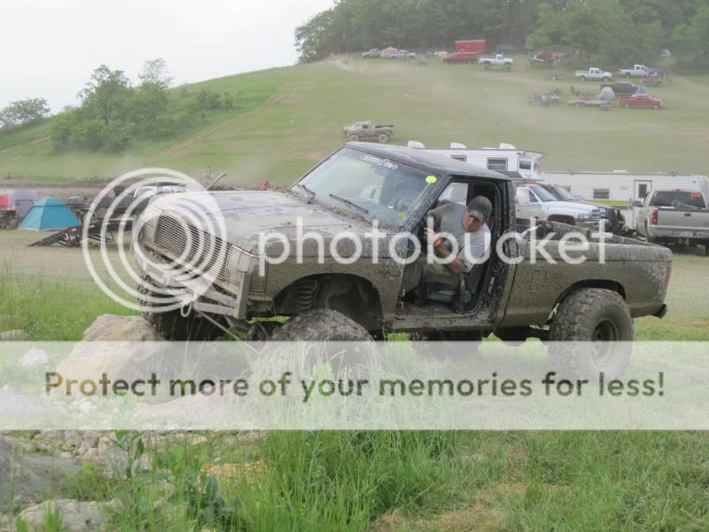

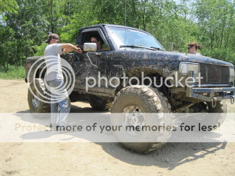

Right off the bat i got some GOOD damage! Went up a hill and there was ledge at the top that put me into a rock. Broke the window as well.
So they came off
The Wife ready to go

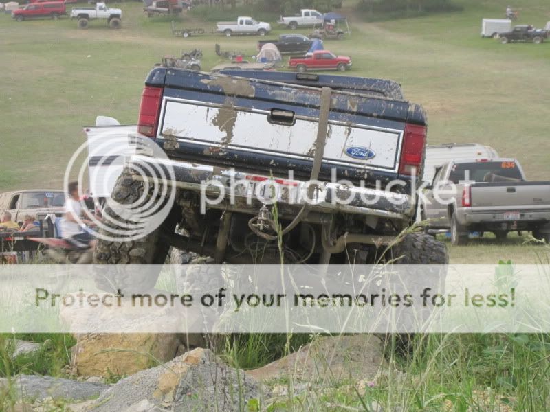

Then i found this little rock garden. It was quite fun.
Hope you dont mind a ton of pics.
Jeep This
Did it a few times

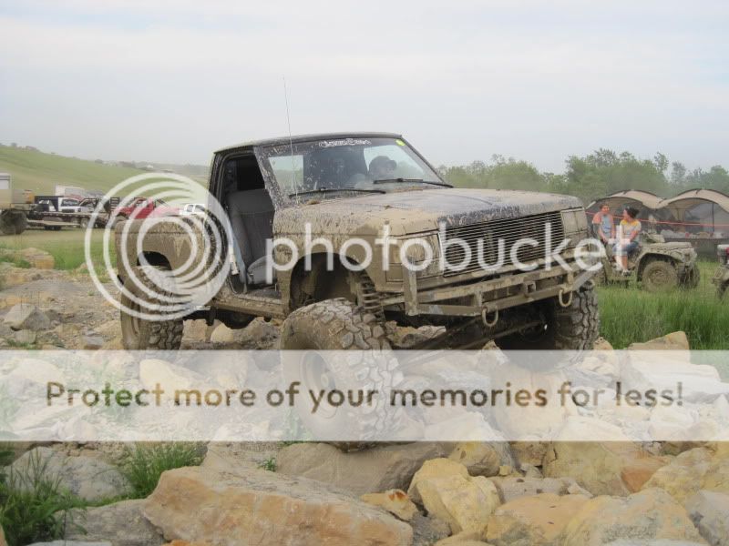

More trail pics of First wheelin trip - Powerline Park

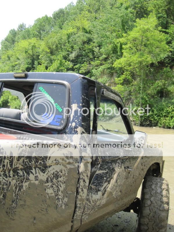

My only stuck
Then some XJ came by and got stuck too haha

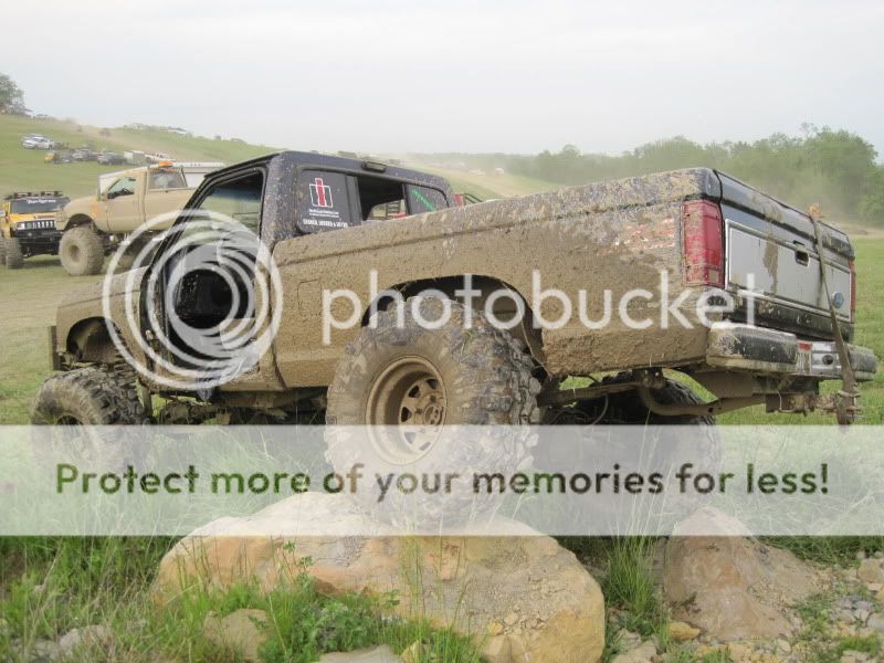

Damage Report - Other than the doors

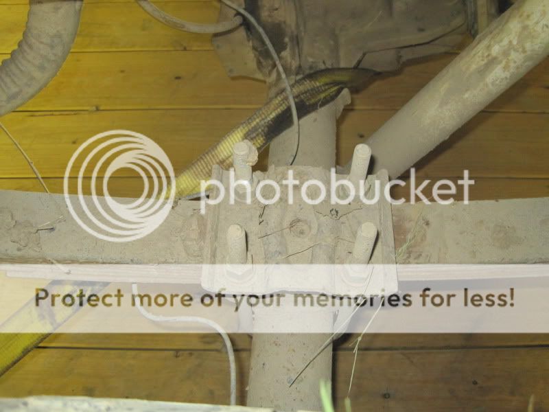

Bent an Arm and one point. Probably when i high centered

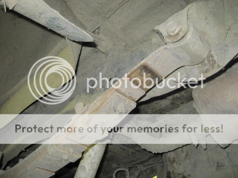

Broke one Leaf Centering pin. Hit a lit of trees with the wide axle

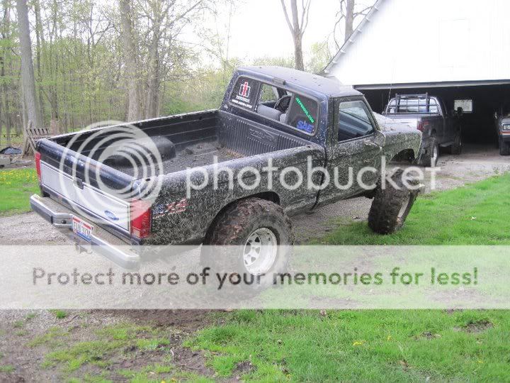

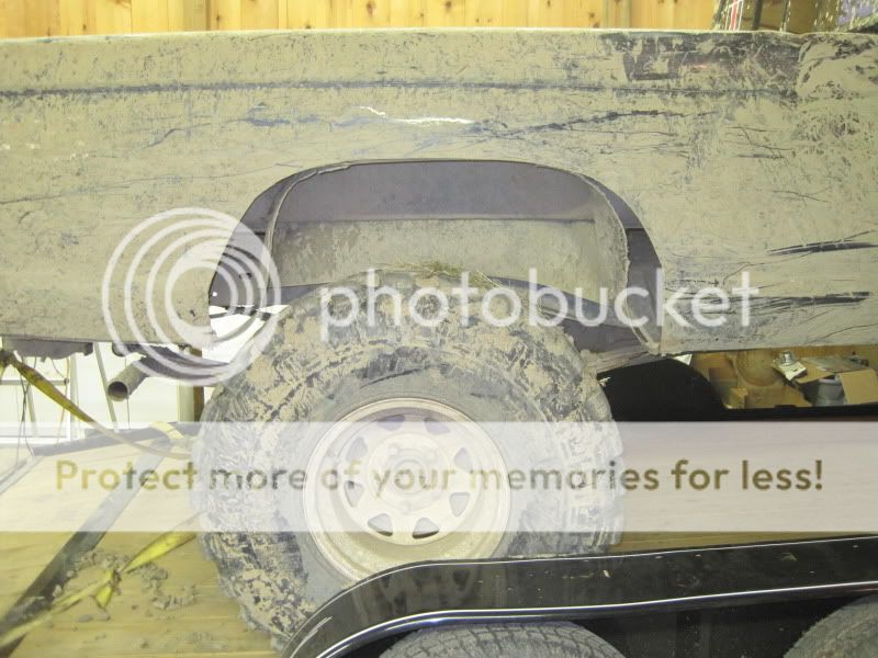

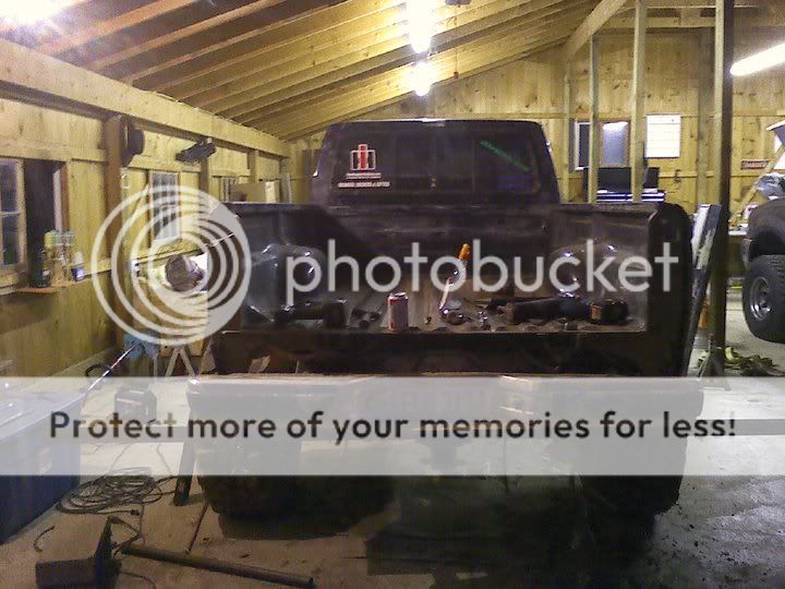

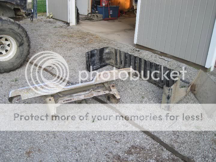

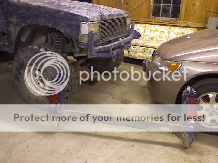

Bobbed Bed

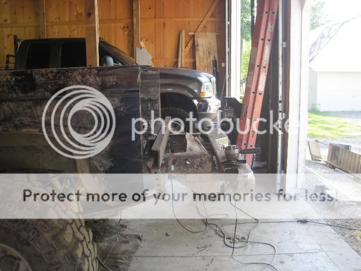

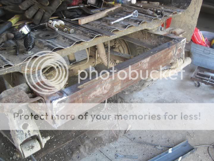

Well, i went on a wheelin trip or two and my rear bumper got hung up on all the fun obstacles. So when i got home, the back of the truck was under the knife. I cut the frame back to about 2" behind the rear shackle.
OH by the way, I wheeled with all Jeeps and the TJs were even running front radius arm set ups with rear leafs. Not 4 link front and rear. I rubbed that in haha.
Turned out much better that i expected

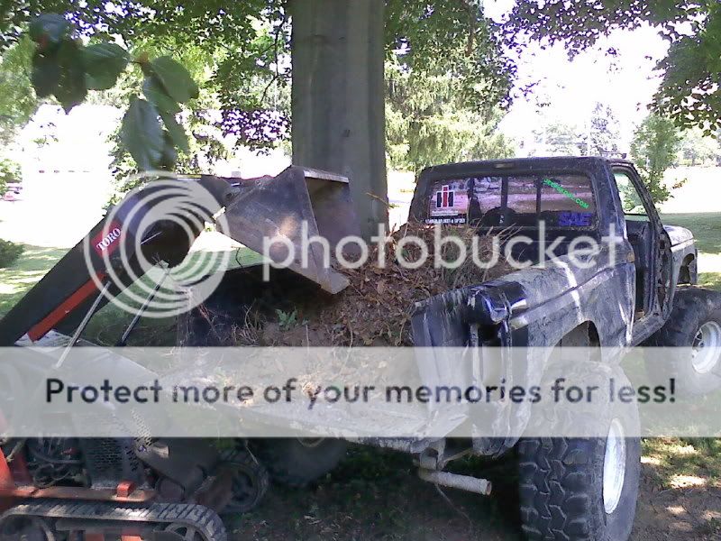

I still need to finish it. I have had a few loads in the bed and on the gate and it held.
Now for sliders and a rear bumper of some kind...
