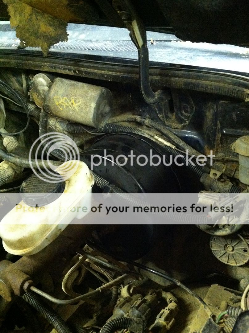

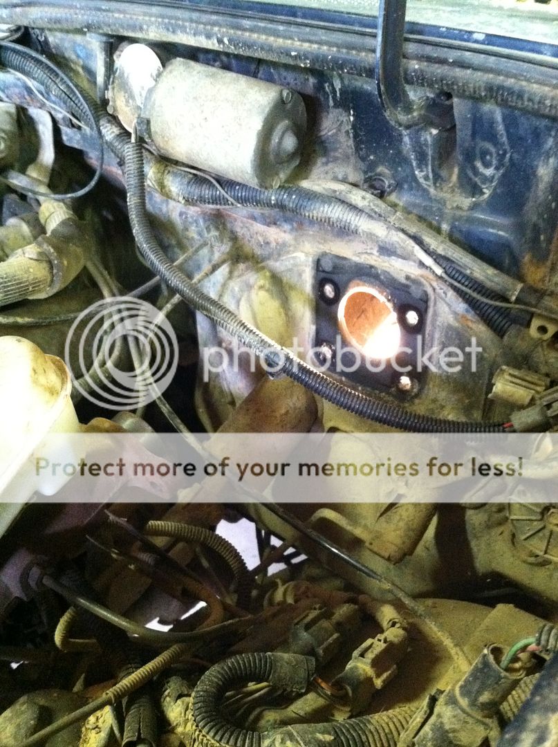

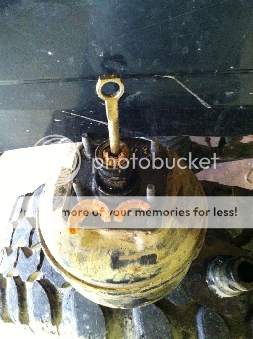

Pulled the bad booster out. Something rattles around in there lol. I got another one but the studs are a different size. So I have to buy new nuts after work.

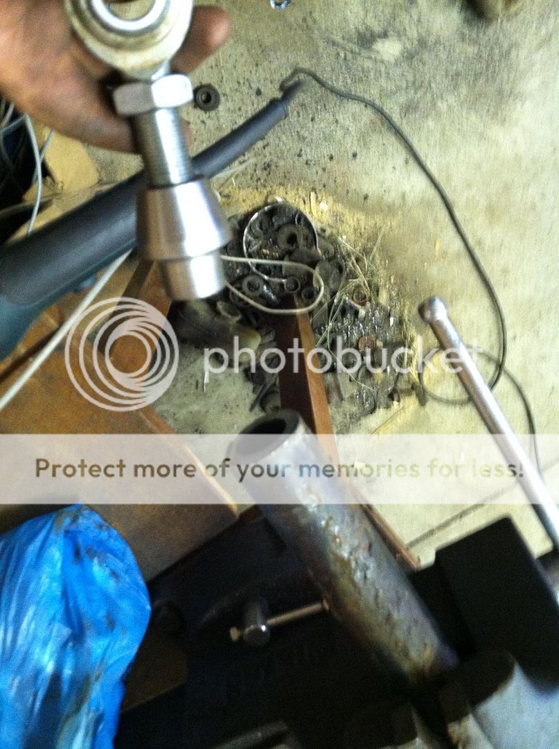

Also pulled my track bar off. One of the hiems was shot. It ended up destroying the threads in the welded bung too. So I cut that off and welded in a new bung and hiem. It is nice and tight again. Hopefully the booster fixes the stopping issue. The wife wont be home tonight so I will certainly be doing some backyard wheelin.

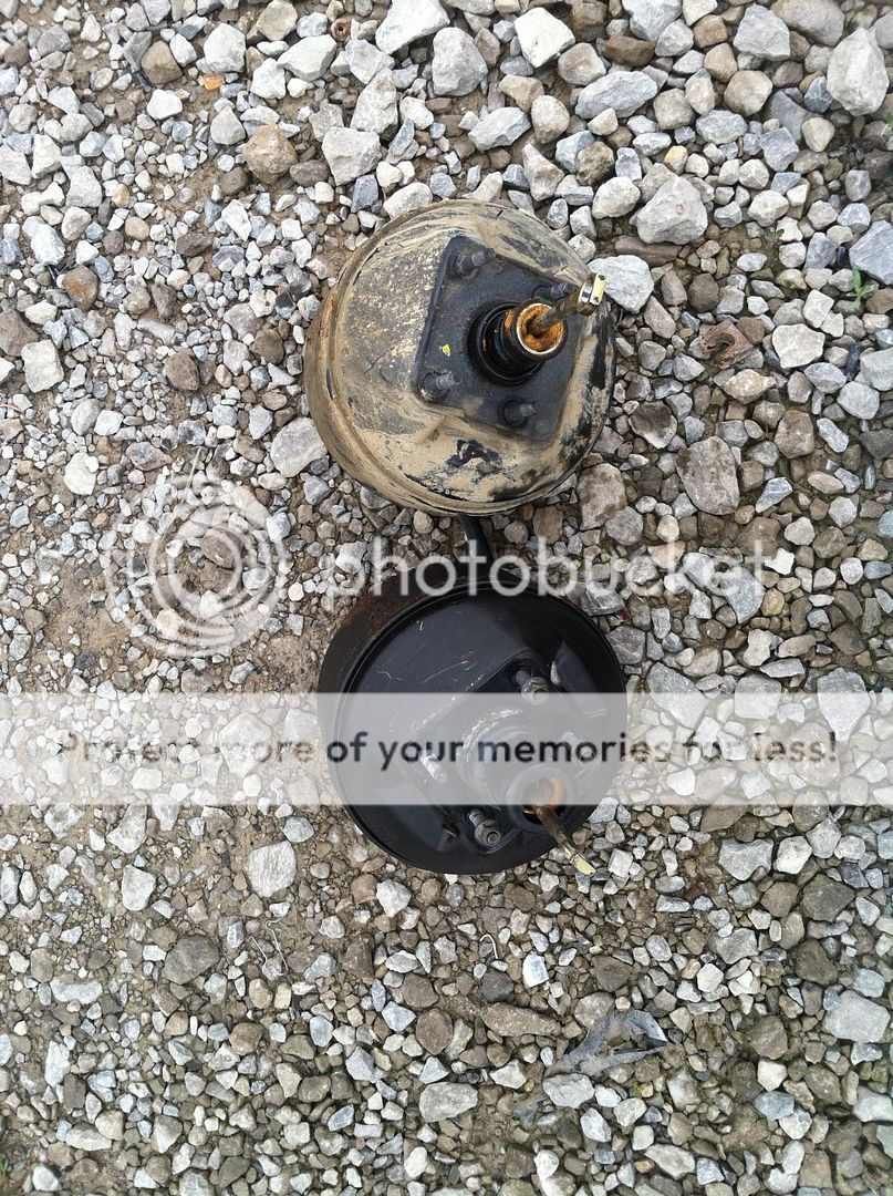

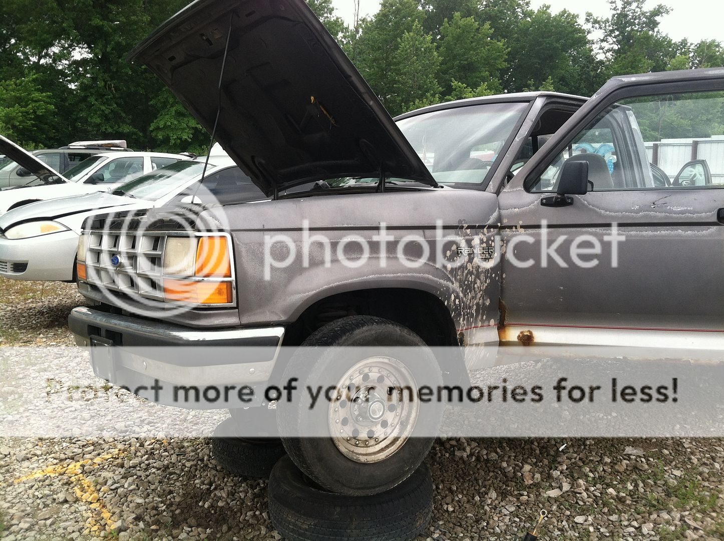

I ran to the local Pull-a-Part on lunch yesterday. Scored a like new booster off of a 91 4cyl truck. Got that installed. The brakes work better than ever. I think my booster has been going down hill for the last 3 yrs. The truck has never been easier to stop than it is now.

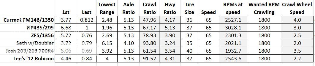

Made an excel sheet today comparing different setups. My current crawl is 47:1. It sucks lol. I would like to be in the 70-80 range next time. I am leaning towards a ZF5/BW1356 out of a Ford gaser in an Explorer... It would have a good crawl ratio and be able to roll at 70 mph with out screaming. Plus, those are easy to find out here.

I added two more columns. Wheel speed in first gear at a given rpm. I am 2 times faster than Plum and he has 4.10s.
You are definately an engineer :icon_thumby: I make spread sheets for everything :icon_rofl:
I think the ZF-5 is the way to go, but you could mate it with a NP205 (I am pretty sure) and put the 3:1 gears in it or do a 203/205 doubler. Or go with an Atlas 2 speed or 4 speed. Although they are pricey, it would be perfect! Especially the 4 speed with the 10:1 in it :icon_rofl: Put that in your spread sheet...

An atlas or similar would be awesome! But I am cheap and I prefer OEM stuff that I can get from a junk yard.
A 205 with a 3:1 ratio would be pretty cool though. Those cases are heavy, but they are strong. To be honest, I didnt even know about those aftermarket gears.
