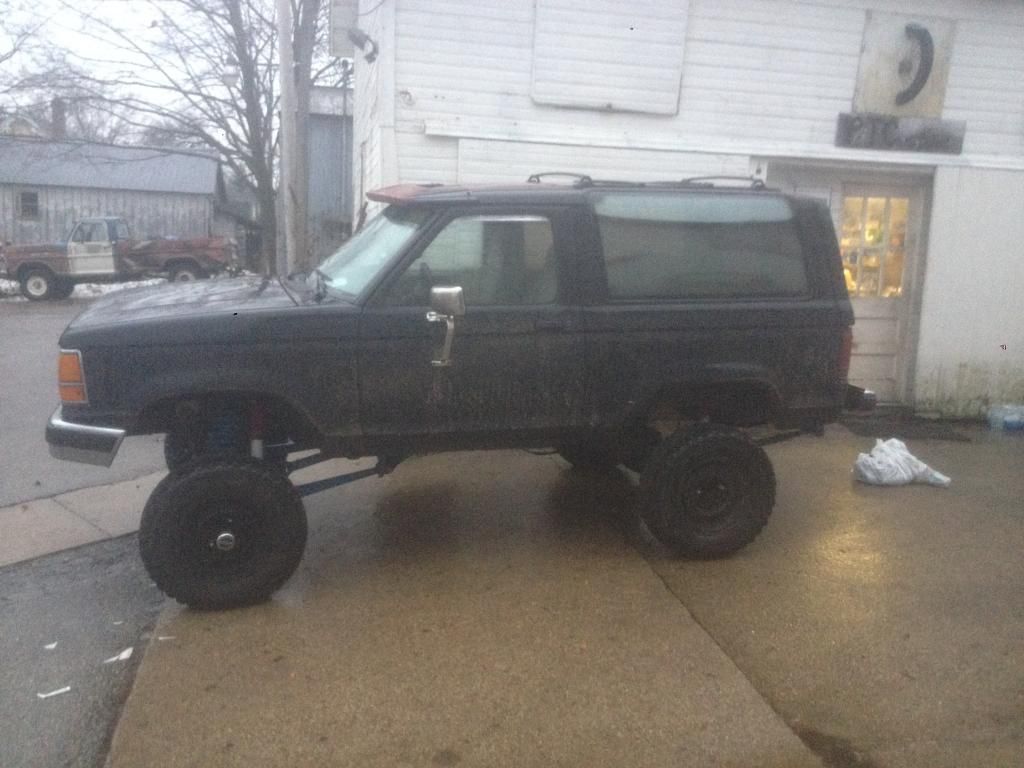

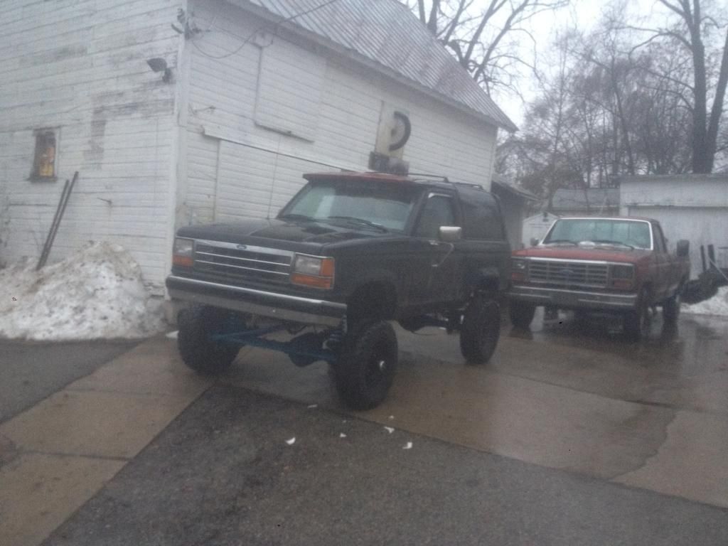

heres how she's sitting as of today..
4x4 electric shift motor is installed and working great.
beefed up and gusseted my trac bar mount on the frame, it tightened up my steering quite a bit.
idk if i said this yet but i gave her a murked out flat boat rattle can job, which isn't finished yet, still gotta paint my visor and roof.

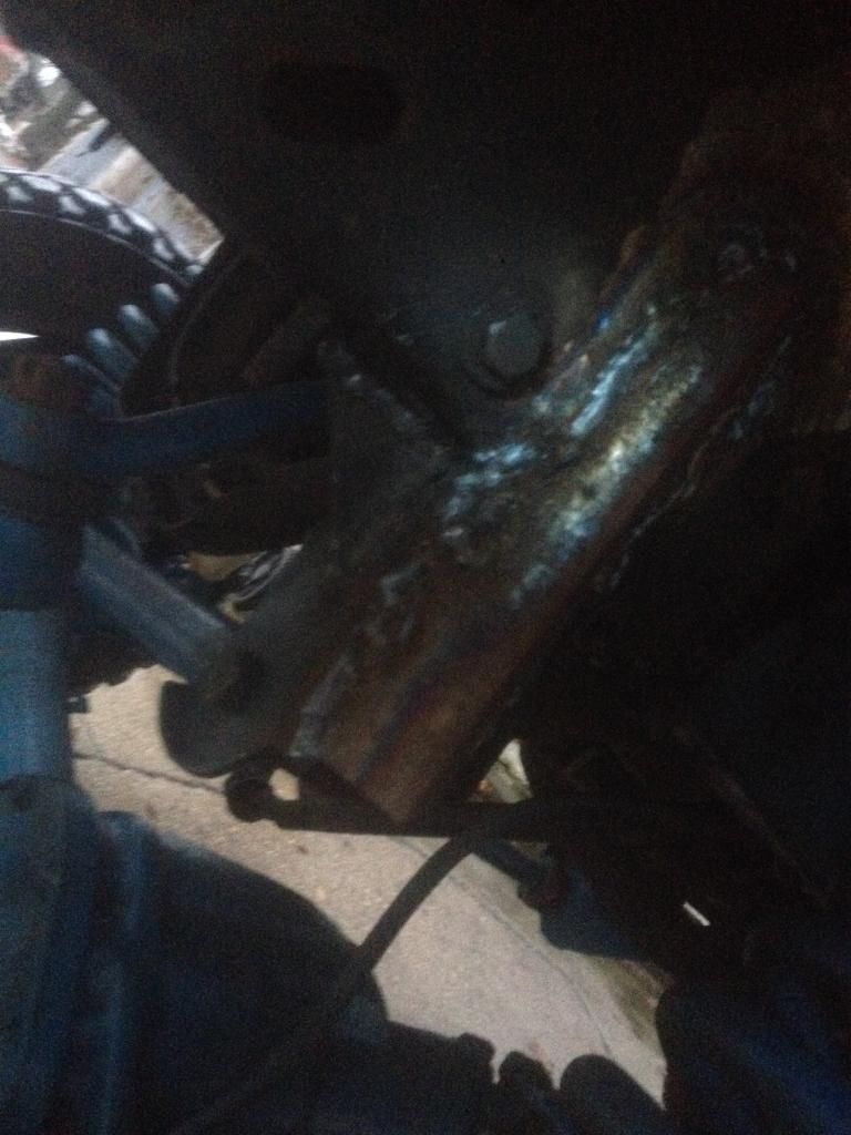

heres some pics (not the best but)
beefed up trac bar mount by welding a triangular gusset in the front between frame rail and mount, and the welded a piece of angle iron, along the frame rail and down to the mount.
don't mind my chicken shit welds, it was raining and i was in a damn hurry, trying not to get a wet ass.

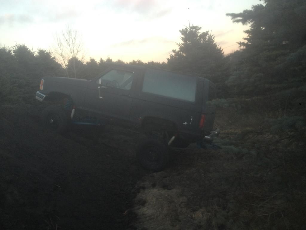

Its nice to finally have a truck that runs good and its nice when i can take a few minutes off at work to play.
trying to upload photos of me playing on some Clay piles but photobuket is not cooperating right now
