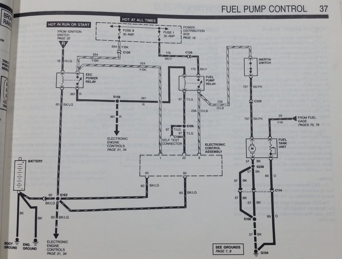

Code 95 means the ECM is not sensing voltage on the load side of the fuel pump relay.
Here's the diagram for bypassing the fuel pump relay.
Fuel pump won’t prime
The wire coming off the relay to pin 8 of the ECM is the wire that tells the ECM there is no fuel pump secondary voltage (load side of the fuel pump relay).

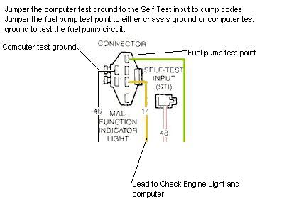

so if I ground the FP test point I should hear the pump kick on?

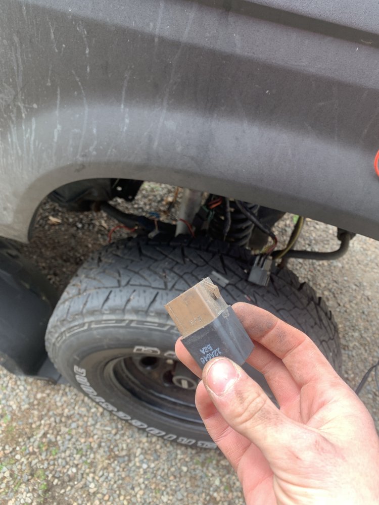

I went thought the diagram Paulos posted and I had voltage where I should except the EEC relay. It was so crusty I figured my multimeter wasn't making contact so I ignored it. I had a spare FP relay that I replaced the busted EEC relay with and it works, as far as I can tell using a FP relay shouldn't hurt anything. Inertia switch, fuses, everything was fine and of course, it was the easiest and simplest thing that I overlooked.
Nah the ECM and fuel pump relays interchange. Glad you figured it out!
