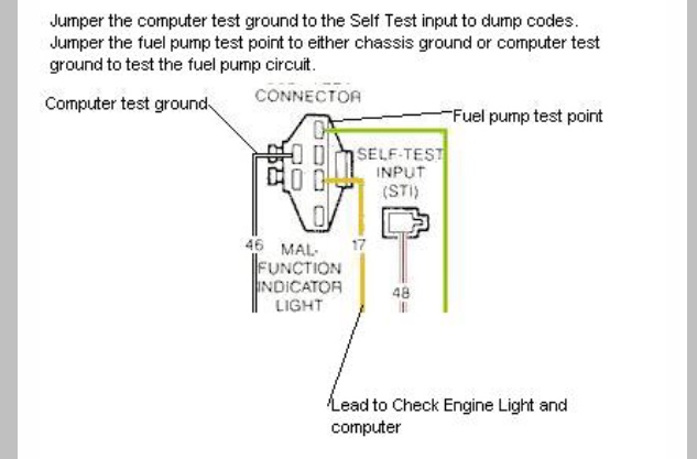

The only special tool you need is a piece of wire. The EEC port is a test port for the electronic engine control. Take a piece of wire and strip 1/2” off the ends. The diagram I sent points out the connections on the EEC test port. The second sentence states how to jumper for fuel pump test. Put one end of wire in computer test ground and the other end in the fuel pump test port. The tech library has all the wire diagrams
Look under 83 thru 91 engine controls sub section 2.9 electronic engine controls 1 of 3. Fuel delivery will be there.
