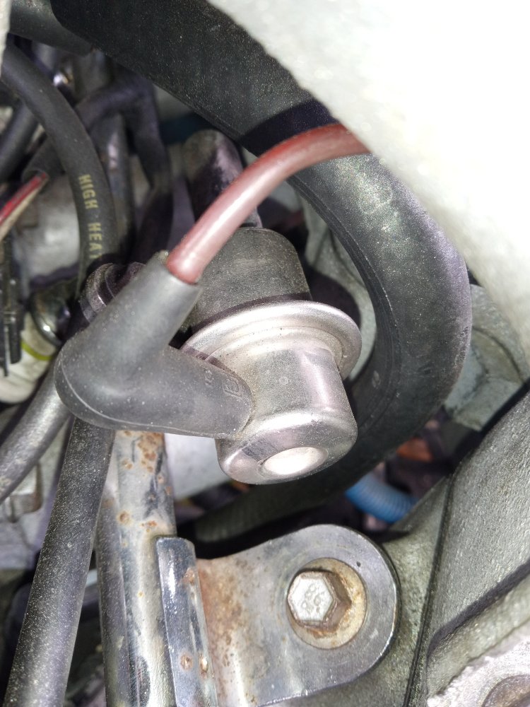

Then what is this part call that's on the fuel rail it's got a vacuum line going to the intake plenum and a single hose going to it on the backside that come to it from the fuel filter on the frame rail on the driver side
  • Fuel pressure regulator
That's the Pulse Damper
When the FPR and its rubber diaphragm were removed from the engine end of the fuel rail, pulse waves from injectors opening and closing had nothing to absorb the waves so they could build up, so when an injector opened it could have higher or lower pressure as a pressure waved passed by, so more fuel added or less fuel added, so not good
The Pulse Damper is just a rubber diaphragm that absorbs pressure waves
The Vacuum hose is a safety feature in case diaphragm leaked fuel, leaked fuel would be sucked into the engine causing rich running which would set trouble codes
Which is much better than an engine fire, lol

When I replaced the fuel pump it was just the pump, the fuel pressure regulator is a part of the assembly, so couldn't that mean that it is still bad? Also looking up online I have read that the pulse damper COULD cause about 99% of my issues, if it were bad,
Pulse Damper just a rubber diaphragm so would leak if it was bad
