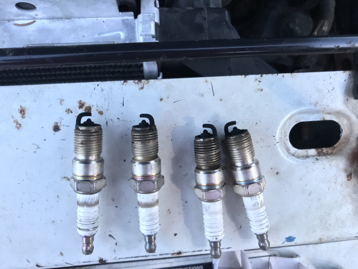

I changed everything and I’m still getting 173 O2 System Indicates Rich. Before changing ECU I got 179 At Lean Adaptive Limit During Part Throttle, so I guess that’s an improvement. I have no fuel in regulator vac hose (new) and was hoping the new O2 sensor was bad since it was running in such a rich condition for so long. I replaced it with the OEM NTK sensor. I get same code, but it comes in sooner now and stays on much longer. I figured I needed new (again) plug wires since the ones I put on were all far too long. I attached photo of old plugs. I went ahead and replaced them too (only on right side so far).
I still get the 173 code so now I’m racking my brain as to what is wrong. Are there different injectors? I assumed that rockauto would only give proper options. Are these injectors incorrect for this engine? Ultra Power MFI690
Surprised no one has chimed in to offer help yet. Those plugs are pig rich. Since you have a scanner...throw it on there and get real time data on your MAF at idle. It should read in the low 2.x g/s. There's a general rule of thumb that at idle, grams per second of air across the MAF should be equal to your engines liters or thereabouts. Example, my 2.5L 1999 reads 2.7 g/s at idle with a K&N filter. If you have a high reading in the 7's for example, it could be tricking the ECM into believing there's a huge amount of air coming into the intake and it's dumping huge amounts of fuel to meet that air demand. You'd also suffer from horrible fuel mileage as a result. Check you SHRTFT and LTFT and post those results as well and I can offer some guidance where you could begin to troubleshoot next.
