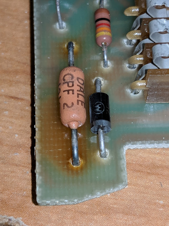

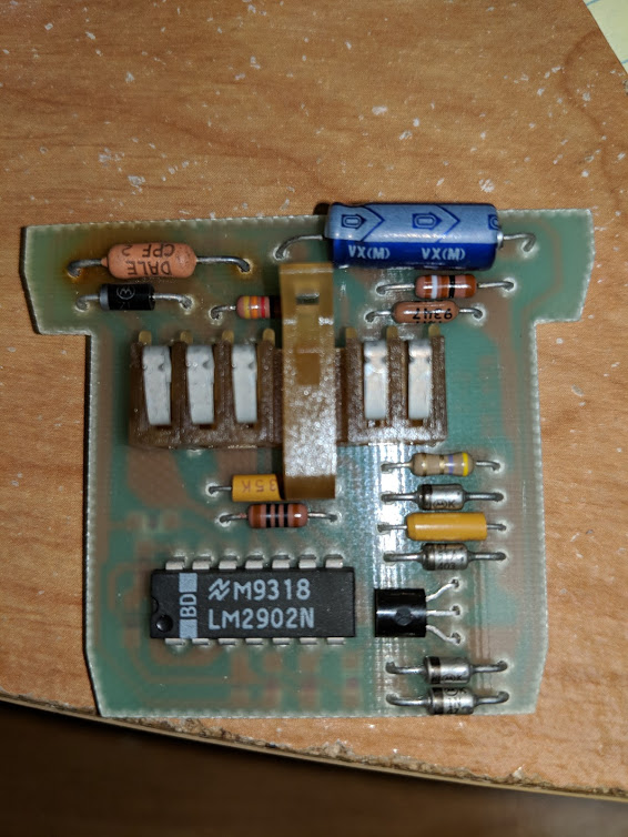

Got the slosh circuit out. Looks like this. How do I test it/repair it?
